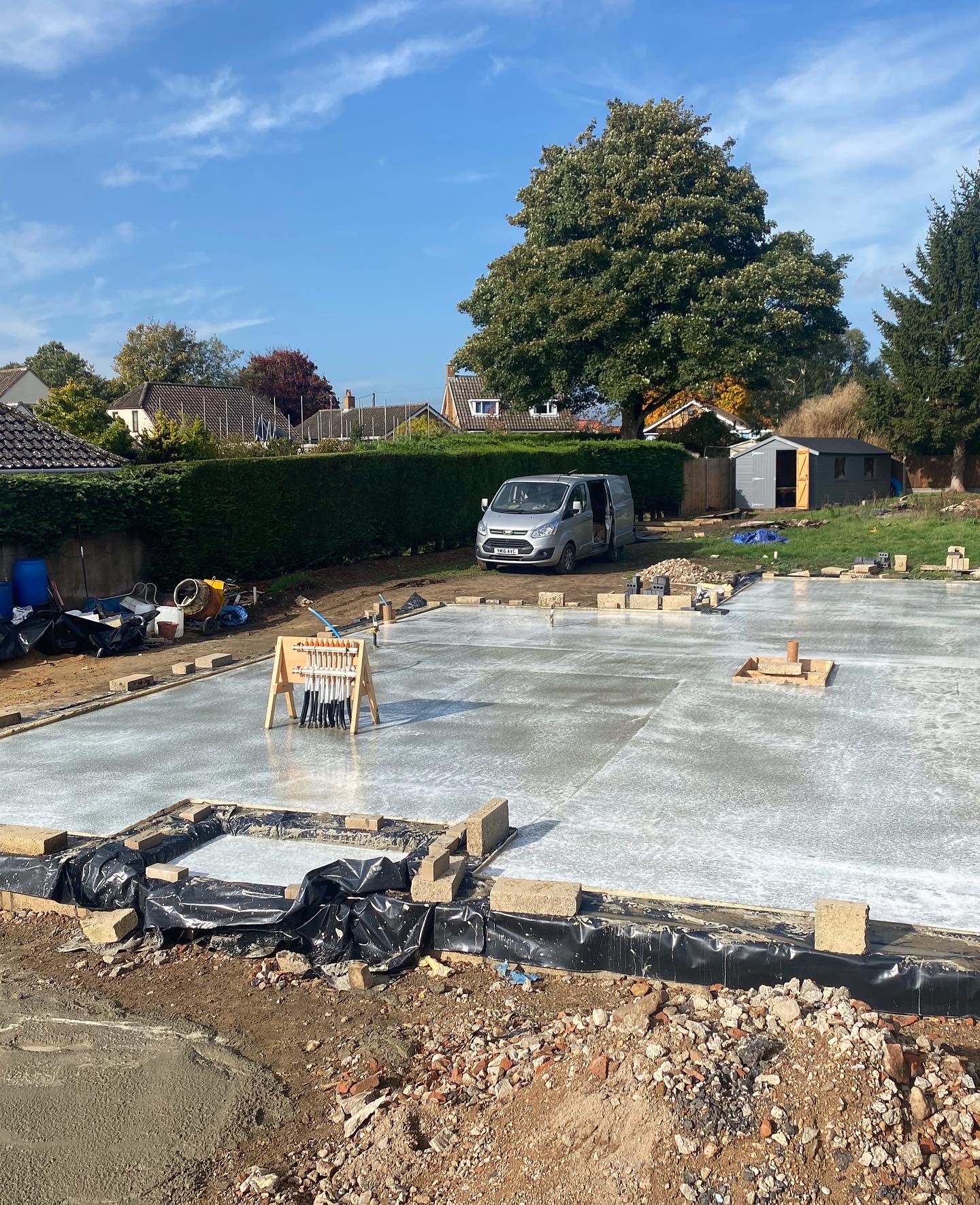

saveasteading Posted December 19, 2022 Posted December 19, 2022 Apologies for the confusion. I don't write this stuff with the care I would if doing it professionaly. If your ground is really bad there may be a need for the industrial loading slab you show below the pir. It can carry forklifts. But think of the load on your floor ....feet and furniture. This then sits on pir with very low strength. Therefore you don't need even more strength beneath that. All you need is a flat, clean surface for the pir. In theory that could be just sand blinding, but in practice that is difficult. So my suggestion for you is 75 or 100 stone, then 25 max blinding, then 100 concrete with fibres, then pir then screed. Plus dpm twice. The concrete could be thinner but is trickier to lay accurately....go for 75 if you want. But this has to go past your professionals. I don't know your project circumstances. If they say no, please ask why. Remind them of the cost...it is a good idea to have worked that out to tell them. The readymix company rep may not be used to fibres, but they are standard and from Sika. They simply pour them into the wagon from a premeasured bag 1/m3.
Fallingditch Posted December 19, 2022 Posted December 19, 2022 I might have confused matters further here ... Back on April 30th, I thought you were agreeing with @Chanmenies post namely "put the slab on top of the insulation". Then you later described your floor makeup, which was concrete slab below insulation. My point was "did you have a strong reason for putting your slab below the insulation when you did your floor?". (I think some people do it one way - others the other way. Completely take on board your suggestion to use 100 concrete with fibres, And your suggestion to estimate costs and use that to support the revised proposal is also a very good one. If this were simply my decision, i woouldn't have a problem - but I will have to convince my SE of the merit of using a thinner slab, and possibly even pouring the slab on top of the insulation).
saveasteading Posted December 19, 2022 Posted December 19, 2022 Yes if the stone could be laid level, that should really mean that you don't need the lower concrete. After all, commercial sheds don't need insulation so there is one slab, straght onto dpm on stone. It is really down to conditions and expectations. Doing away with the slab would have been an argument too far with our SE...we settled for this as there were bigger arguments on other stuff. We saved about £15k but it could have been more. If we hadnt been professionals ourselves i dont know if we could have prevailed. In reality, the bottom slab gives control and cleanliness and it is easier to get the pir tidy. Did you say earlier that there is existing slab? Can it stay?
