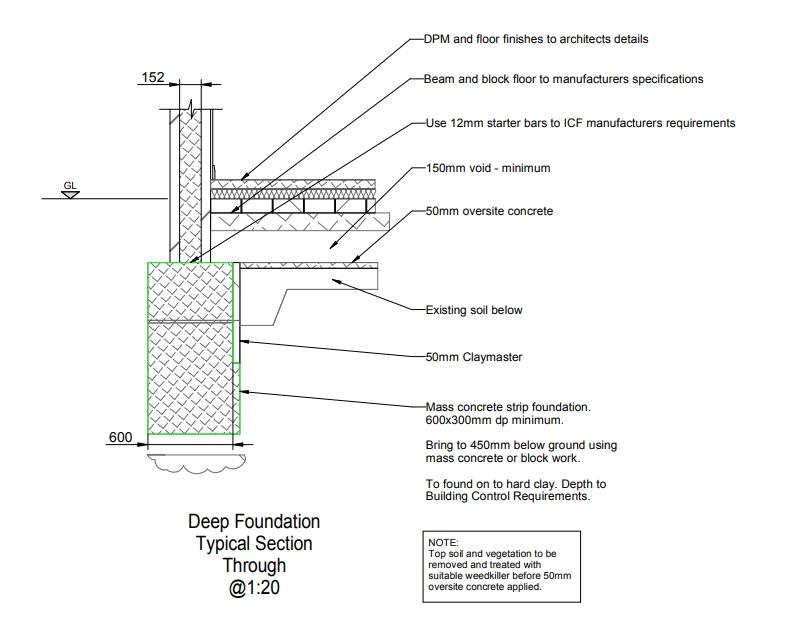

Mulberry View Posted April 24, 2022 Posted April 24, 2022 We've just received our Tech/Structural Pack and are trying to get our heads around it. We have a 600x300 Strip Foundation, 50mm Oversite Concrete, 150mm Void, then Beam & Block. I can't easily see how the B&B interacts with the Nudura and at what point the B&B is installed in relation to the blocks/wall concrete?
Mulberry View Posted April 24, 2022 Author Posted April 24, 2022 2 minutes ago, nod said: 150 void doesn’t sound much It does say 'minimum', the Architect seems to ask for 225mm, is this more 'normal'?

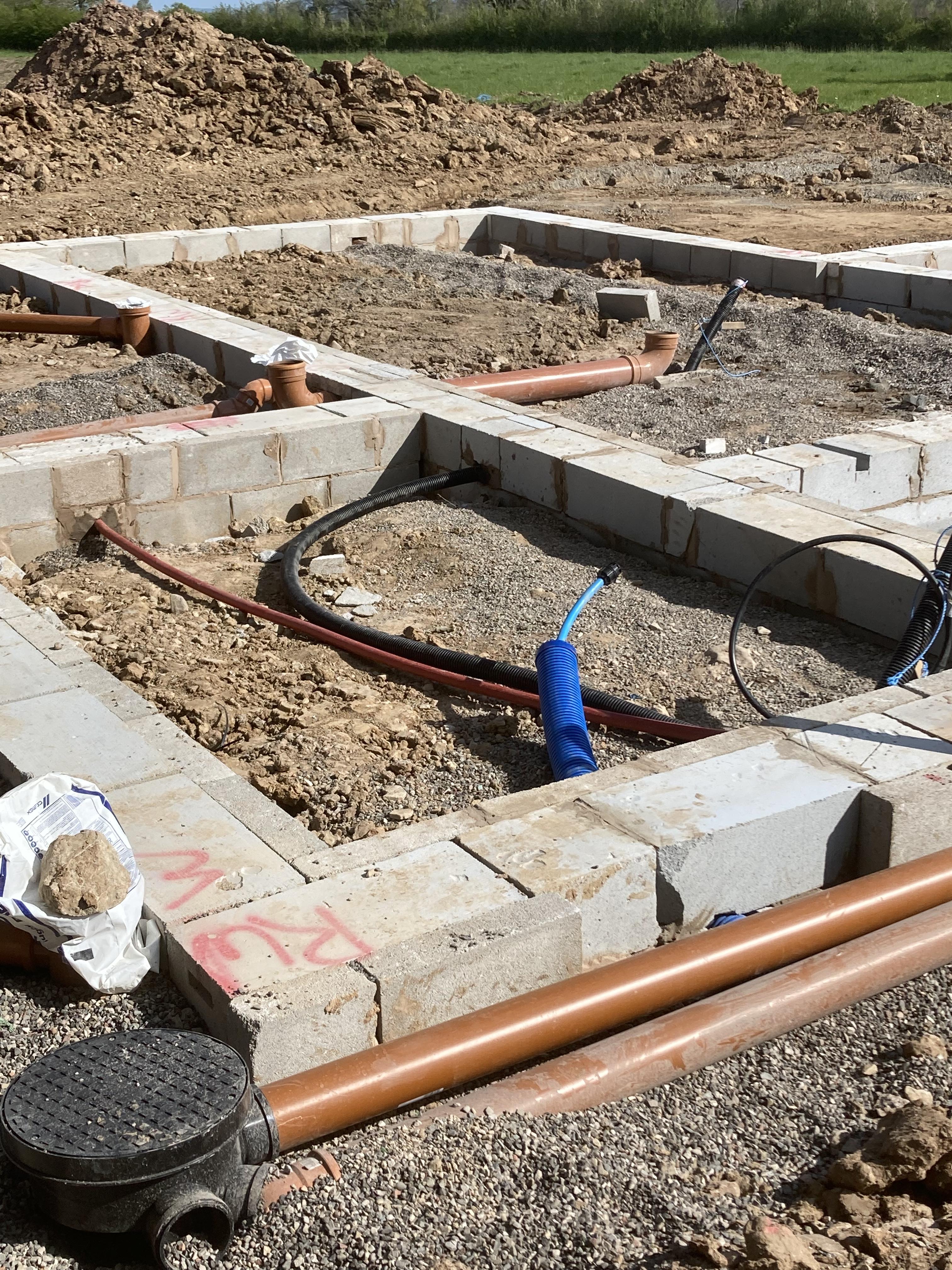

nod Posted April 24, 2022 Posted April 24, 2022 I’ve just finished the foundations BC asked for 300 mil void I wouldn’t have got my internal drains in with anything less 1

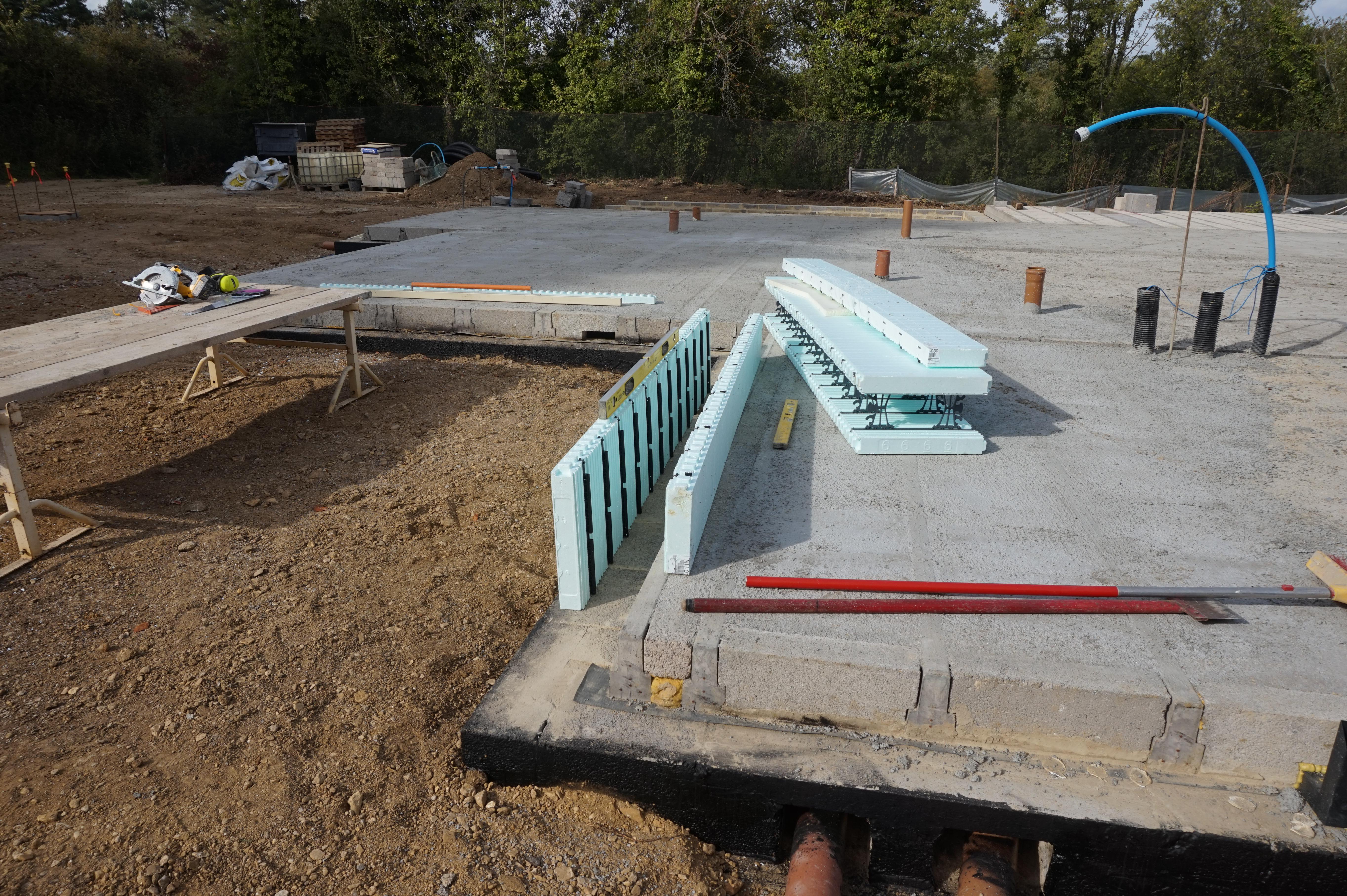

Russell griffiths Posted April 24, 2022 Posted April 24, 2022 Regarding your comment about needing a concrete pump, there has been talk on here where people thought you could pour the concrete with a couple of people with buckets. so it pays to check, there are a few loonies about. the pic is how I did mine, I know another lad who did the same, a lot of work but you end up with the ends of the beams locked into the walls.

FM2015 Posted April 25, 2022 Posted April 25, 2022 11 hours ago, Russell griffiths said: Regarding your comment about needing a concrete pump, there has been talk on here where people thought you could pour the concrete with a couple of people with buckets. so it pays to check, there are a few loonies about. the pic is how I did mine, I know another lad who did the same, a lot of work but you end up with the ends of the beams locked into the walls. You using v clips on that? Often find that concrete will hit the edge of the beam and splash outwards. The extra pressure increasing the chance of a first course blow out.

Mulberry View Posted April 25, 2022 Author Posted April 25, 2022 @Russell griffithsWhat were your beam spans like? I gather 5m spans are at the limit? Our longest span appears to be 3.7m, so perhaps the Architect has already accounted for the known problems. I do find it strange that the Architect, who is highly Eco-minded, hasn't mentioned the EPS route though.
