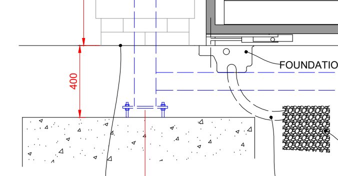

Dan F Posted April 22, 2022 Share Posted April 22, 2022 (edited) We've ordered some automated gates, and the drawings show concrete pads 400mm BGL which the gate post steelwork then screws down into. Is there a rule of thumb as to the size these pads should be and/or if they should incorporate any rebar or mesh? The gate supplier doesn't specify any of this, and groundwokers has just suggested 600mm deep 1x1m pads with no steel or even mesh. Do I need a strucutral design for these, or are there some general rules which can be followed? Thanks! Edited April 22, 2022 by Dan F Link to comment Share on other sites More sharing options...

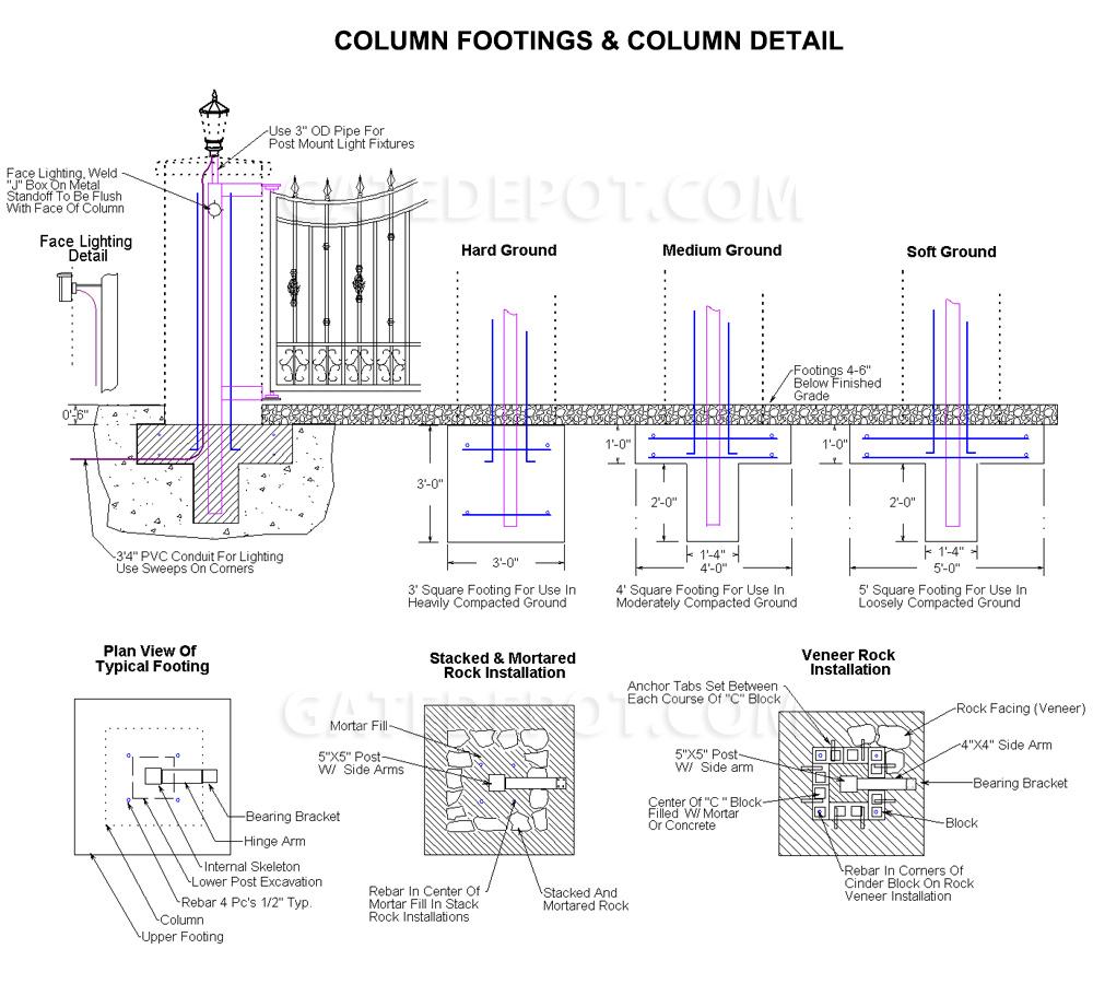

Temp Posted April 22, 2022 Share Posted April 22, 2022 My neighbour had some fantastic hinged iron gates on 8ft brick pillar constructed last year. They lasted a month before he had to get the builders back to fix them. That involved taking down the brick pillars and rebuilding them stronger. important to get it design right. Are your gates going to be sliding or hinged? Found.. https://community.screwfix.com/threads/iron-gate-footings.211575/ Link to comment Share on other sites More sharing options...

Mr Punter Posted April 22, 2022 Share Posted April 22, 2022 From the drawing, the pad looks about 1200 x 1200. The goal post design will do a lot of the work. The gate type, size, weight, soil type etc will all impact what is needed. Can you get the supplier to give you more of a steer? Link to comment Share on other sites More sharing options...
Dan F Posted April 22, 2022 Author Share Posted April 22, 2022 8 hours ago, Temp said: Are your gates going to be sliding or hinged? Gates are hinged. Posts use a goalpost design with steelwork (which also acts as a conduit) between the two posts. Posts are fixed to the top of the pad. 4 hours ago, Mr Punter said: the gate type, size, weight, soil type etc will all impact what is needed. Can you get the supplier to give you more of a steer? The gates are 1.8m x 1.8m each and made from 50x50 SHS with Iroko infill. Ground is good. I guess they should be able to answer some questions on weight at least, if not loads too. I'll try to ask them 8 hours ago, Temp said: https://community.screwfix.com/threads/iron-gate-footings.211575/ 3ft square and 3ft deep is even bigger than groundworker suggested! Link to comment Share on other sites More sharing options...
Dan F Posted April 25, 2022 Author Share Posted April 25, 2022 All I got from gate supplier is that gates are approx 150kg each. Link to comment Share on other sites More sharing options...
