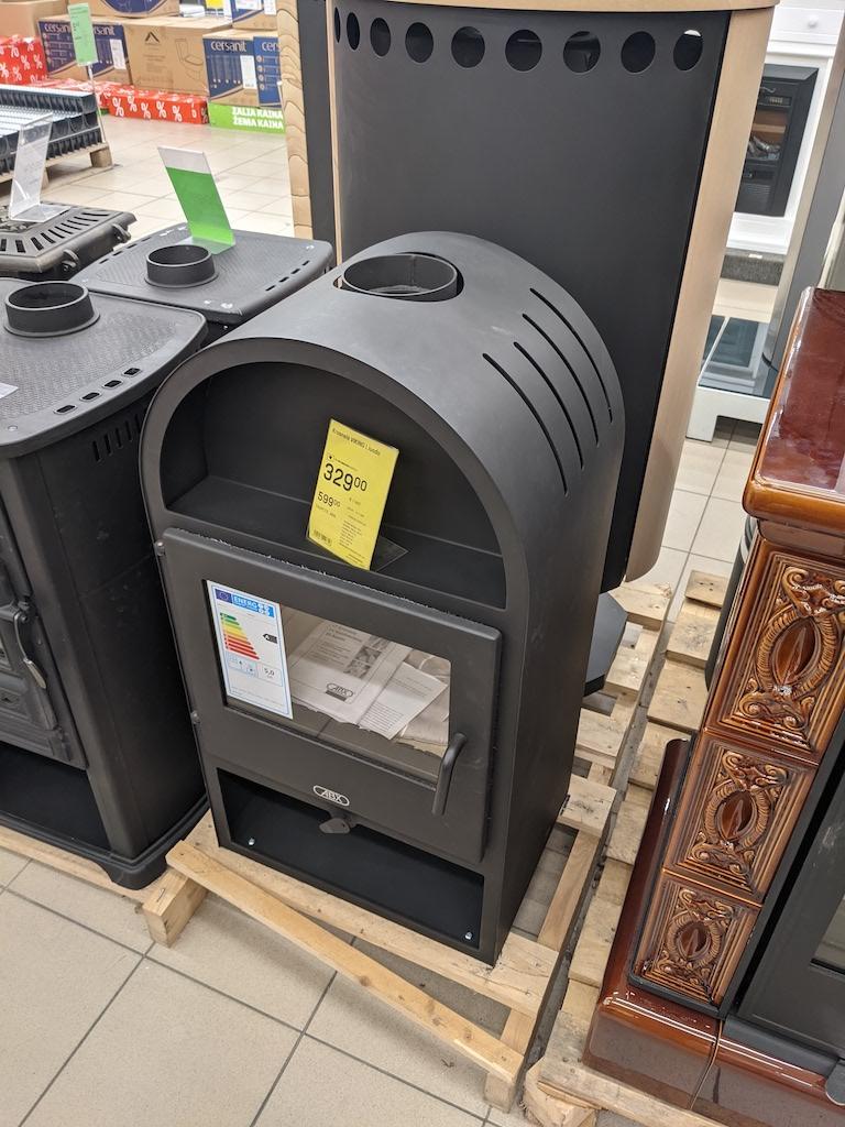

The previous plan to go out through the wall and run the flue up the gable has been rejected by she who must be obeyed on visual grounds. "OMG that's enormous and fugly"
Stove
5 kW
500 mm wide / 950 mm tall
130 mm flue outlet on the top (or out the back)
100 mm external air feed from the back

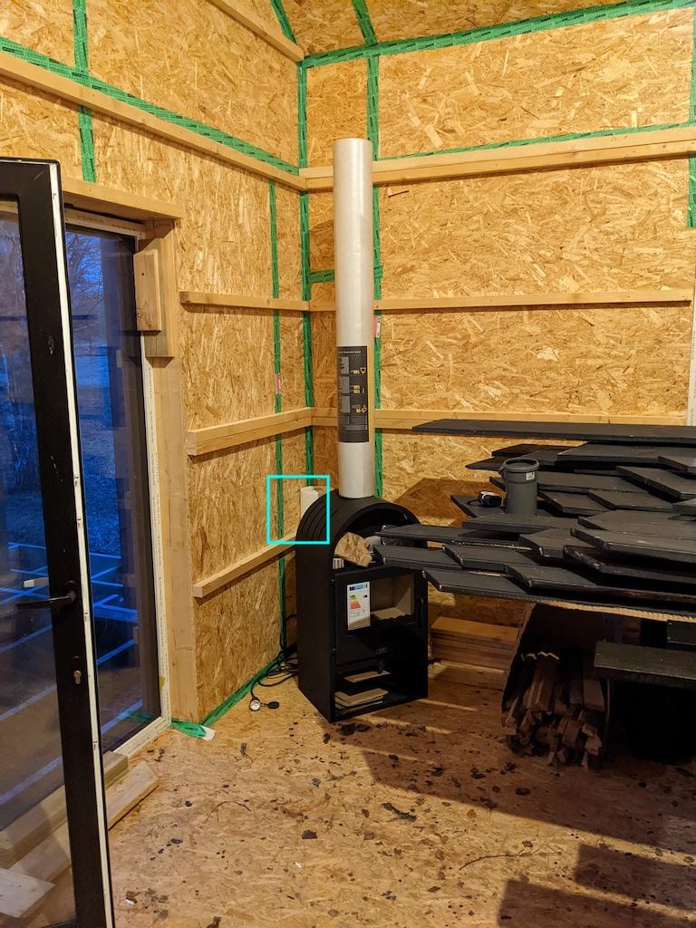

Install location
It's going in the corner at a 45 degree angle. It's a convector type so it only needs 200 mm clearance to combustibles. This puts the flue centreline - if mounted directly on top of the stove that's hiding under a jacket in the corner - about 600 mm from the wall (marked with red/blue arrow) and far enough clear of the rafter that is behind the green taped joint for either the 180 mm with 7 cm clearance or the 230 mm with 5 cm clearance to miss the house structure. There would be a hole in the OSB (airtight layer) that is the flue diameter plus 5cm or 7 cm as appropriate.

1) Run 50 mm insulated (230 mm outer diameter) twinwall the whole way.
Stove = 975 mm (once it is on some flooring
Adapter = 100 mm (1075)
Damper = 200 mm (1275)
4x 1000 mm sections = 950 x 4 (5075)
1x trim detail on the vaulted ceiling
1x airtightness seal at OSB level
1x restraint at rafter level
1x airtightness seal (watertightness seal) at roof membrane level
1x cowl at roof level
1x top closer = 115 mm (5190)
1x diffuser = 200 mm (5390)

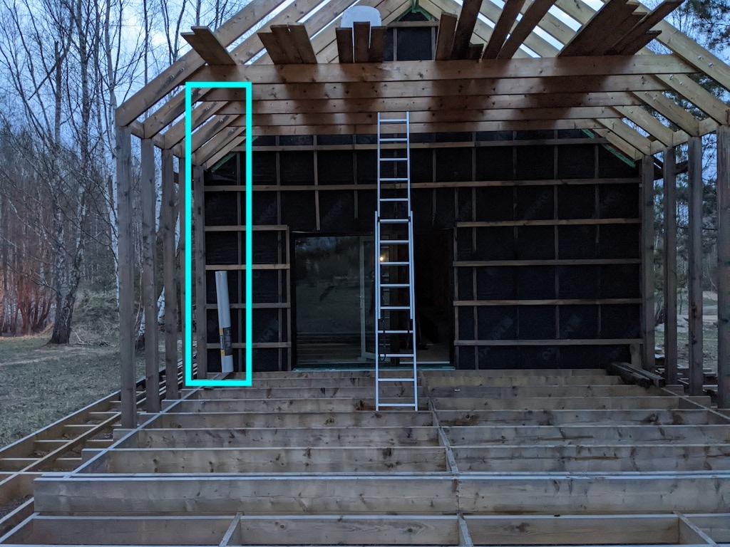

The ridge is about 5850 mm so we're almost at ridge height here. The roof is between about 3400 and 3900 so there are no joints inside it.
Every piece of twinwall is clamped tight. The restraint at rafter level holds the flue near the middle, the stove holes the flue at the bottom, and gravity does the rest.
There's a cowl/clamp on the OUTSIDE of the roof to hold the flue "part way"
Benefit - simple
Benefit - mechanically robust
Benefit - marginally better insulation when not in use (less area exposed directly to outisde in that you have the thermal bridge from the outer wall of the flue but none of the inner wall is visible
Downside - dear lord is 230 mm large compared with the stove and with the curved top rather than a flat top to the stove it will probably look silly and be my fault. e.g.

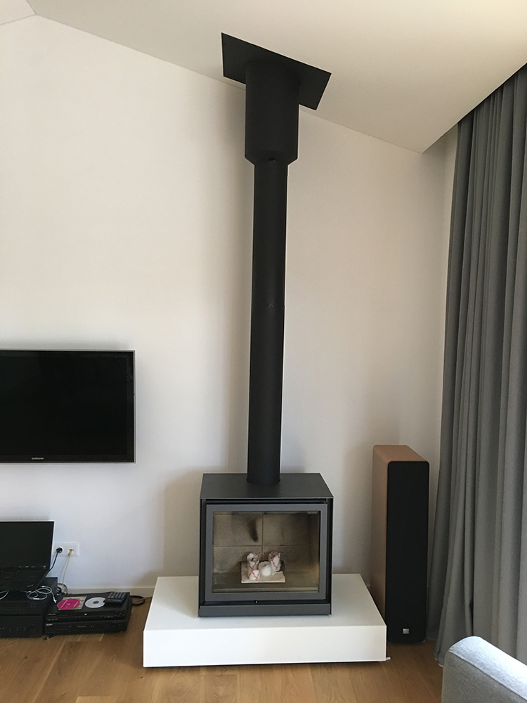

2) Run the first 2 metres in single wall then 50 mm insulated twinwall the rest of the way
Swap the damper and the first two sections of flue for single wall black iron and convert near ceiling level
Downside - this is probably wobblier mechanically and might need external supports?
Downside - I can't imagine having much success colour matching black iron, vitreous enamel, and painting twinwall flue ending up the same colour after 5 minutes
Downside - two metres of single wall flue that's as cold as it is outside when the stove isn't in use (heat pump is probably main source of heat - stove is there for the love of burning things / clearing up windfall from the land / fast reheat from cold)
Benefit - we think prettier though you still end up with a +100 mm diameter "blob" at ceiling level:

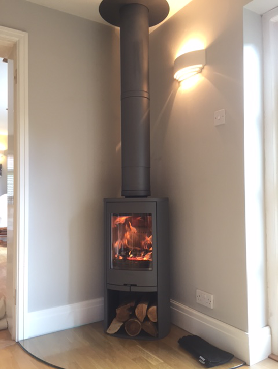

3) Run the lot in 25 mm insulated twinwall
At 180 mm overall this seems to be a good compromise between the visual bleurgh of the 230 mm twinwall and the faff / cold of running single wall then converting to twinwall.
Aside from the 50 vs 70 mm clearance to combustibles - which is neither here nor there - what is the benefit to running with 50 mm insulation vs 25 mm insulation on twinwall?
Part of me thinks salesman wants to sell 50 mm twinwall because slightly spendier than 25 mm. Part of me thinks that this is just what people use around these parts when the similar diameter flues are in use on larger appliances and larger buildings. (150 and 200 mm internal diameter are standard in the DIY sheds) Part of me thinks I'm missing something obvious but can't for the life of me work out what!

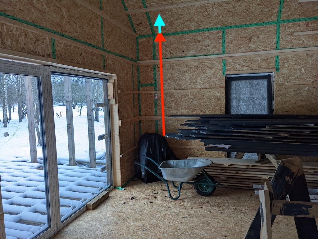

4) Hide it in the corner and DIY shed the lot?
150 mm ID / 250 mm OD twinwall is stupid cheap if you're ok with galv mild steel outside (fine if being primed and painted to match the roof) and 304 stainless inside (fine if only ever burning dry) - €42 per metre
https://online.depo-diy.lt/products/6252
We could...run a 150/250 twinwall flue right in the corner of the room. (to the left of the green tape showing where the rafter is) Rest the flue stack on the floor. Use a tee to take either the rear-exit outlet from the stove. False wall to hide the flue entirely. Pain the bit you see on the roof to match the roof.
Condensate drain and fresh air inlet could be done the same way (150 mm plastic duct feeding 150/250 twinwall flue that joins the outer wall of the main flue but has a condensate drain pain to separate the two sections).

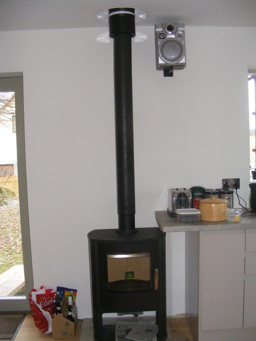

Option 2 is what i did.
The single wall flue does not seem "cold" when the stove is not in use, certainly not cold enough to cause concern at heat loss.
I bought from flue-pipes.com and their black single wall and twin wall all matched in colour and were a pretty good match to the matt black of my stove.
For the roof penetration, they sold an insulated sleeve.  This is a hard insulating tube that is a snug fit around the twin wall and can be made a snug fit and sealed in a hole in the roof.  It was obviously designed to be in direct contact with the twin wall flue so was a neat solution.
It is not at all "wobbly"
P.S that overhanging kitchen worktop was temporary

With the rear option, watch out for the "distance to combustible materials" particularly for the single wall flue. That could push the whole lot out into the room.
I really don't get much heat loss from the single wall section of flue.  I think the crucial thing is ducted air into the stove in my case from under the suspended floor, means cold air top and bottom of the flue so little convection.  IF the stove was taking warm air in from the room, you could get more convection and heat loss.
