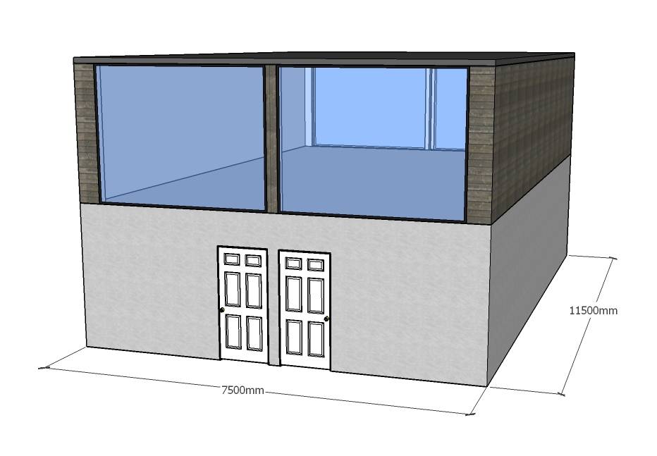

Daniel Posted May 14, 2017 Share Posted May 14, 2017 (edited) Hello I'm going to build a one storey garden house with basement this summer. I haven't really build a lot before so I would appreciate an advice here. The site is very tight and one of the objectives of the project is to utilise as much space as possible efficiently, so every inch of the wall width counts here. I'm going to build it mostly myself with one assistant builder and have to squeeze the project into a lowest possible budget. The building plan as very simple being effectively just a box of 7.5m x 11.5m with basement and 1st floor both 2.5-2.7m tall. There will be one internal non-bearing wall and a flat roof. 1) Basement walls and ICF ICF blocks seem to be hugely advertised nowadays by I'm not sure is there real value behind it? Self-building seems pretty straight-forward especially after studying manuals. I'm considering the possibility of building either basement walls of ICF and first floor of SIP and frame or building both basement and first floor of ICF. Does anyone here have experience with them? Should I really be using them especially in terms of saving precious centimeters of the wall thickness while achieving sufficient U-value There are quite a few ICF suppliers on the market, which ones are cheaper and still good quality? I've requested a quote from Nudura (and studied their docs quite thoroughly) but expect the quote to be quite high If not ICF that which other options should I consider for basement walls? What would be your opinion on the thickness of these walls. I know people are mostly using 8" and more thick concrete for basements, by do you think it would be technically possible to go with 6" by adding extra rebar? Or even 4". I just must save every extra inch, that's crucial 2) First floor walls, roof and SIP I was thinking maybe I should build everything higher than the basement of SIPs? Including the roof. Am I right that I wouldn't need vertical steel supports for SIPs in such a case? Which other ways for building first floor and roof should I think of? It should be space efficient. Also I'd better save on extra labour in favour of pre-build units like SIP. I'd be glad to provide any additional information needed.. Thanks! Edited May 14, 2017 by Daniel 1 Link to comment Share on other sites More sharing options...

PeterW Posted May 14, 2017 Share Posted May 14, 2017 Welcome ..! i doubt you will get a SIP that will span 7m - that will need some serious support and an 11m steel will be even more eye watering ..! Looking at that design I would consider ICF all round - easier and quicker especially if you have room to dig down to get them in with space for waterproofing below ground. At 154sqm that is a big "garden house" and has the ability to swallow £150-200k at a blink if you're not careful ..! Link to comment Share on other sites More sharing options...

PeterW Posted May 15, 2017 Share Posted May 15, 2017 It's the span that is causing you the problem not the weight. You will have to go deep to get the deflection limits hence the depth you are seeing. I would look at putting some sort of stub walls at least to get a mid span down to say 4m and then use that to support the roof lengths at 5.5m Link to comment Share on other sites More sharing options...
