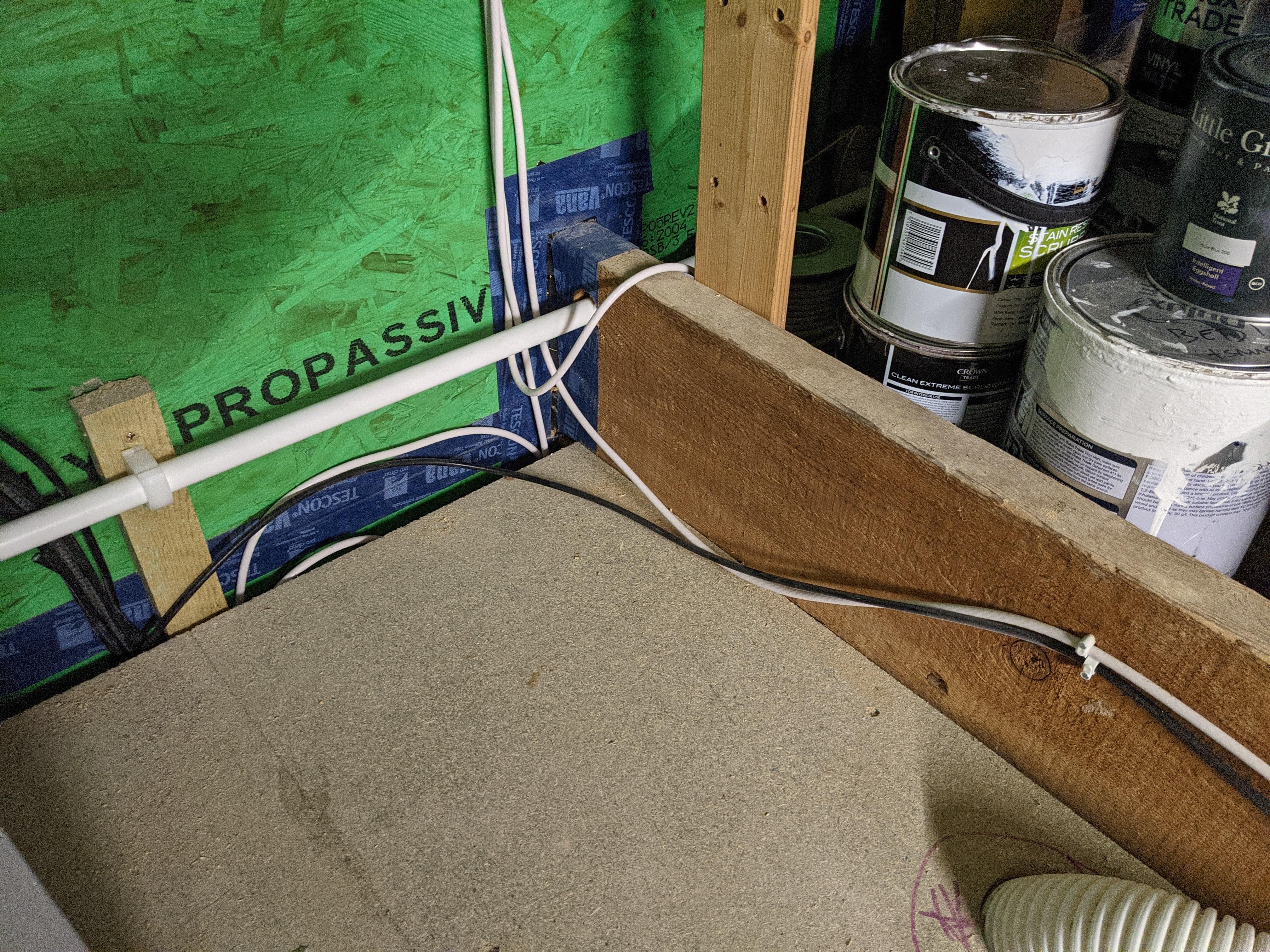

joth Posted April 18, 2022 Author Posted April 18, 2022 On 17/04/2022 at 09:36, joe90 said: I have an 80 litre buffer on a “stool” made from 4x2 and thick ply top 👍 I've sent Newark and Telford and enquiry about wall-mounted buffers. However i think I can probably make a stool for it. There's an original joist running the down the center of the loft under the roof ridge, perpendicular to the ceiling joists below it. Rather than view this as an obstacle I think it's an opportunity. I can use some garden sleeper offcuts beside it and a plywood top, and this will transfer some of the tank weight directly into the gable end. 1

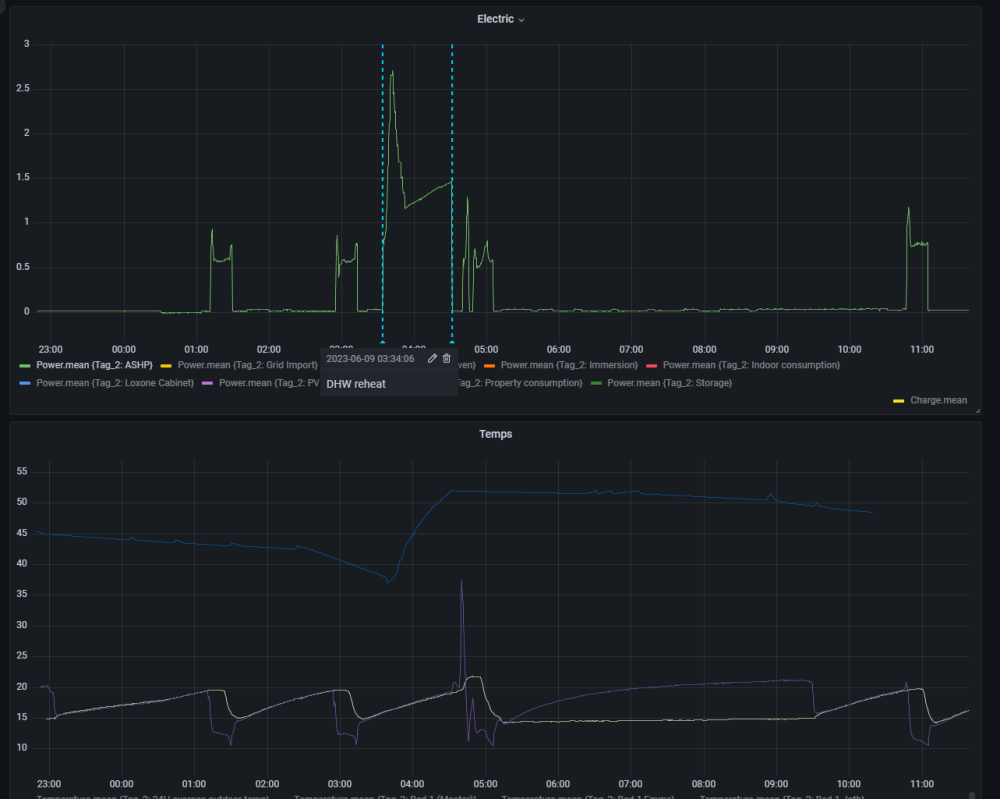

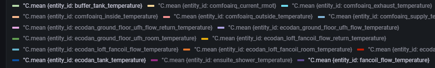

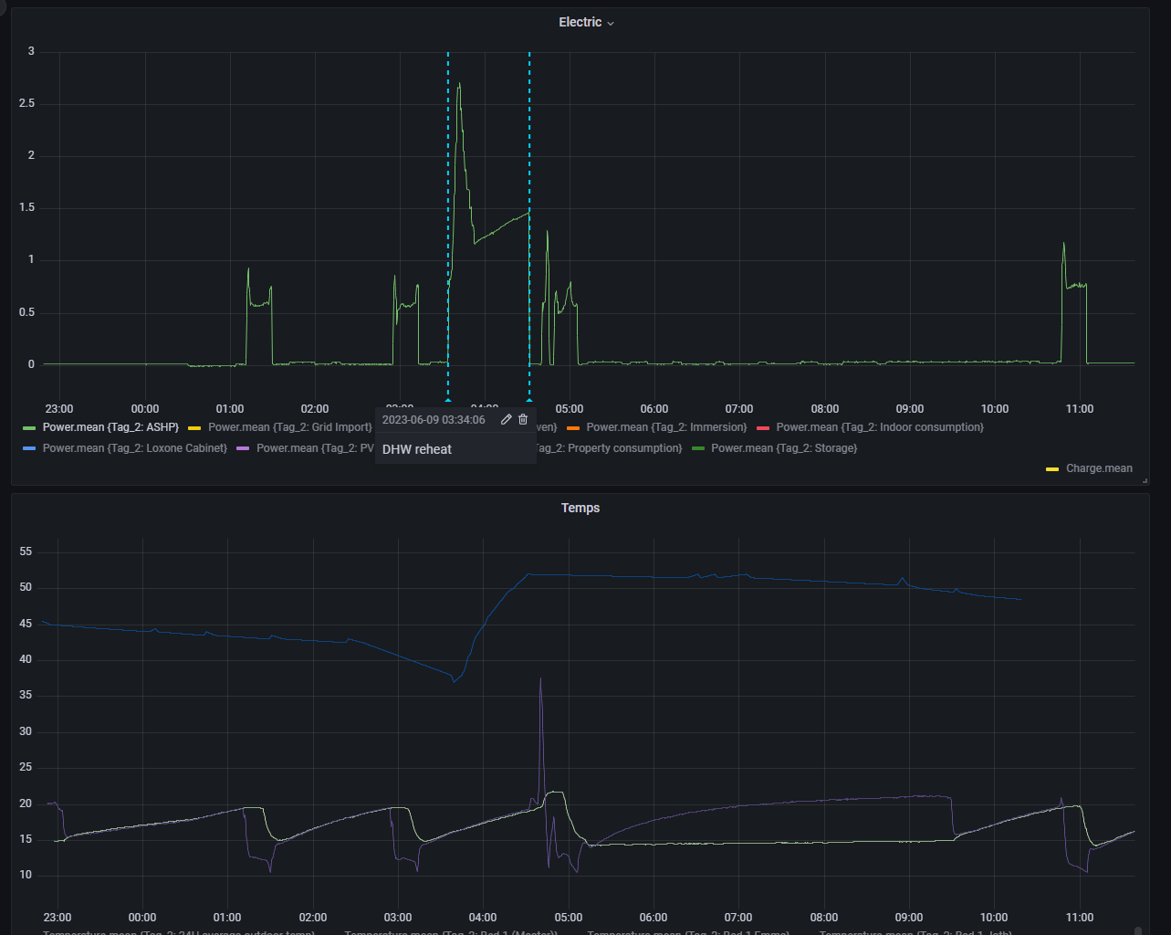

joth Posted June 9, 2023 Author Posted June 9, 2023 (edited) Wow one year on! Just to wrap up this thread, I returned the Kingspan Albion 150L and bought 80 Litre "TESY Bi-Light Electric Hot Water Cylinder" and wall mounted that (my first time having fun with Chem bolts!) and using that as a buffer tank fine. Finally got it all plumbed in last month, and after a lot of tinkering in Loxone have managed to force sensible level of hysteresis from the ASHP in charging/discharing the buffer which looks like it has fixed the short cycling issues when running the FCU: instead of 15 cycles an hour, I'm down to one cycle every 100mins. The controls are a bit complex. I plumbed the buffer in series with the two FCUs but found that when the ASHP is running it would still short cycle as the FCUs are a bottle neck and don't let water through to the buffer fast enough. So I now have a FCU bypass loop (basically open a spare port on the manifold that is piped directly from supply to return) which allows much faster feed into the tank. I have temperature sensors on the zone supply and return pipes, plus in the tank itself, so I can tell if the incoming water from ASHP is cold enough to be "useful" to cool down the tank or not, to control this actuator. As a bonus, this means when the slug of hot water comes through when the heatpump switches from DHW reheat mode back to cooling, I can close down all the actuators to stop this unhelpful 40+ deg water getting into the FCUs or the buffer. (the zone has an automatic bypass across the lot, for this situation). This is all illustrated in the data: Light blue dashed lines indicate where DHW reheat ran in the middle of the night, you can see the buffer continued cold supply to the FCU during this period, until the ASHP switched back to cold mode and that hot slug of water came through and briefly slightly the buffer (the actuators aren't instant, alas). Each ASHO cooling cycle runs for about 20mins (1kW primary energy draw) and then is idle for 80mins as the buffer supplies cold to the FCUs until the buffer drops to the low temp threshold. I haven't insulated all the new pipework yet, so the buffer is working between 15 and 19deg to avoid condensation. Once I have completed insulation I'll crank that down to 10-17deg or something which should work even better for avoiding cycling. For completeness on the project (bits of which mentioned here) my second FCU is now feeding two rooms, using an electric controlled air baffle to shut off supply to the lesser used room when not in use (which is also much nearer the FCU so naturally gets priority when the baffle is open), so we now have 3 bedrooms being supplied from this FCU buffer circuit. Edited June 9, 2023 by joth
