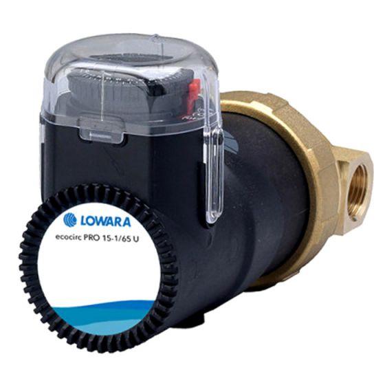

JohnMo Posted April 15, 2022 Share Posted April 15, 2022 I'm using a Lowara Ecocirc Pro pump, which has an integrated timer. Works great, real easy to install, just power needed. Several sizes are available. 1 Link to comment Share on other sites More sharing options...
