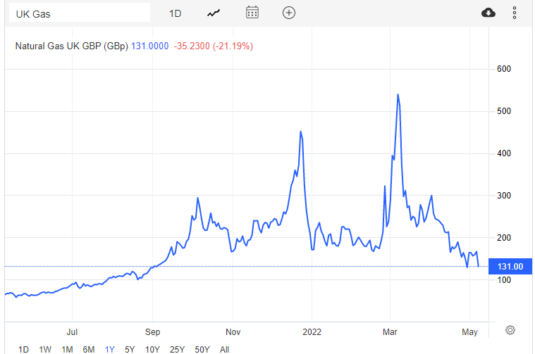

Yes but where is electricity prices going? Down! I don’t think so, with Putins war and around 40% of our lecky generated by gas (currently) who knows how high the price will go. 🤔
Gas prices have.
26 minutes ago, SteamyTea said:
Gas prices have.
Only in the short term after a spike!
Probably no big shocks till autumn, then, hopefully, we will have the LNG supply from the UA and USA sorted out.
Though it does depend on what Hungry does.
