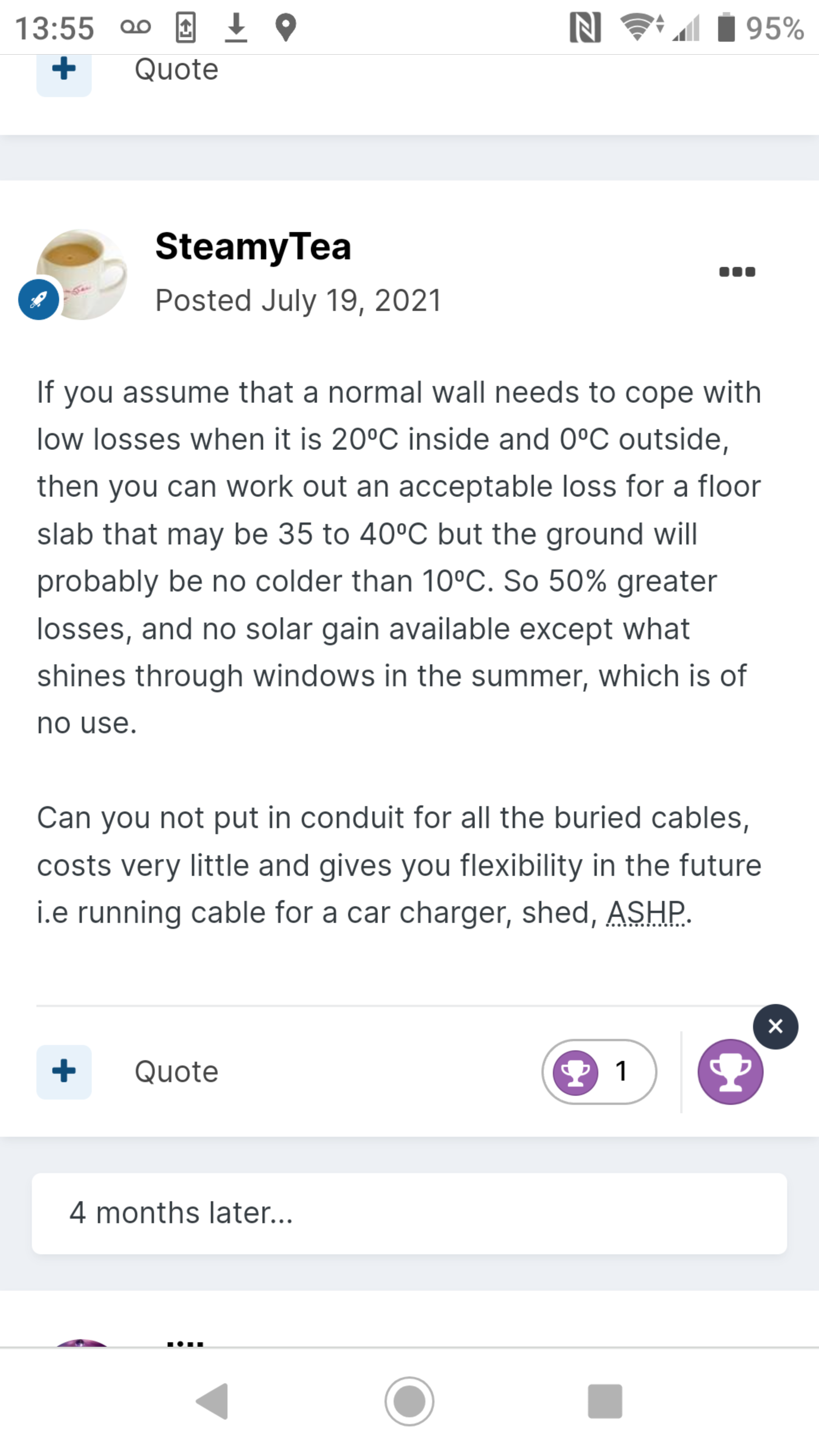

Jilly Posted April 11, 2022 Share Posted April 11, 2022 57 minutes ago, WWilts said: from the web: About 25% of the heat produced by your boiler will escape through the roof of your home. About 35% of the heat will escape through the walls and through gaps, in and around windows and doors, and about 10% of heat will disappear through the floor. Invested the limited funds in expanding cavity insulation from 100 to 125 average. Only 100mm available for insulation from highest slab surface to bottom of 50mm screed. This is an explanation of the physics behind needing as much insulation as poss under ufh. The 10% losses refer to when using normal radiant/convection heat. That said, I've only got 100mm too. 1 Link to comment Share on other sites More sharing options...
