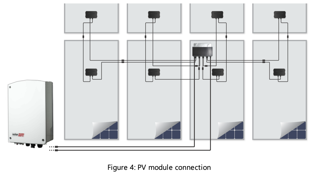

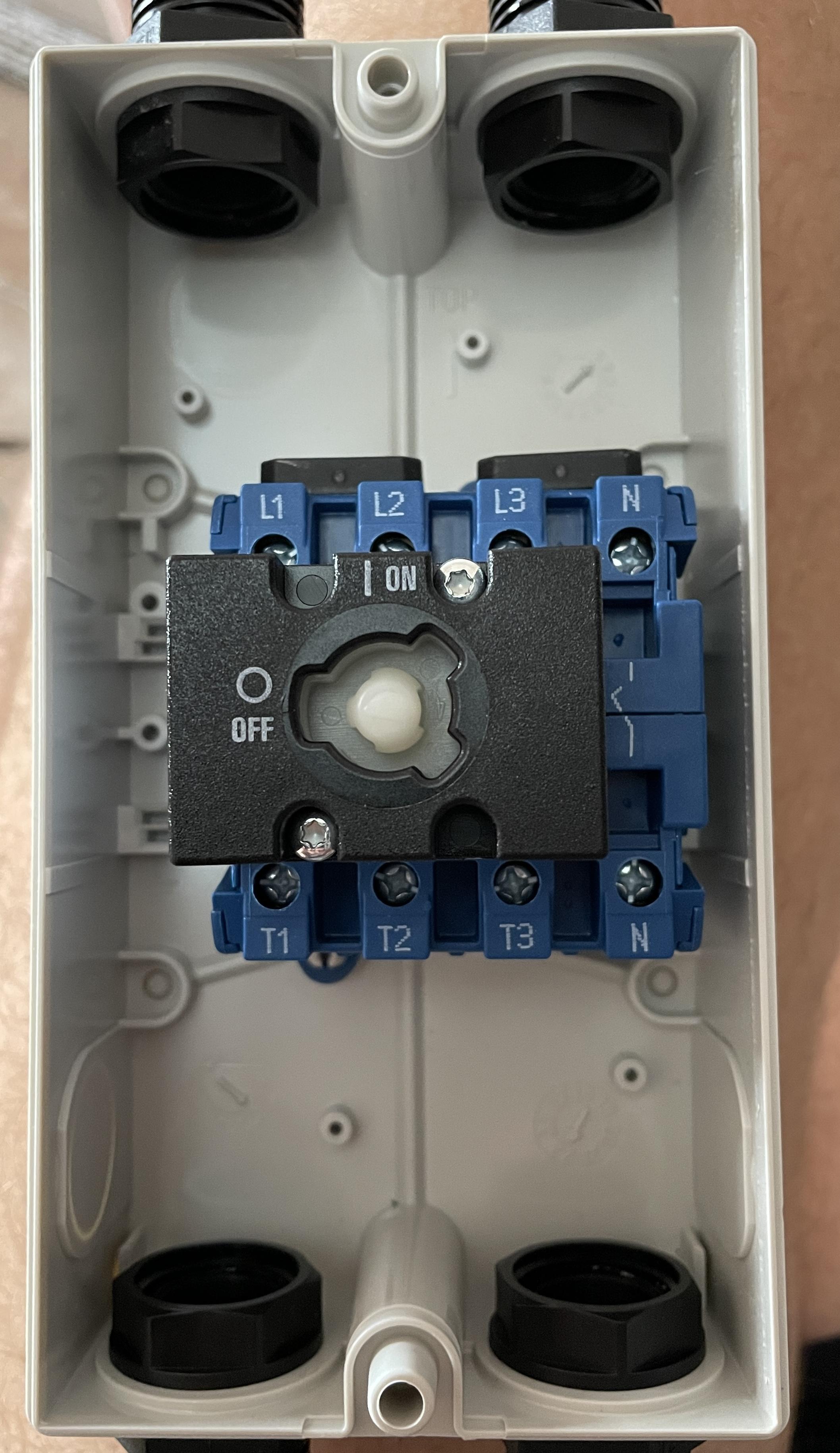

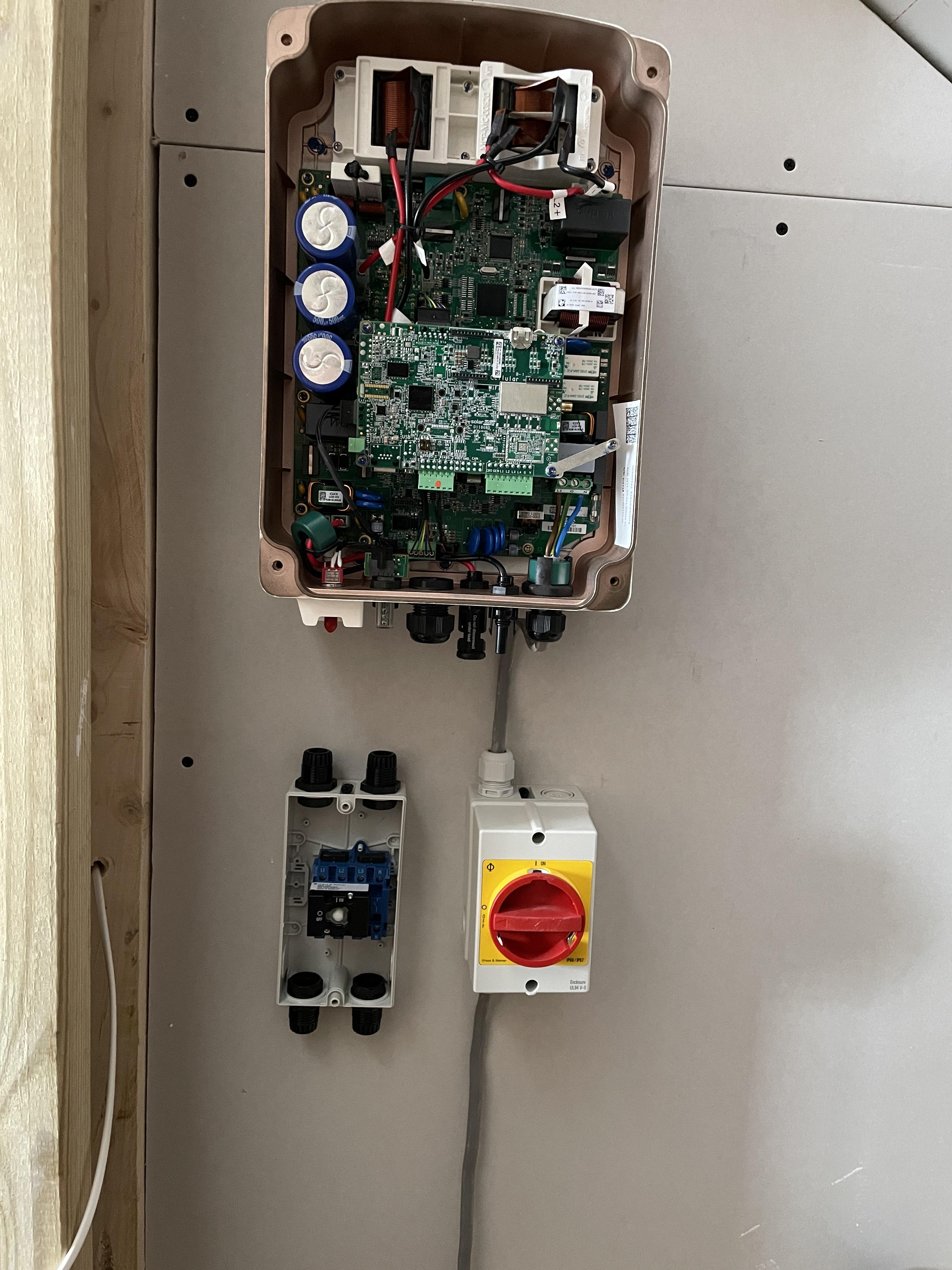

Timmyk Posted July 12, 2022 Author Posted July 12, 2022 (edited) Interesting discussion - thanks everyone. I think on balance I’ll just fill in the forms to be safe - regardless of it’s actually meaningful or not. Quick question about wiring. I’ve taken everyone’s advice that despite this Solaredge inverter having a built in DC isolator, I’m going to put an external one in as well. this is how it currently looks: Question is simply - does one dc cable from the optimiser pass through the neutral port in the dc isolator and the other through a live port? If so does it matter +ve vs -ve way round? Not both through separate live ports, correct? thanks! tim Edited July 12, 2022 by Timmyk Photo added

Dillsue Posted July 12, 2022 Posted July 12, 2022 On 12/07/2022 at 09:59, Timmyk said: If so does it matter +ve vs -ve way round? Expand What is important is that you get the live conductors in L1-3 and not in T1-3. L = Line which is the incoming live supply. Unless the interlock has been defeated, you can only remove the isolator cover in the off position. In the off position the only live terminals should be L1-3 so your incoming cables from the PV array would be in L1 and either L2 or N depending on where you want to put the incoming -ve. Unfortunately the same principle applies to the AC isolator!!
Timmyk Posted July 12, 2022 Author Posted July 12, 2022 On 12/07/2022 at 15:28, Dillsue said: What is important is that you get the live conductors in L1-3 and not in T1-3. L = Line which is the incoming live supply. Unless the interlock has been defeated, you can only remove the isolator cover in the off position. In the off position the only live terminals should be L1-3 so your incoming cables from the PV array would be in L1 and either L2 or N depending on where you want to put the incoming -ve. Unfortunately the same principle applies to the AC isolator!! Expand Thanks. I think I’ve got the AC isolator the right way round. The live coming from the inverter is connected to L1, and T1 outputs to the consumer unit. Technically though I guess both sides of this are live as one is an input from the inverter and the other is an output to and input from the consumer unit. Regarding the DC isolator - understand that the live side (from the panels) goes into the L side. I will put one into L1 and the other into N for the sake of neatness. T side will output to the inverter. Which is annoying as it’s basically upside down! Am I all correct there? thanks again
Dillsue Posted July 13, 2022 Posted July 13, 2022 Switch the AC isolator off and the inverter should shut down, then which terminals remain live with the isolator cover off?

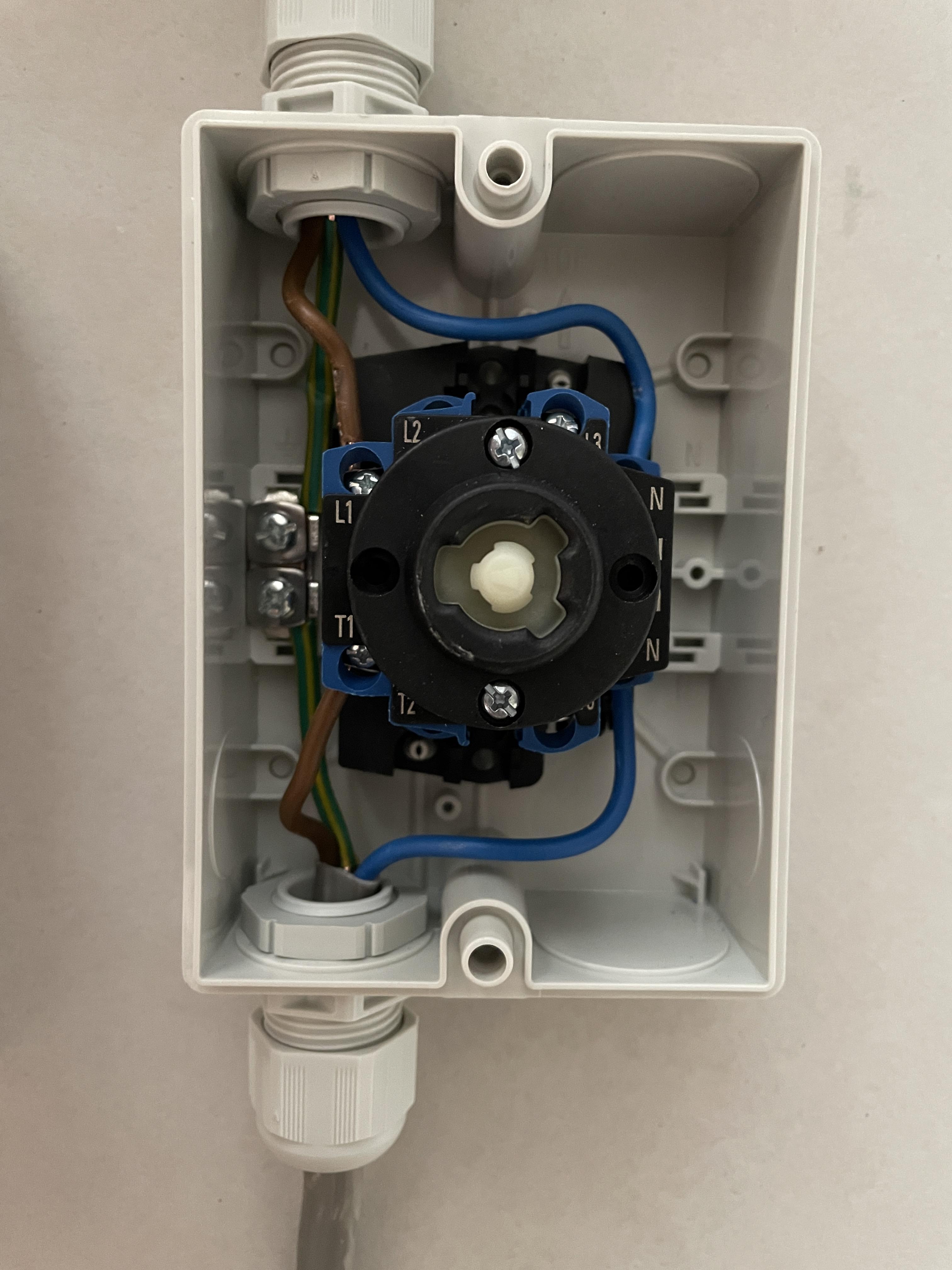

Timmyk Posted July 13, 2022 Author Posted July 13, 2022 (edited) On 13/07/2022 at 06:40, Dillsue said: Switch the AC isolator off and the inverter should shut down, then which terminals remain live with the isolator cover off? Expand The terminals to the consumer unit. I’ve currently got T1 going to the consumer unit. So I’m upside down, correct? Interestingly this is the wiring guide for the DC isolator, which shows input from the PV array and output to the inverter all in T1-3. Not the best quality photo but the lower side of this is T1-3. Edited July 13, 2022 by Timmyk
Dillsue Posted July 13, 2022 Posted July 13, 2022 Yes, your AC isolator wiring isnt best practice but you can see from the wiring guide of the DC isolator that best practice isnt always followed. The DC isolator wiring is using 2 poles for +ve and 1 pole and N for negative, the thinking being that if 1 pole welds closed theres a second pole that should still break the circuit when the isolator is turned off. That wiring guide would have been better wiring +ve In into L1, a link fitted from T1 to L2 and +ve Out wired to T2. Same principle for -ve. Keeps the Line/live and the load on the correct sides of the isolator. Having already wired your AC isolator I personally wouldnt rework it to best practice, but maybe put some tape over the terminals fed from the CU and write "Line/live" on it. Be a reminder for you if you ever have to go back in there

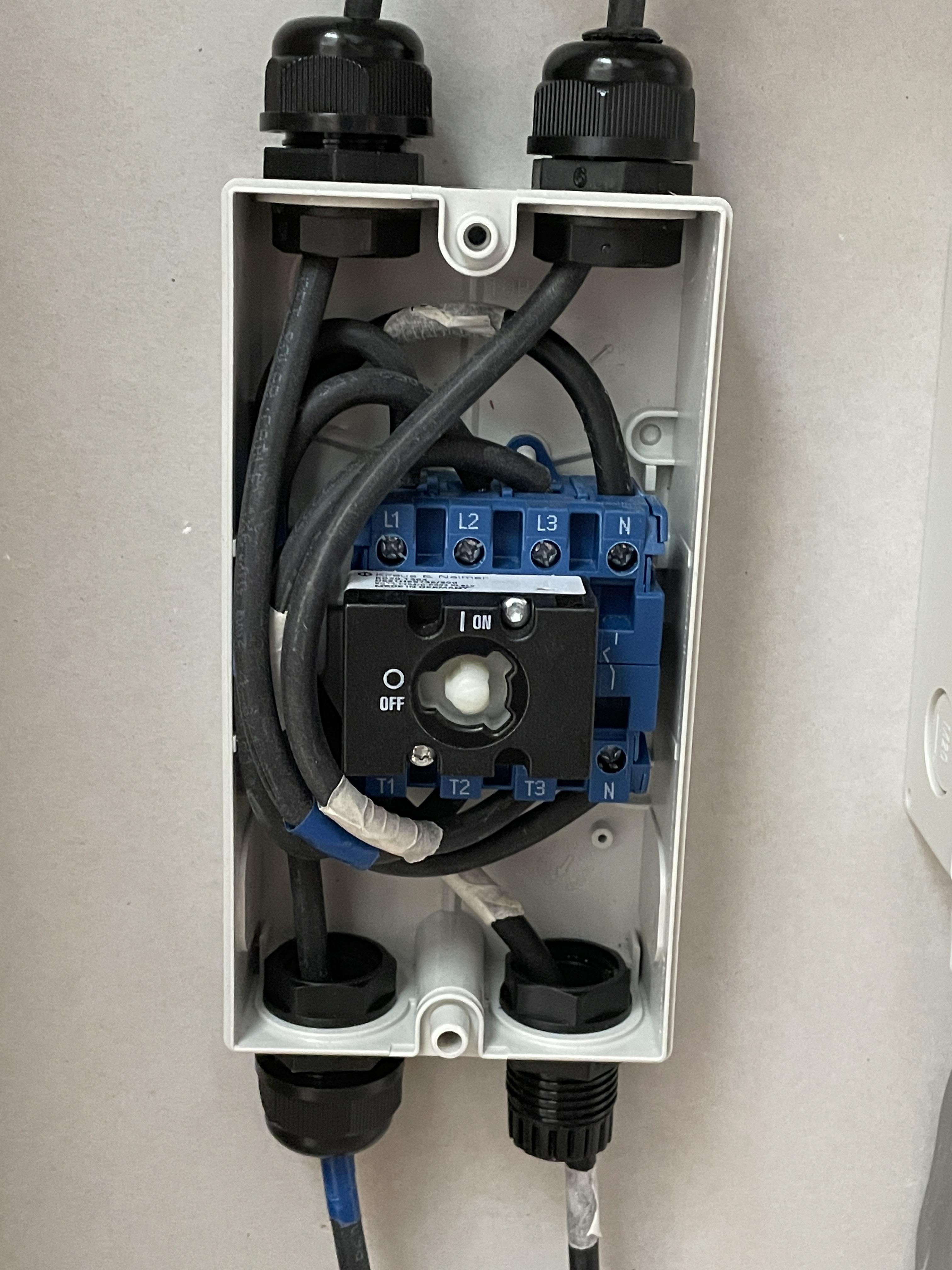

Timmyk Posted July 13, 2022 Author Posted July 13, 2022 Okay so this now runs: 1. Optimiser(+ve)-> L1 -> T1 -> L2 -> T2 -> inverter +ve 2. Optimiser (-ve) -> N -> N -> L3 -> T3 -> inverter -ve Lots of wiring inside the isolator as you can see but I’ve taken your advice and gone for best practice so hopefully you approve of it! AC I’ve left as it was. Not ideal I appreciate but as you said it’ll work. Now I just need to test the panels and inverter are working and then get someone willing to wire it into the fuse box. Anything I’ve missed/words of warning? thanks again for all the assistance Tim
