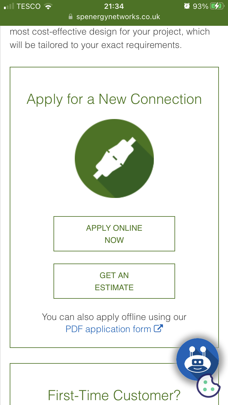

Hope someone can help point me in the right direction, we are at the point of narrowing our choice of the 2 plots on offer. Our preference has services nearby we have been told also the plot next to this one has just completed building other plots have been completed over the last few years. The plot has full planning permission granted and we would submit a new design and layout. What is the best method to establish the location of the services in the South Lanarkshire Council area? Would it be best to have a GeoSurvey carried out? Have experience dealing with Scottish Water which is a total nightmare. Have access to free use of a CCTV drainage camera and CAT & Genny if this helps.

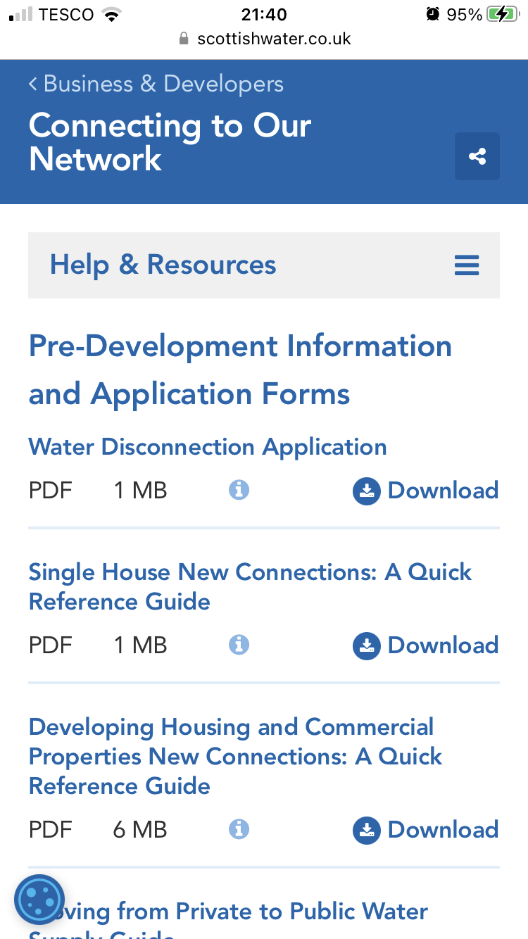

Hi @Joe-90, I’m in south Lanarkshire, we found Scottish power knew where they’d be connecting from (although it wasn’t quite as simple as that) and Scottish water were the same, knew where they needed to connect from but getting it done was another story!
Oh thanks @recoveringbuilder if possible could you share contact details for both as I have tried to reach out to both of them and ended up being past around door to door Scottish Water total nightmare

If you go on to SP energy network website there’s a form for new house connection , you can get a quote from them. Scottish water won’t engage with you until you actually apply for the connection and pay the money 6051F6DB-8771-4ABF-ABEF-F56DBB7EFC86.thumb.png.5e85eb4a3b95fb0abf23460786987f79.png
