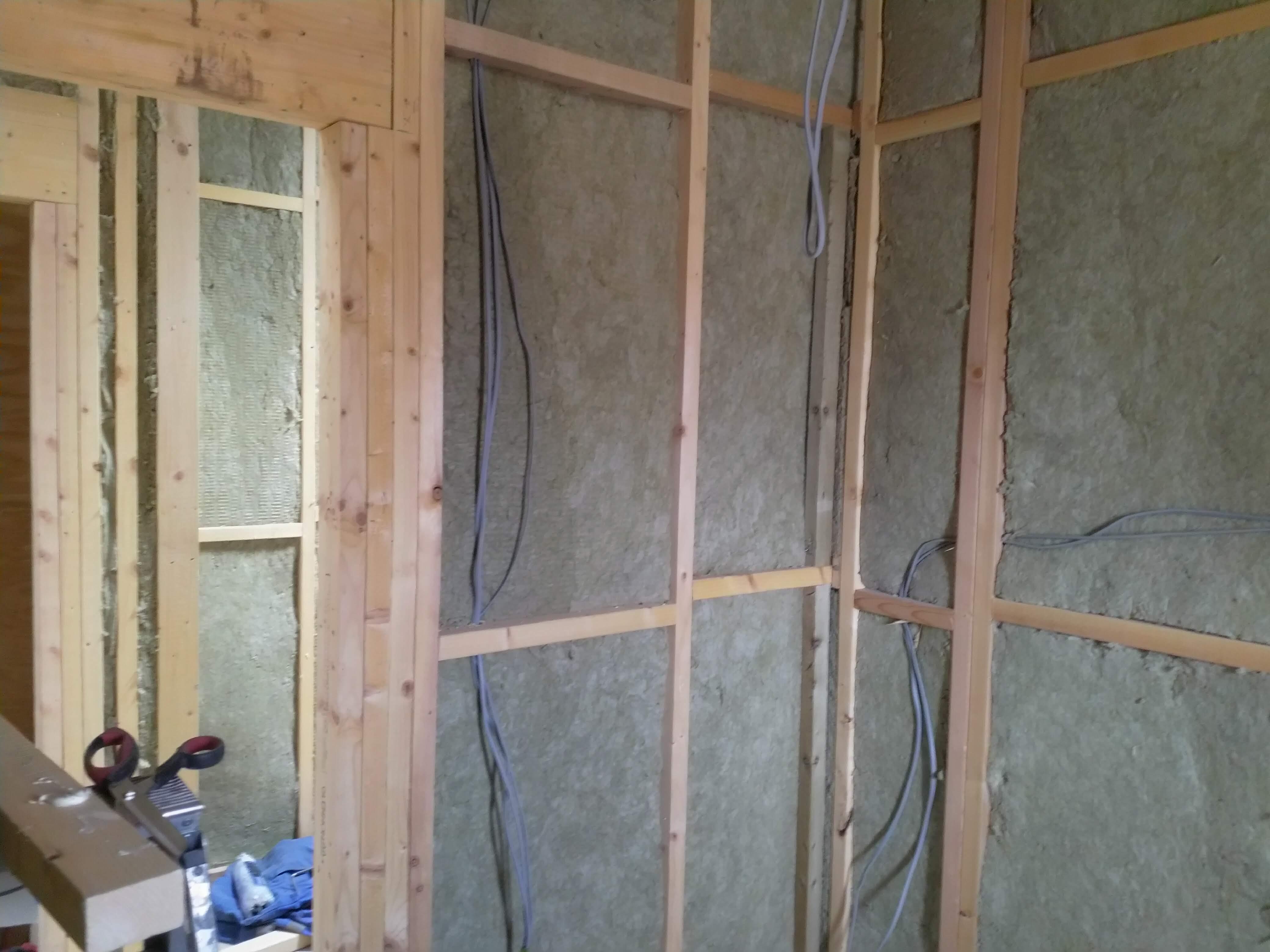

JohnMo Posted October 16, 2023 Share Posted October 16, 2023 13 minutes ago, markharro said: And in tips of best place to buy this stuff? Prices vary from supplier to supplier daily, you are best to shop around. Rockwool Flexi is pretty good also. I sealed all my gaps by stuffing off cuts of rockwool into them. We have 100mm studs, 70mm rockwool, no gaps, 12.5mm plasterboard either side, taped (not plastered), decent doors, with 10mm under cut, and you hear nothing going on in the house. The only exception to that is around our lounge has structural walls 200mm thick they have 2x 70mm rockwool in them. Lots of overthinking going on. Link to comment Share on other sites More sharing options...

saveasteading Posted October 16, 2023 Share Posted October 16, 2023 30 minutes ago, JohnMo said: to fill any gaps Important. Gaps are bad for thermal and sound insulation. Better a poorer quilt with no gaps than the densest fitting poorly. Link to comment Share on other sites More sharing options...
