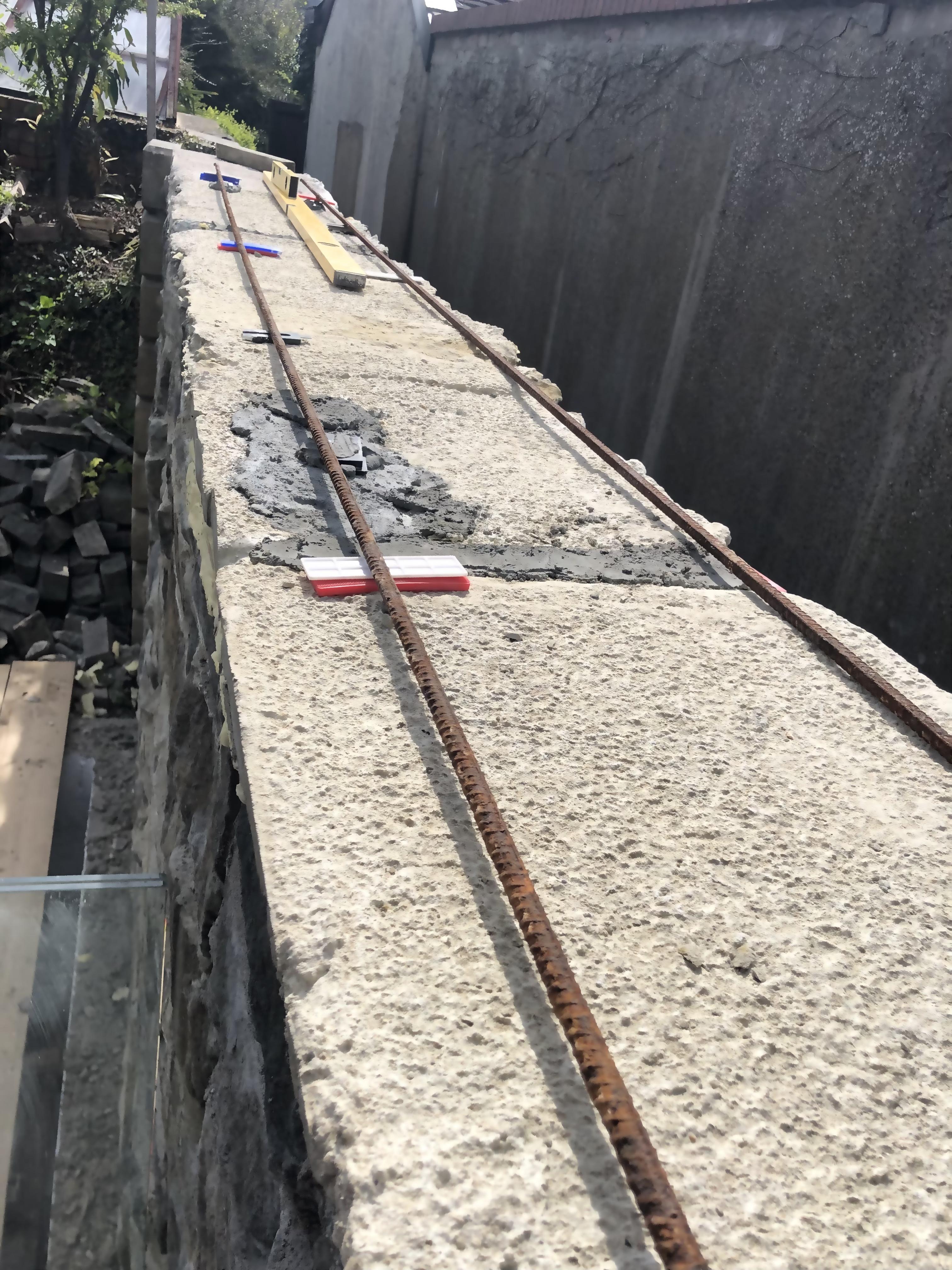

Pocster Posted April 11, 2022 Author Posted April 11, 2022 Taking all the advice and suggestions I had a brief moment of brilliance! The issues are the bed being flat and the fact copings don’t particularly stick well to concrete. So ! . Rebar rods down each side that are dead level , packers if need be .Cement them in and fill any holes with cement . SBR on the existing base . Then concrete again along the middle using the rebar rods as a definitive level I.e drag a piece of timber along them . Should get a guaranteed level . 3 lines of grip fill and just place coping on . No fumbling with packing , cement dropping etc. This is THE solution !

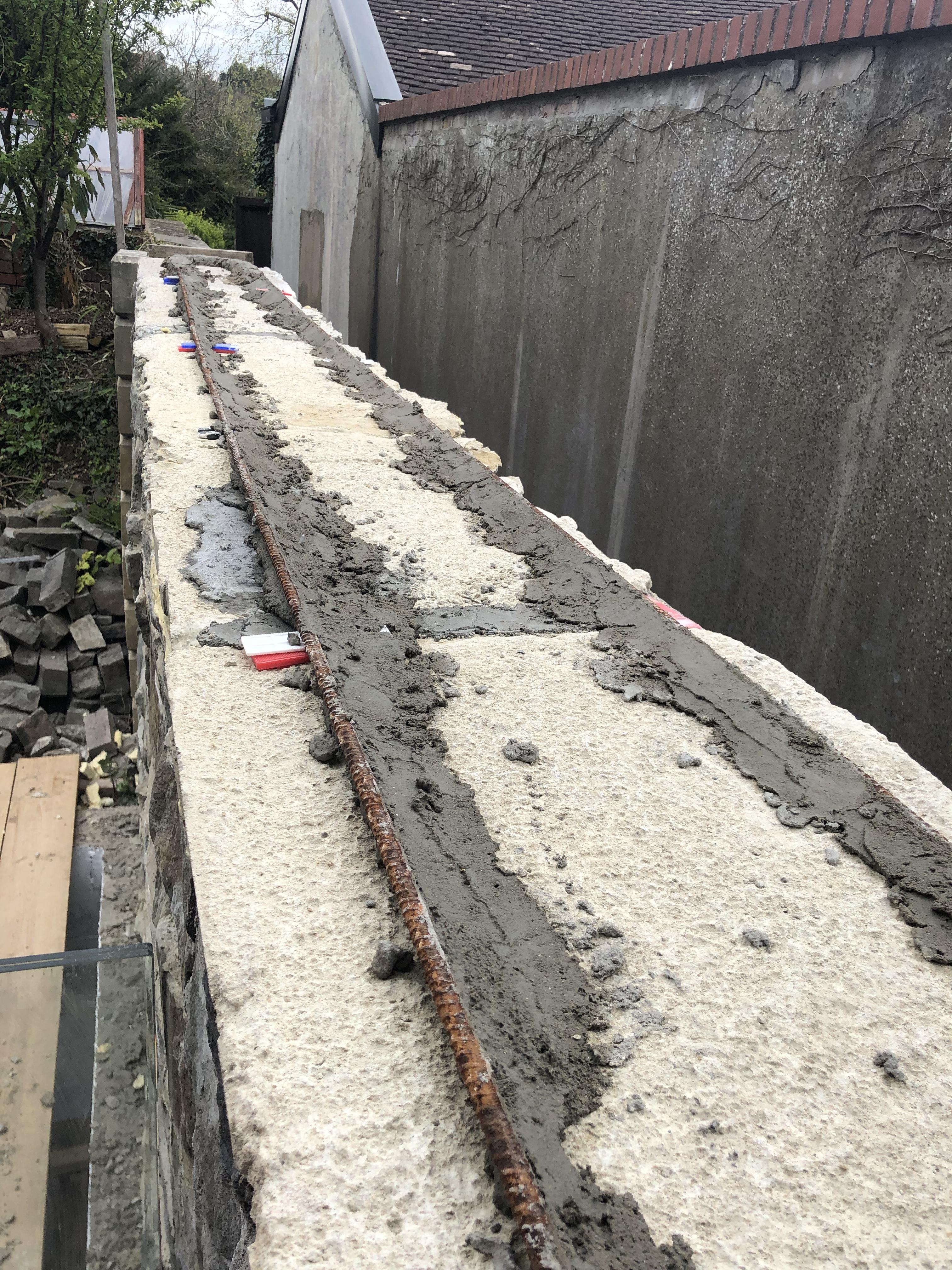

Pocster Posted April 11, 2022 Author Posted April 11, 2022 (edited) Rebar bars dead level Cement rather than foam as too breezy . Leave to cure for a bit then SBR . A non stiff cement mix . Tap it in using the rebar as my guide . Perfecto ! ( in theory ) Edited April 11, 2022 by pocster
PeterW Posted April 11, 2022 Posted April 11, 2022 5 hours ago, pocster said: 3 lines of grip fill and just place coping on Not unless the concrete has dried for at least 30 days and you’ve kept it dry too as it will just pull off. What’s wrong with using an SBR mortar mix ..??

Pocster Posted April 11, 2022 Author Posted April 11, 2022 (edited) 34 minutes ago, PeterW said: Not unless the concrete has dried for at least 30 days and you’ve kept it dry too as it will just pull off. What’s wrong with using an SBR mortar mix ..?? Nothing - but it would have to be a super thin bed . The coping stones don’t exactly stick well to mortar in my experience. What’s wrong with an adhesive ? Edited April 11, 2022 by pocster

PeterW Posted April 11, 2022 Posted April 11, 2022 8 minutes ago, pocster said: Nothing - but it would have to be a super thin bed . The coping stones don’t exactly stick well to mortar in my experience. What’s wrong with an adhesive ? Could be because you’re using the wrong type of mortar or not pre-priming etc..? I bed them on to 5/1/0.5 sand cement lime with a waterproofing admix and they don’t move anywhere. Gun adhesives are not designed for this sort of situation - you need a full width bed under the coping stones or they will just pull free. If you want a thin set full bed adhesive for these then this stuff is good - will work well with your concrete infil as will mechanically bond also. https://www.homebase.co.uk/norcros-rock-tite-outdoor-tile-mortar-25kg/13628420.html 1

Pocster Posted April 11, 2022 Author Posted April 11, 2022 Well ; it’s nice and level . I do like my rebar method and will use that principle again on the front . I will bed the copings in a very thin cement mix with Sbr - so I don’t get any abuse .
