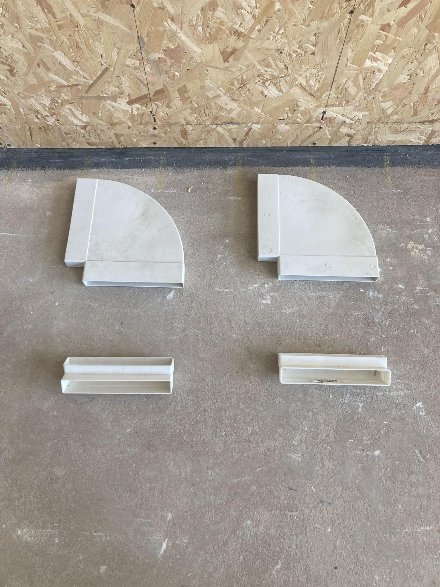

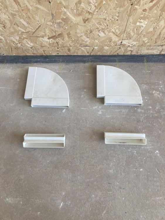

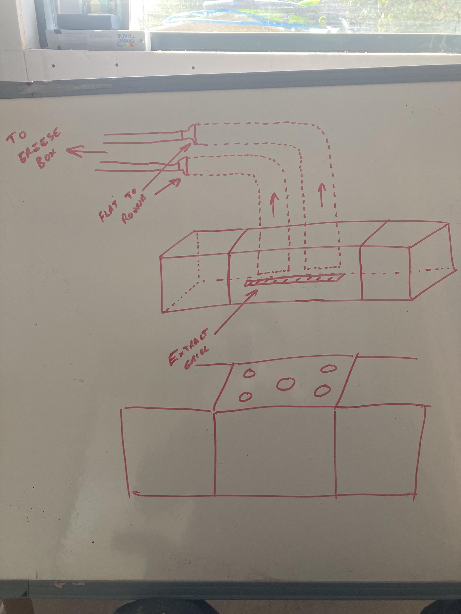

Russell griffiths Posted April 1, 2022 Posted April 1, 2022 We did a design for something similar on my wall in marker pen, spent a good couple of hours on it, it might still happen. Basically it was two 225x25 ducts hidden in the wall, turning 90degrees to project outwards. The outer opening would line up with a decor panel that was on the underside of the upper cupboards these ducts would have a 3D printed grill over them. Ducting then went back to an in-line unit with Greece filter on the loft above kitchen.
Russell griffiths Posted April 1, 2022 Posted April 1, 2022 2 minutes ago, Big Jimbo said: 29mm ducting ???? That is not going to be worth having. When i did kitchens for a living, all of the external extractors i fitted required ducting of 250mm, and sometimes 300mm. If you have only got 29mm for ducting you need to have a serious think about alternatives. Isn’t it 29x225.
SimonD Posted April 1, 2022 Author Posted April 1, 2022 18 minutes ago, Big Jimbo said: 29mm ducting ???? 16 minutes ago, Russell griffiths said: Isn’t it 29x225. Yes, it's 29mm deep. I've also found some that's 308mm wide https://www.nationalventilation.co.uk/wp-content/uploads/2020/11/Monsoon-Rectangular-Ducting-308mm-x-29mm-Duct-Accessories.pdf 18 minutes ago, Russell griffiths said: We did a design for something similar on my wall in marker pen, spent a good couple of hours on it, it might still happen. Basically it was two 225x25 ducts hidden in the wall, turning 90degrees to project outwards. The outer opening would line up with a decor panel that was on the underside of the upper cupboards these ducts would have a 3D printed grill over them. Ducting then went back to an in-line unit with Greece filter on the loft above kitchen. Okay so I haven't completely lost it. That sounds very similar where I'd planned on using the corner in the kitchen base units to house the fan as I've ditched the idea of a corner cabinet to have some services in there instead.
SimonD Posted April 1, 2022 Author Posted April 1, 2022 21 minutes ago, Russell griffiths said: That's excellent, thanks

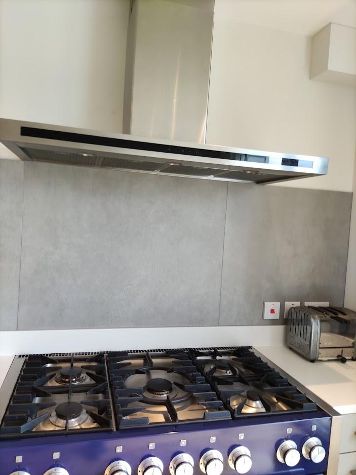

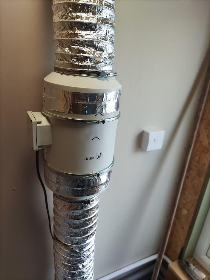

Mr Punter Posted April 1, 2022 Posted April 1, 2022 I have a canopy extractor and have removed the motor but left the lights and the grease filters. I have a 200mm TD Silent inline fan mounted in a service room above the kitchen connected up with 150mm round ducting and spigots. Operated by a switch on the wall. It is very nice and quiet and very good at extracting. 3
SimonD Posted April 1, 2022 Author Posted April 1, 2022 51 minutes ago, Mr Punter said: I have a canopy extractor and have removed the motor but left the lights and the grease filters. I have a 200mm TD Silent inline fan mounted in a service room above the kitchen connected up with 150mm round ducting and spigots. Operated by a switch on the wall. It is very nice and quiet and very good at extracting. Good to know. Thanks for the heads up on the TD Silent. I have a Vent Axia unit going spare I thought I'd used so I'll check to compare extract data.
SimonD Posted April 1, 2022 Author Posted April 1, 2022 (edited) That looks great @Mr Punter. Neat profile on the hood and simple which is what I'm looking for. Did you have any issues with the internals when you removed the motor, like losing the spigot or other necessary ducting that needed to be fixed? Edited April 1, 2022 by SimonD

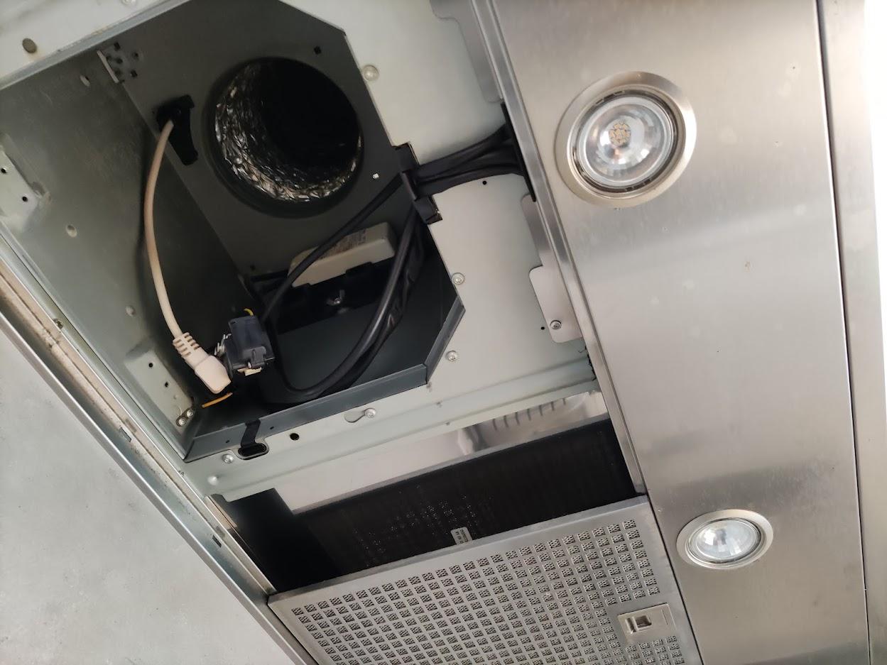

Mr Punter Posted April 1, 2022 Posted April 1, 2022 34 minutes ago, SimonD said: That looks great @Mr Punter. Neat profile on the hood and simple which is what I'm looking for. Did you have any issues with the internals when you removed the motor, like losing the spigot or other necessary ducting that needed to be fixed? No it was fairly straightforward. Here is how it looks now with a couple of the grease filters removed: 1
