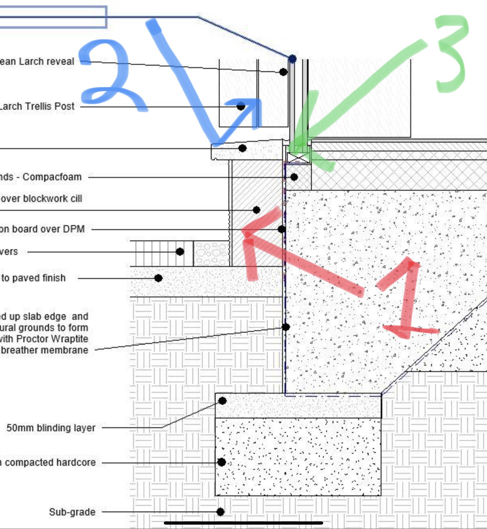

maxdavie Posted March 30, 2022 Posted March 30, 2022 I posted a few days ago with a timber frame 'cassette' system sunken below ground. It was met with skepticism (or outright disbelief) and I got lots of useful feedback. So, I changed the detail. I'm now sharing my updated details for the purposes of: 1. comment if there is any 2. sharing for sharing's sake (I'm new to this community so not sure if it's strictly problems-that-need-solutions content only or you're all just a bunch of self-build nerds that enjoy looking at construction details and other's progress. Please do tell me if this is a pointless post...) Anyway here are the updated details and a screenshot from my Enscape environment so you can see the visual intention of the details.
CharlieKLP Posted March 30, 2022 Posted March 30, 2022 What is your external timber column made out of? Currently you usually need to use steel if it’s supporting any structure. I think this is a building warranty issue… so it makes it difficult to get mortgage and resell. Would that be an issue for you? I don’t think the timber will support a cantilever either as an option. I’m sorry this might be a bit of a bummer.
maxdavie Posted March 30, 2022 Author Posted March 30, 2022 The external timber is all Larch. The large cantilever is achieved with a double joisted beam within the cassette. Engineer’s design. The post only has to hold itself up - it’s part of a trellis (not fully shown in that image). What sort of warranty are you talking about? I haven’t looked into warranties for this, but an LABC New Homes Warranty is on my radar for the next project - which will be a new home.
CharlieKLP Posted March 30, 2022 Posted March 30, 2022 I think you will be ok if it’s just trellis. I’d be happier using a steel portal frame, but if timber is ok then it’s likely ok! I think it looks really nice btw.
maxdavie Posted March 30, 2022 Author Posted March 30, 2022 Thanks Charlie! Fingers crossed it all comes together okay on site
Russell griffiths Posted March 30, 2022 Posted March 30, 2022 What are your thoughts on services. where are you running your pipes and cables. if you go down this route it would be more suitable to be built on an insulated raft, which will remove a lot of cold bridges.
maxdavie Posted March 30, 2022 Author Posted March 30, 2022 7 minutes ago, Russell griffiths said: where are you running your pipes and cables. There are no wet services in this garden room. Heating is all electric. I have an 18mm service void behind the plasterboard for cables - which I hope will be wide enough. I’ll increase that for future projects for pipe work.

saveasteading Posted March 31, 2022 Posted March 31, 2022 8 hours ago, maxdavie said: comment if there is any I being a Philistine, would simplify this massively. The raft foundation seems excessive unless the ground is very poor. The edges will require skilled shuttering joiners, but they won't be much interested in a small job. Never did understand why we should put sub-base in the bottom of a trench. Lean-mix concrete for me. The step is a brick sitting on the geound..it will move un less supported by the building. Cold bridge at the sole plate. dpm on the outer face of the raft will be torn/crumpled during construction. You shouldn't need it if the concrete is dense enough.

Iceverge Posted April 1, 2022 Posted April 1, 2022 Hi @maxdavie, Nice looking artistic render. Keep the questions coming. If we never explored different ways of doing things we'd never learn. I have a couple of queries about the section provided. 1.What supports the external block and stone sill? 2.I think the cladding could get very grubby/decay being in the rain splash zone, although the aesthetic is nice. 3.Again with the DG unit, water pooling may cause a decay/ingress issue.

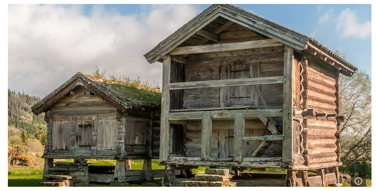

Iceverge Posted April 1, 2022 Posted April 1, 2022 I would argue that utility and economy trump aesthetics for longevity. Stålekleivloftet storehouse in Norway, about 900 years old, in an area that gets about a meter of rainfall per year. A narrow pallet of proven materials, utmost respect for the weather, especially the rain, it keeps most of the water off and the rest can dry quickly. Plain shape and form, accurately constructed. Not burdensome to construct or maintain. I reckon it'll see 1000 years.
CharlieKLP Posted April 1, 2022 Posted April 1, 2022 1 hour ago, maxdavie said: 1. After Saveasteading pointed out the blockwork would sink, I've introduced a steel bracket that I think we can bolt back into the slab - the block can partially bear onto this. - See revised detail. 2. Maybe if I can reduce the depth of the stone a bit so there is no protruding ledge it will help......need to think this one over That’s super weird. I think there’s a reason we leave technical details to technicians! I do applaud you having a go, and I’m guessing you don’t need building regs because it’s permitted development, but I’d use standard details if I was doing this. Re architecture… A building doesn’t last 1000 years if it’s ugly and doesn’t work as a space, just sayin.
