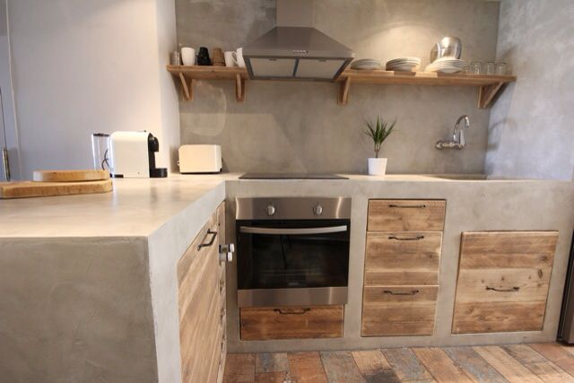

MarkH Posted May 9, 2017 Share Posted May 9, 2017 In our hunt for something that sits rightly(?) in our open plan house we chanced upon this style of kitchen: - and I'm considering the options as far as building something like it goes. We might not go quite as chunky as the above but the general idea feels like it might sit well in our house with our thick walls and heavy oak beams visible... Has anyone made something like this? Any thoughts on a good method of construction? Link to comment Share on other sites More sharing options...
Jeremy Harris Posted May 9, 2017 Share Posted May 9, 2017 A friend made a kitchen many years ago using brick, with timber doors and a timber worktop. Not to hard to build, and if you wanted a look like the one pictures then you could do something similar with rendered/plastered block, I should think. At the caving club I used to be a member of we cast very large work surfaces from concrete, just making up in-situ shuttering. Not too hard to do, there was more work making the shuttering than casting the concrete. It did suffer badly from staining, though, so the top and edges were eventually clad with stainless steel. Link to comment Share on other sites More sharing options...
Nickfromwales Posted May 9, 2017 Share Posted May 9, 2017 A table saw, some inch plywood, and some reasonable understanding of the jointing and spacing required and away to go. Rustic 'bark-still-visible' oak shelves and boards are readily available, even B&Q sell them, so you can mix reclaimed and bought materials to complete the look. How good are you with a saw and router? Link to comment Share on other sites More sharing options...
Ferdinand Posted May 9, 2017 Share Posted May 9, 2017 (edited) Have you determined your material? That is concrete done in situ. What about rendered or painted breeze block and a hunky-chunky wooden worktop? Londonerati would pay 10k for that. At least. Or get the counter from a defunct butcher in a right-on area for the worktop. We had one of those once. 4 big men put it in the small Simca van sticking out, and the only way we could unload it at home was to tie it to a tree and drive away. Or the slate from a snooker table (often 1" thick). My other favourite is stainless steel units from commercial kitchens (bankruptcy auctions). They have an industrial but glamorous look that is very attractive. F Edited May 9, 2017 by Ferdinand Link to comment Share on other sites More sharing options...
MarkH Posted May 9, 2017 Author Share Posted May 9, 2017 Thanks for the thoughts. Cast concrete seems overkill, ply maybe the opposite although inch thick would give solidity. Maybe rendered/painted blocks would be the one... 100mm might be too chunky though. 6 minutes ago, Nickfromwales said: Rustic 'bark-still-visible' oak shelves and boards are readily available, even B&Q sell them, so you can mix reclaimed and bought materials to complete the look. How good are you with a saw and router? When we cleared the plot there was a previously felled oak which we had slabbed down and which has been clamped and drying for 18 months now, it has great grain. We like wood but probably need to be careful we don't go wood-crazy. Link to comment Share on other sites More sharing options...
Jeremy Harris Posted May 9, 2017 Share Posted May 9, 2017 (edited) If you wanted thinner verticals than rendered block, then you could make up custom moulds from shuttering ply and cast reinforced concrete panels. With a bit of care you might well end up with a good enough finish to just paint. Many years ago I knew a bloke that made concrete staircases, at Devoran, in Cornwall. They used plate glass moulds to make stair treads that were as smooth as polished marble, very impressive to see, and showed how versatile concrete can be, given a bit of imagination. Concrete is a cheap way to do stuff like this, all the work is in making the moulds, which could be quite time consuming. You can fix concrete panels together by just drilling them and using something like inset anchor bolts, then filling over the bolt head recesses before the final finish. Edited May 9, 2017 by JSHarris Link to comment Share on other sites More sharing options...
Ferdinand Posted May 9, 2017 Share Posted May 9, 2017 (edited) I think if I was doing a "rustic + wood worktop" kitchen, the I would make sure the worktop overhang was 50mm+ to give me the opportunity to completely change the finish by putting something on top of the breezeblocks at least twice without demolishing it first. It would be wonderful to use your own oak, which I think would be OK (check) - get a man and a minimill in to plank it for you if it is large enough, or have someone take it away. Ferdinand Edited May 9, 2017 by Ferdinand Link to comment Share on other sites More sharing options...
Onoff Posted May 9, 2017 Share Posted May 9, 2017 Ply...use it as shuttering for the concrete! Link to comment Share on other sites More sharing options...
Nickfromwales Posted May 9, 2017 Share Posted May 9, 2017 2 hours ago, Nickfromwales said: A table saw, some inch plywood, and some reasonable understanding of the jointing and spacing required and away to go. Rustic 'bark-still-visible' oak shelves and boards are readily available, even B&Q sell them, so you can mix reclaimed and bought materials to complete the look. How good are you with a saw and router? That was reference to the framework not the finish . Stainless mesh or cement / render board atop to accept a cementitious product or even brick slips. Link to comment Share on other sites More sharing options...
MarkH Posted May 9, 2017 Author Share Posted May 9, 2017 2 hours ago, Ferdinand said: It would be wonderful to use your own oak, which I think would be OK (check) - get a man and a minimill in to plank it for you if it is large enough, or have someone take it away. It's already planked and been drying for a while. And really nice wood. Most of the tree was logged and left to rot by a previous owner, such a waste. Link to comment Share on other sites More sharing options...

MarkH Posted May 9, 2017 Author Share Posted May 9, 2017 I've been looking at bartop epoxy-based finishes for wood, I think they're food safe when properly cured and very tough. Link to comment Share on other sites More sharing options...
Nickfromwales Posted May 9, 2017 Share Posted May 9, 2017 The ply skeleton will make fixing things like drawer runners a breeze. Link to comment Share on other sites More sharing options...

Trw144 Posted May 9, 2017 Share Posted May 9, 2017 We had a concrete finished/effect table made - basically it's a skim coat on top of a wooden base. Looks to me how that kitchen has been made Link to comment Share on other sites More sharing options...

MarkH Posted May 9, 2017 Author Share Posted May 9, 2017 2 minutes ago, Trw144 said: We had a concrete finished/effect table made - basically it's a skim coat on top of a wooden base. Looks to me how that kitchen has been made Ok. Thanks. I might have to do an experimental cube or something. Link to comment Share on other sites More sharing options...
Onoff Posted May 9, 2017 Share Posted May 9, 2017 Has that not maybe been Venetian plastered? Can't really tell but it would look the dog's danglies! Not so sure it would be a good work surface though. Link to comment Share on other sites More sharing options...
Trw144 Posted May 9, 2017 Share Posted May 9, 2017 This is the guy .... https://www.houzz.co.uk/pro/danielpolishedconcrete/daniel-polished-concrete He will skim anything onsite for you - can't remember the exact price, something like £100 a m2. You can buy the stuff yourself if you fancy having a god yourself. Think it might be called Micro-Crete Link to comment Share on other sites More sharing options...
