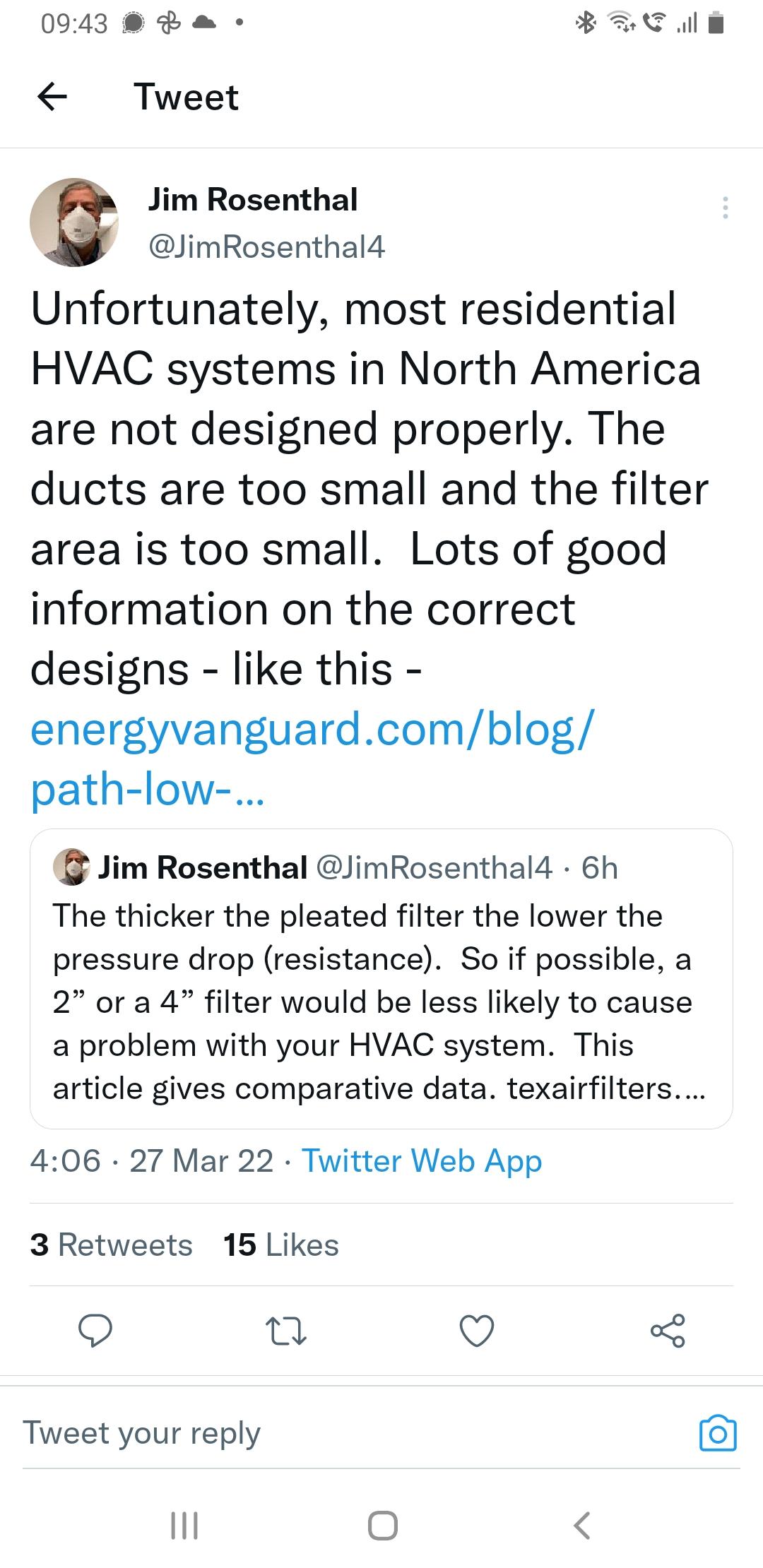

CalvinHobbes Posted March 27, 2022 Posted March 27, 2022 https://www.energyvanguard.com/blog/path-low-pressure-drop-across-high-merv-filter/

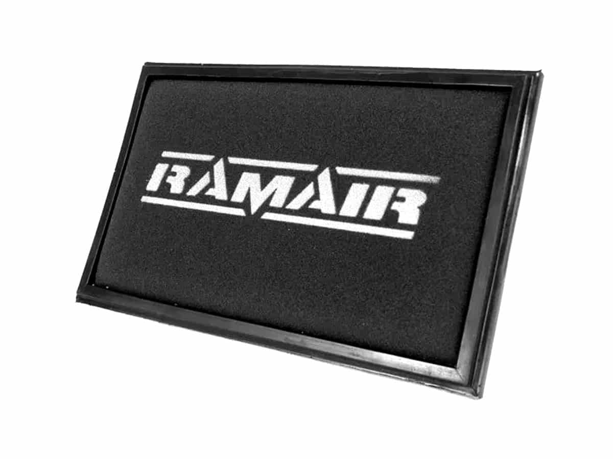

JohnMo Posted March 27, 2022 Posted March 27, 2022 Looks just the same as a car air filter and the filters in my MVHR. Pleating makes the filter area larger for a given foot print, not sure what's new in the article? Having a larger surface area allows a finer filter to be installed with a similar pressure drop to a lower performance flat filter. 2
SteamyTea Posted March 28, 2022 Posted March 28, 2022 (edited) Air filtration is not always about the pore size. High performance car filters have a very course mesh. This slows the airspeed (actually an acceleration in the negative direction), allowing fine particles to drop out of suspension. Very high performance air craft filters do the same but enhance it with centrifugal forces. Edited March 28, 2022 by SteamyTea

markc Posted April 1, 2022 Posted April 1, 2022 A lot of HVAC and dust extraction systems are poorly designed (if at all) and installed. filters can be too small or too large, air flows can be too low or too high. no use having a very fine filter with high air velocity as the small particles behave like bullets or shot blast material and destroy the filter as they hit it. 1
