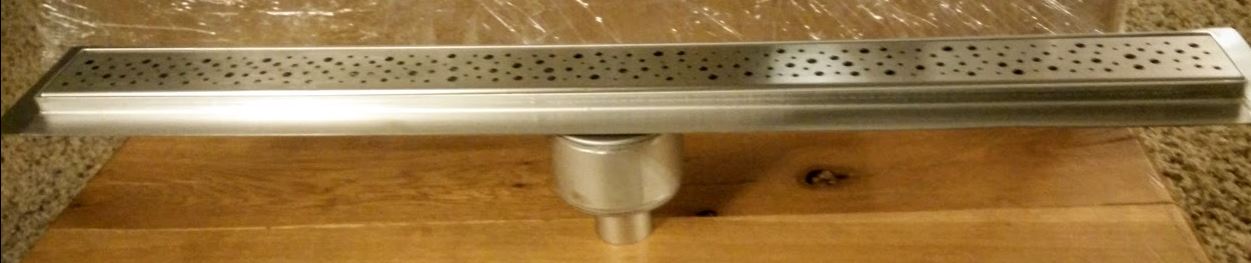

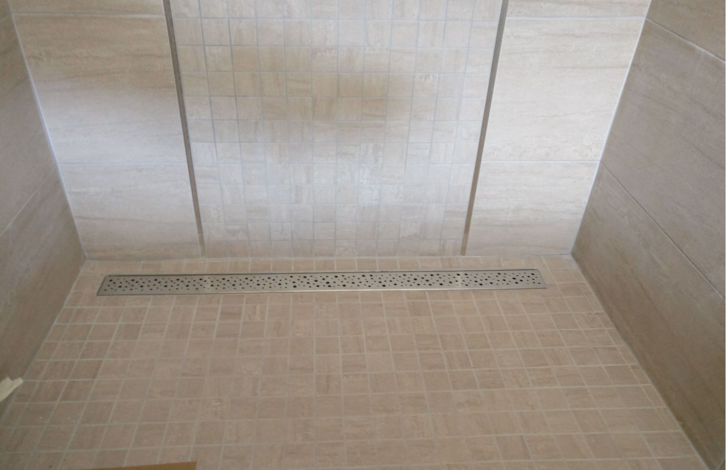

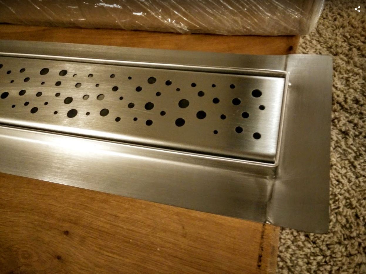

IanR Posted March 26, 2022 Share Posted March 26, 2022 (edited) 2 hours ago, ruggers said: Unlike a 110mm floor installed toilet soil pipe, you can generally adapt new toilets to always fit. Locking a shower waste into the floor screed, thats then fixed and any new shower tray replacement will require the exact same hole position in the tray. Im not sure they always match up between brands? I went with 110mm pipe coming up under the slab, directly to where I wanted the shower drain, but then used a 110mm to 50mm offset connector that allowed me to rotate the connector to get a +/-50mm tolerance in all directions. I didn't use a shower tray, just set a linear drain like this: into the slab, sloped the slab itself and tanked it before tiling I did all my showers the same. Edited March 26, 2022 by IanR 2 1 Link to comment Share on other sites More sharing options...

ruggers Posted March 29, 2022 Author Share Posted March 29, 2022 On 26/03/2022 at 11:54, IanR said: I went with 110mm pipe coming up under the slab, directly to where I wanted the shower drain, but then used a 110mm to 50mm offset connector that allowed me to rotate the connector to get a +/-50mm tolerance in all directions. Looks a really tidy job, did you have to add a U bend of some sort into this system or what was in place to prevent any smells coming back from the 110mm foul drain your connecting too since you opted not to use the shower trap onto the linear drain? @Onoff thanks, I think the geberit looks another good idea but with it being a small bathroom i need to keep the drain within a tray rather than a wet room style. Link to comment Share on other sites More sharing options...
IanR Posted March 29, 2022 Share Posted March 29, 2022 42 minutes ago, ruggers said: did you have to add a U bend of some sort into this system The linear drain has an integral bottle trap, so no U bend required. 1 Link to comment Share on other sites More sharing options...
