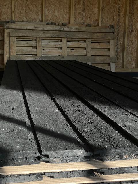

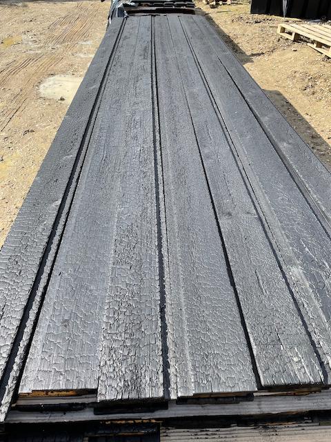

Thorfun Posted March 21, 2022 Posted March 21, 2022 35 minutes ago, Meabh said: We are now starting building warrants for our knock down rebuild on the East Coast of Scotland and need to decide what to build our house with... - We are building "fabric first" and working with a self build eco architect - We have 2 single story elements and 1 double story element - Our engineer has suggested a passive raft foundation (sandy soil plus fabric first) I always thought we'd use SIPS but quotes for superstructures are back and the ICF plus raft foundation is roughly the same price as SIPs without foundation!! Should we just go for the cheaper ICF route? Is there anything about it that would put you off using it? Many thanks lovely looking house! your black timber cladding.....what are you going for? we're having charred larch and has it delivered the last week. it looks stunning and we can't wait for it to be fitted!

Thorfun Posted March 21, 2022 Posted March 21, 2022 1 hour ago, Bitpipe said: Lovely. We need to replace our Parex render (MgO carrier board failed, not the Parex part) and are thinking of doing something completely different like dark vertical timber or equivalent composite. What is the per m2 cost of yours and is a regular joiner installing or a specialist? just a regular joiner (he did a friends Larch cladding and comes highly recommended and I've seen his work first hand so I know he'll do a good job). we had a huge amount, 230m2, and so we managed to get wholesale price which came in around £65/m2. so it's not cheap when you compare it to standard larch but it is cheaper than Western Red Cedar! at the moment though there is a shortage of Siberian Larch so you might want to hold off for a bit. 😉
Bitpipe Posted March 21, 2022 Posted March 21, 2022 54 minutes ago, Thorfun said: just a regular joiner (he did a friends Larch cladding and comes highly recommended and I've seen his work first hand so I know he'll do a good job). we had a huge amount, 230m2, and so we managed to get wholesale price which came in around £65/m2. so it's not cheap when you compare it to standard larch but it is cheaper than Western Red Cedar! at the moment though there is a shortage of Siberian Larch so you might want to hold off for a bit. 😉 Interesting - the composite board is only £16/m2 and I'd assume the cross batten material cost and overall labour cost would be equivalent (have you a grip on those yet?) By comparison my render cost is £70/m2 for batten + board and £78/m2 for the topcoat - all ex VAT.
Thorfun Posted March 21, 2022 Posted March 21, 2022 1 hour ago, Bitpipe said: Interesting - the composite board is only £16/m2 and I'd assume the cross batten material cost and overall labour cost would be equivalent (have you a grip on those yet?) By comparison my render cost is £70/m2 for batten + board and £78/m2 for the topcoat - all ex VAT. our batten costs are high as we're having vertical cladding so need counter battens and they are 50mm x 50mm battens to allow room for the external blinds. all in all our timber cladding will be a very expensive item but it should be amazing!
Thorfun Posted March 21, 2022 Posted March 21, 2022 (edited) 1 hour ago, Bitpipe said: Interesting - the composite board is only £16/m2 and I'd assume the cross batten material cost and overall labour cost would be equivalent (have you a grip on those yet?) By comparison my render cost is £70/m2 for batten + board and £78/m2 for the topcoat - all ex VAT. btw, we're also having areas of standard Siberian larch which came in at around £45/m2 for comparison. and the prices I've mentioned are not including labour Edited March 21, 2022 by Thorfun
