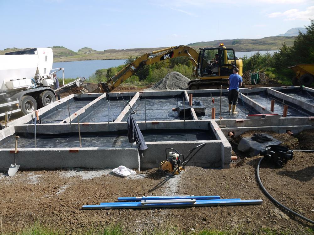

Thedreamer Posted March 22, 2022 Posted March 22, 2022 5 hours ago, Nickfromwales said: OK. Another for the ducted air under the suspended floor. I take it the regs require a continuous pipe / air duct from outside the foundation / house perimeter? So, are you not allowed to just drop a dip pipe under a cold-ventilated block and beam foundation? @saveasteading ? @ProDave ? The stove blockwork is the small square in the middle. The pipe just ends at that point under that section of the timber floor. I have heavy concrete blocks that surround my stove hence the reason for it's own foundation. All I can say is that the approach works well for our home, another winter done and electricity heating bill is less than a fiver. My floor has PIR insulation (this would be flammable!) but then a layer of glasswool and chipboard less flamable. I guess in the event of fire I would have smoke coming out of my airbricks. 🙂 1
Nickfromwales Posted March 22, 2022 Posted March 22, 2022 1 minute ago, Thedreamer said: The stove blockwork is the small square in the middle. The pipe just ends at that point under that section of the timber floor. I have heavy concrete blocks that surround my stove hence the reason for it's own foundation. All I can say is that the approach works well for our home, another winter done and electricity heating bill is less than a fiver. My floor has PIR insulation (this would be flammable!) but then a layer of glasswool and chipboard less flamable. I guess in the event of fire I would have smoke coming out of my airbricks. 🙂 Block & beam atop those piers?
