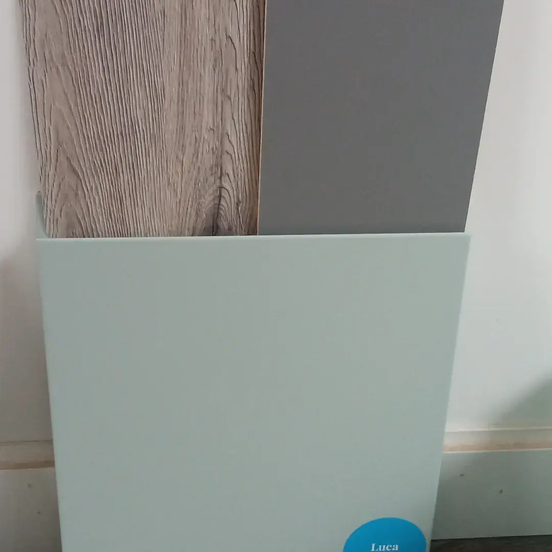

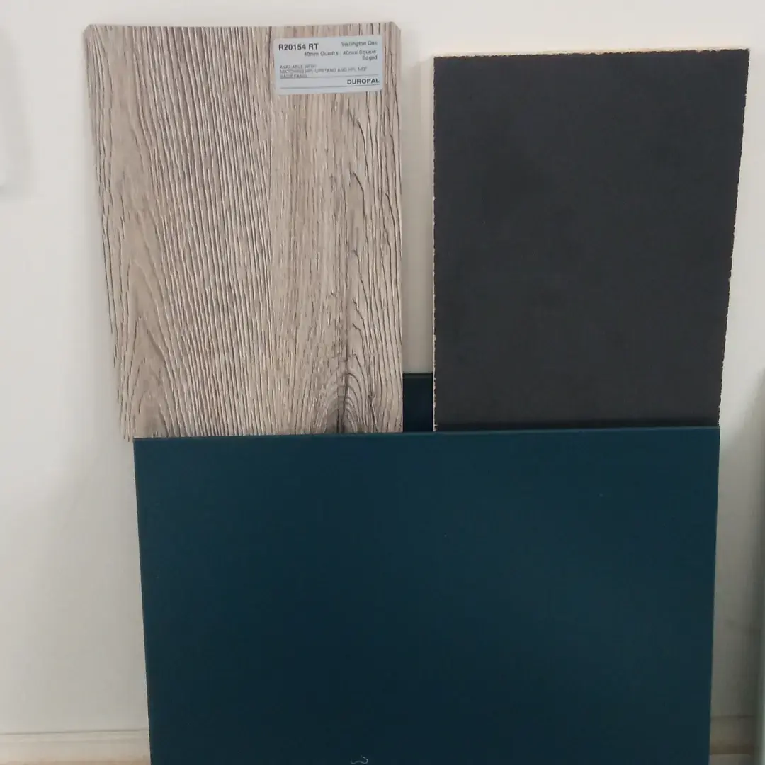

And now, colours. The dresser has some open shelves so the carcass colour will be visible on these open shelves (bookcase like).
The design is based on a dark blue and we were sort of set on that but the carcass colour can't be blue and they recommended the graphite (very dark grey). The room isn't that big (2180*3630) and the floor is pretty close to the worktop colour (a grey/brown wood LVT). The walls are and will be staying white. (There is another base cupboard on the left hand of the plan and window you just can't see it) as it's hard for me to rotate and crop it).
Screenshot_2022-03-02-09-28-37-939_com.microsoft.office.outlook.jpg.9f95d3bcaf76cd634209f977f500defd.jpg
And to now throw two options into mix:

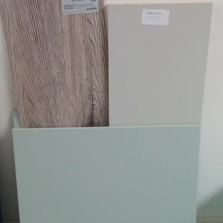

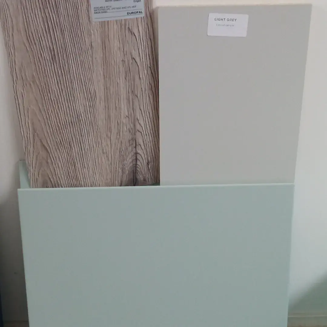

Option 2: Wood worktop, darker grey carcass and open shelves, cornflower blue doors.
Option 3: Wood worktop, lighter grey carcass and open shelves, cornflower blue doors. I don't know if this is a bit wishy washy with the light grey especially as our walls are white so if the open shelves will look a bit dirty.

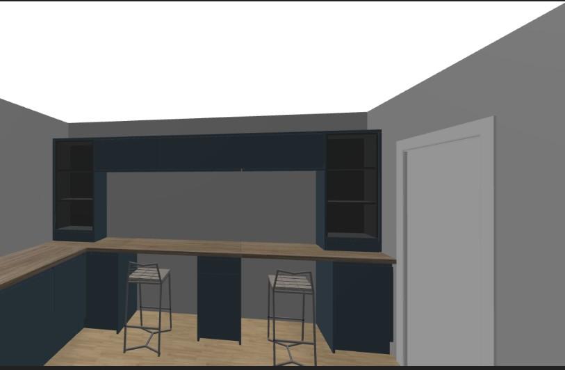

@canalsiderenovation are you planning on sitting on stools for your office setup? That is really not great from an ergonomic perspective. You really want a proper desk height (which I think is around 75), or a standing desk (which depending on height is around 110-116). Those stools look like they are up against a 90-93 kitchen counter, which is really just not going to be comfortable at all.

No, we won't have stools DIY kitchens put them on as an asthetic finish! They are using reduced height base units of 575 plus 100 legs (adjustable) so the joiner can shave down the 150 plinth and 40 worktop = 71.5cm. Actually 75cm is more for people of 6ft + high. We'd be more like 66cm ideally as we are both lacking in the height department! https://ergodesks.co.uk/blogs/news/what-height-should-my-desk-be
I measured the current desk (a cheap Argos one) and it's 71 high which is what we currently use (or the dining table which is marginally higher) so I think the base units will be fine.

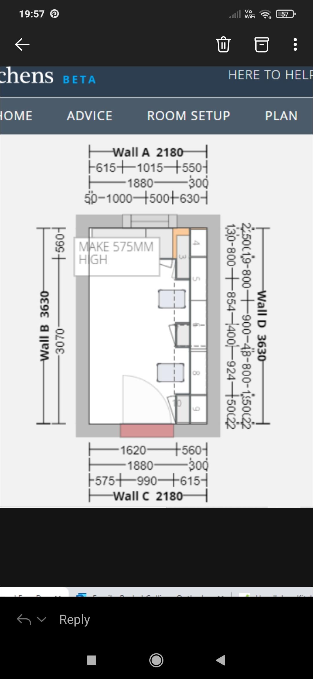

Here's the plan.
Screenshot_2022-03-11-19-57-10-943_com.microsoft.office.outlook.thumb.jpg.81be8a94a9e222d4795e29c3f3ca9a4e.jpg
The desk alcove for each will be more as we are changing the middle unit from 400 to 300 so I'd guess 900ish each. The middle one is for support of the worktop really. We would prefer not to have it but I think the 3630 worktop will need some sort of support. We both work from laptops and we will have the other length under the window of worktop if needed (my other half has long sheets of A4 plans paper so she frequently moves from a desk and lays them out along the kitchen worktop instead so that's why the extra worktop space under the window is useful)! We also need the storage below....
Interesting idea to use kitchen units for an office.
Will you find the 600mm deep worktops adequate?  My office desk is more like 800mm deep and I would not want it any less than that.
That all makes good sense. What Material worktop are you going for?

I think so, to be honest our current desk is 800mm and it's a pain as our plugs are on the wall (we had them put high rather than lower for practical reasons of having things on the desk) and I hate having to stretch over to try and reach them and both of us being small in height the 800mm does our head in!
Working with kitchen units has its limitations in the availability of unit designs but DIY kitchens have been amazing. Things like the corner one aren't available online at the reduced height but they are doing it for us. The units on the desk are dressers with the single drawer at the bottom and 300mm in depth but good for what we need and books etc.

We are trying to avoid it looking too kitcheny. I think we may go for Option 2.
