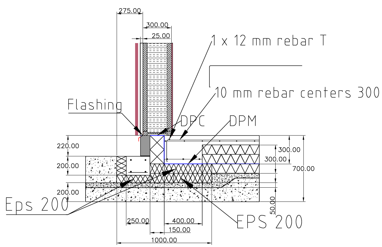

Iceverge Posted March 23, 2022 Share Posted March 23, 2022 I'm nearly converted, just the money hoarding miser on my shoulder needs to be convinced. I really fell down a rabbit hole in excitement last night! I've been scouring the internet for prices of I joists and the closest I could come to a definite answer was from the US, a 2*12 TJI is about twice the cost of dimensional lumber there. Any better guide this side of the Atlantic? How about the Egger DHF? A polish website suggested it was roughly similar to OSB, is that correct? Reading back I see you used a raft @IanR. Soil dependant, a strip foundation is still cheapest near me. There's no reason an I joist/beam wall couldn't overhang a hefty upstand to the floor slab creating a superb wall floor detail with a strip foundation. How much faff is there is sealing the external woodfiber board, is it a no go in wet and windy conditions? Did you have any issues with the dense pack cellulose billowing out the plasterboard? Apart from the foil backing was there anything special about the plasterboard, was it a double layer or extra thick? Did you skim over the patched up cellulose holes or tape and joint? Any tips on doing this speedily as it would seem to be more difficult than just taping an airtight membrane. I'm aware I've queried some of this before. Thanks for you indulgence! Link to comment Share on other sites More sharing options...

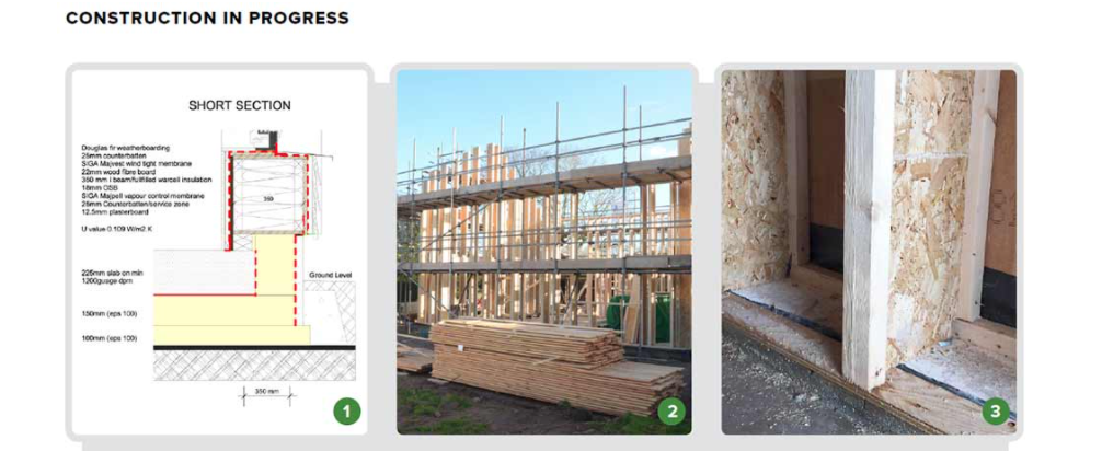

Iceverge Posted March 24, 2022 Share Posted March 24, 2022 6 hours ago, IanR said: If you went this route, Our house is built, from hundreds of tonnes of concrete, oh if I had my time again. Hopefully I'll gather the cash for some other smaller projects in the future though. 6 hours ago, IanR said: I've only ever seen both flanges of the I-Joist supported when used for wall framing. When you say "overhang an upstand" does that mean the outboard flange being unsupported, or sitting on insulation? I don't believe you could do that. https://passivehouseplus.ie/magazine/new-build/the-west-midlands-eco-house-with-no-energy-bills Thanks for your reply. I'll keep pondering. Link to comment Share on other sites More sharing options...
IanR Posted March 24, 2022 Share Posted March 24, 2022 7 hours ago, Iceverge said: https://passivehouseplus.ie/magazine/new-build/the-west-midlands-eco-house-with-no-energy-bills Is that really an EPS upstand? Does look like it is performing at the same level as the EPS under the slab. It doesn't look like it would work (to me), but if that's a true reflection of the built house then my views on the structural capability of I-Joists are too conservative. I'd like to see their internal plaster after a coupe of years and see if there's much cracking from any settling of the frame. Link to comment Share on other sites More sharing options...
Iceverge Posted March 24, 2022 Share Posted March 24, 2022 6 hours ago, IanR said: Is that really an EPS upstand? Looks like it. 6 hours ago, IanR said: I'd like to see their internal plaster after a coupe of years True. Link to comment Share on other sites More sharing options...
TerryE Posted March 24, 2022 Share Posted March 24, 2022 9 hours ago, IanR said: It doesn't look like it would work (to me), but if that's a true reflection of the built house then my views on the structural capability of I-Joists are too conservative. I'd like to see their internal plaster after a coupe of years and see if there's much cracking from any settling of the frame. Have a look at any of the MBC warmslab videos and you will see that they use a similar technique. It is extremely effective at stopping any material bridge at the floor TF junction. Typically EPS 300 is used for the last 60cm of the base and upstand. If you look you will see that the inner leaf of the Larson strut cassettes is the load bearing one and it is standing directly on the sole plate and warm slab, so isn't going anywhere soon. Link to comment Share on other sites More sharing options...
IanR Posted March 24, 2022 Share Posted March 24, 2022 7 minutes ago, TerryE said: Have a look at any of the MBC warmslab videos and you will see that they use a similar technique. Absolutely I'm familiar with typical twin-stud and Larsen truss wall build up, but MBC's twin stud uses 89 x 37 section size. As a typical framing section, it's logical the vertical loads can be carried through just one side of the twin-stud, allowing the other to overhang a non-loadbearing insulated upstand. For the I-Joist in the image, the flanges are 45 x 47, and finger-jointed. To my knowledge this isn't a typical framing section, and with the outer flange sitting over EPS 100, it's not going to be taking any load. For this reason, the detail I'm familiar with for a thermal bridge free slab detail with I-Joists is a little more complicated than required for a twin-stud and looks like this: A simpler, but not quite thermal bridge free detail is: Where the EPS L former width is reduced at the top to get the concrete slab under the outer flange, to support it. Don't get me wrong, I like the detail shown with the unsupported outer flange of the I-Joist, and an SE must have been happy to sign it off, but it doesn't follow I-Joist principles I'm familiar with. In fact, I needed to provide additional calcs for BC to convince them the outer ring-beam in the first image above could take the loads that would come through the outer flange, with "just" 100mm of EPS beneath. 1 Link to comment Share on other sites More sharing options...
