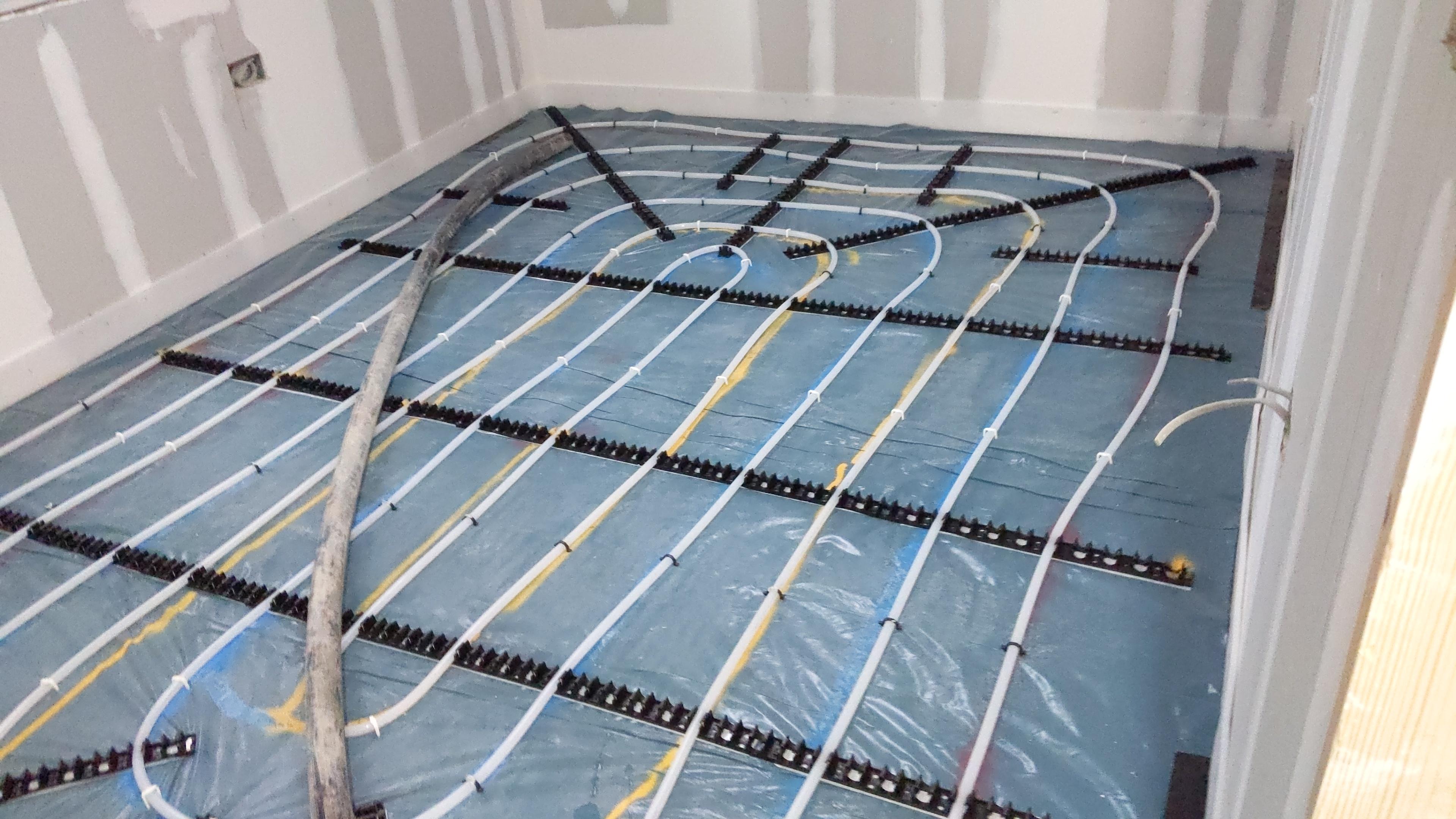

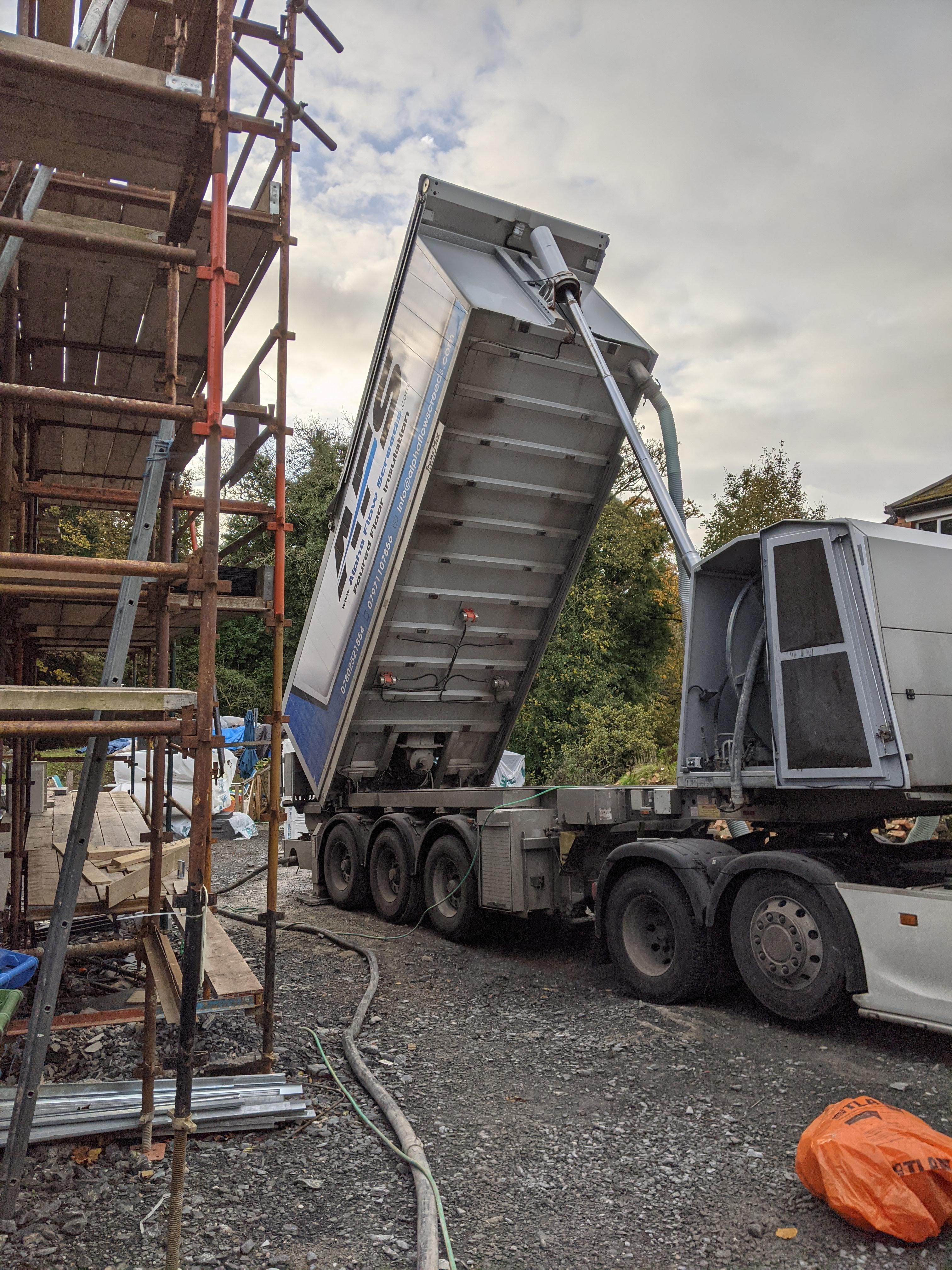

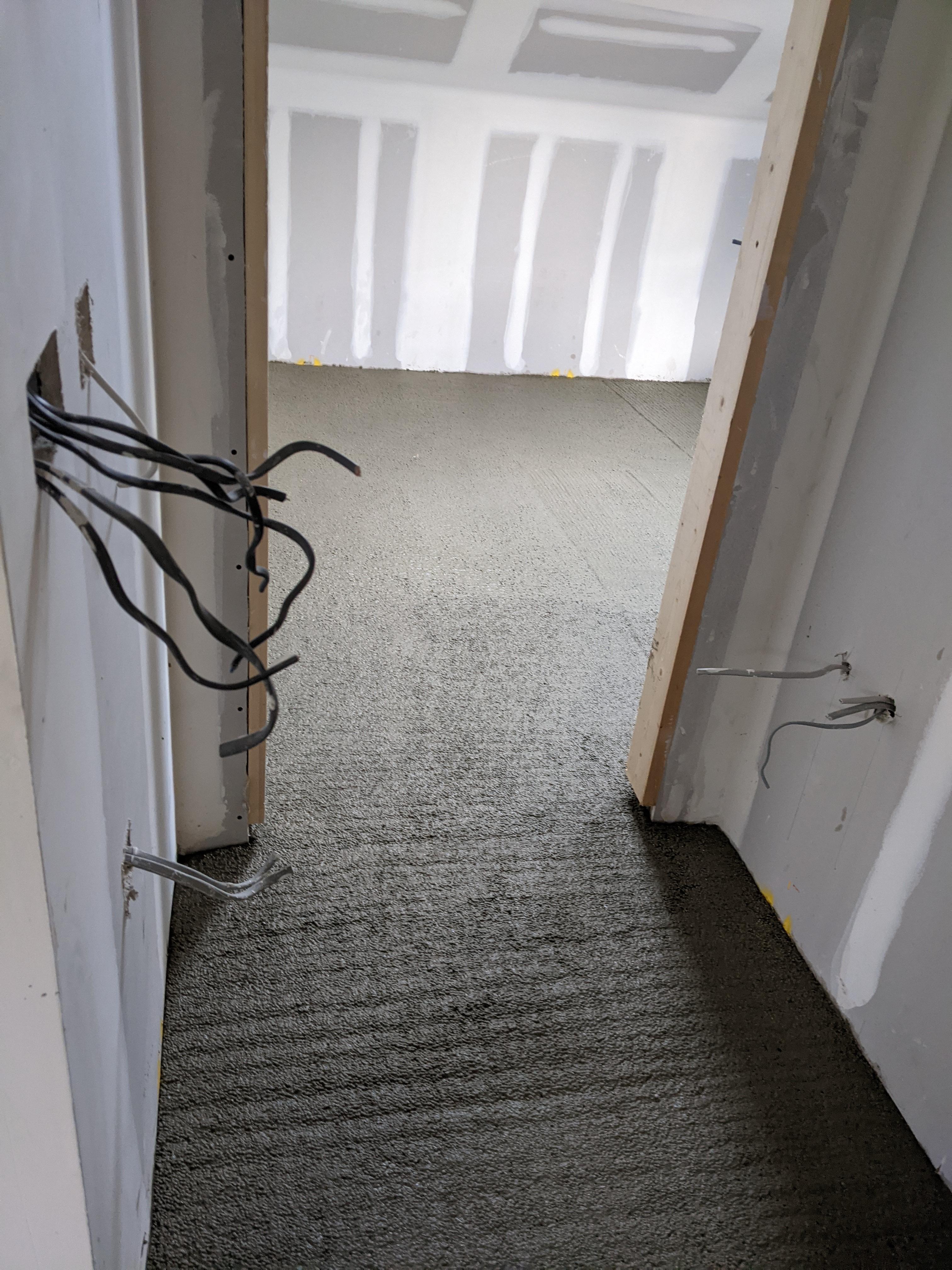

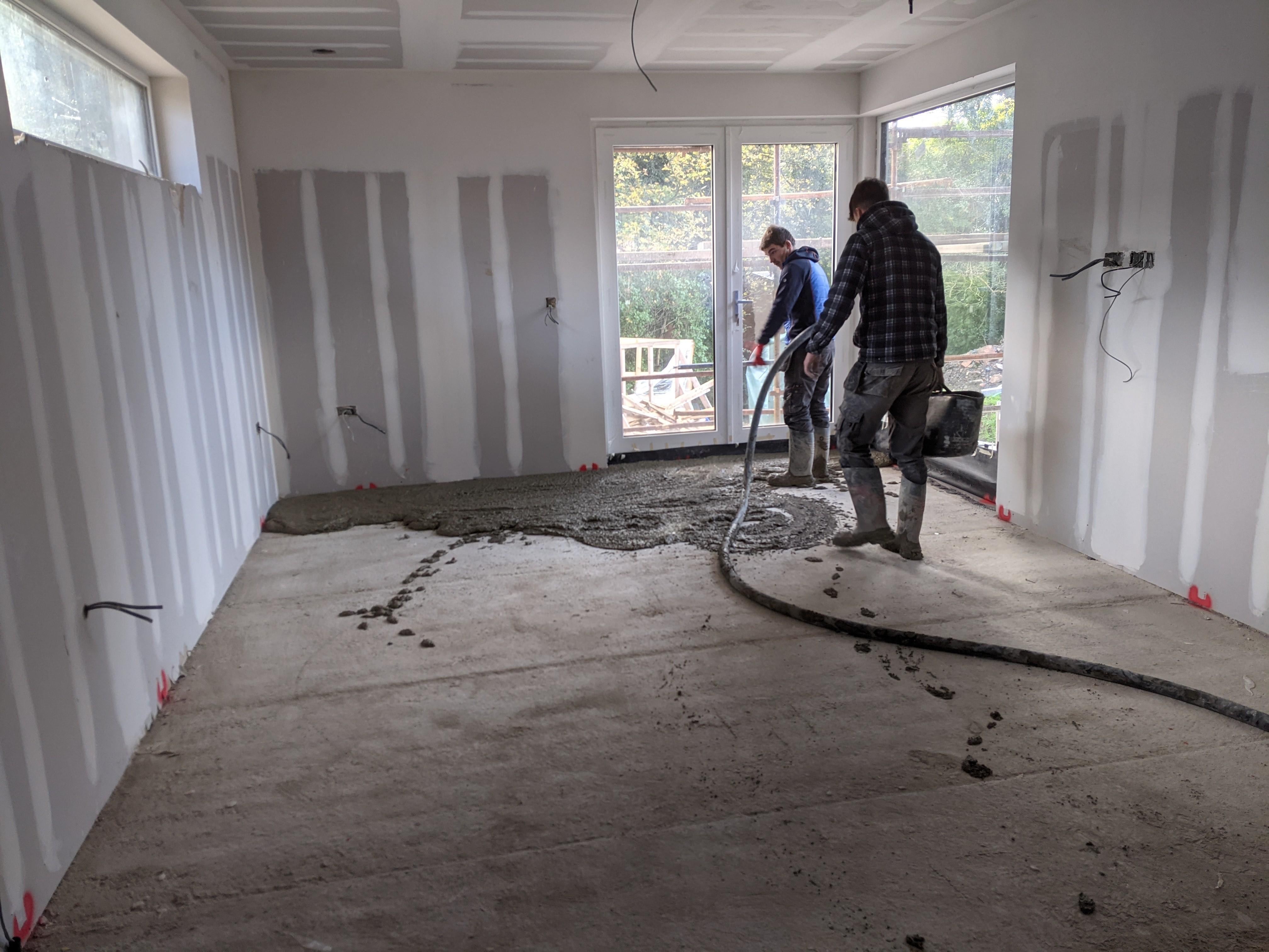

Conor Posted March 4, 2022 Share Posted March 4, 2022 (edited) 28 minutes ago, Thorfun said: what was under the polythene though? it had to be soft to take a UFH staple, right? Sorry, images in no particular order forst one is the pour of the final liquid screed on top of the TLA/polythene and UFH. The TLA. It's soft enough for about three days. After that, it gets a bit too hard to staple. The TLA goes straight onto the slab. Edited March 4, 2022 by Conor Link to comment Share on other sites More sharing options...
Thorfun Posted March 4, 2022 Share Posted March 4, 2022 7 minutes ago, Conor said: Sorry, images in no particular order forst one is the pour of the final liquid screed on top of the TLA/polythene and UFH. The TLA. It's soft enough for about three days. After that, it gets a bit too hard to staple. The TLA goes straight onto the slab. ahh...right got it. so TLA is poured then you staple the UFH pipes to that before it goes off and then finished off with a liquid screed. how did the TLA compare price wise to using EPS? I get the feeling it'll be more expensive but quicker (as is the norm with these things) Link to comment Share on other sites More sharing options...
Conor Posted March 4, 2022 Share Posted March 4, 2022 4 minutes ago, Thorfun said: ahh...right got it. so TLA is poured then you staple the UFH pipes to that before it goes off and then finished off with a liquid screed. how did the TLA compare price wise to using EPS? I get the feeling it'll be more expensive but quicker (as is the norm with these things) Works out double the cost of EPS, and about the same as PIR. We have 175m² to do, lots of steel beams and uneven slabs. Would have take ages to get right and didn't have much room for error. 1 Link to comment Share on other sites More sharing options...
Thorfun Posted March 4, 2022 Share Posted March 4, 2022 11 minutes ago, Conor said: Works out double the cost of EPS, and about the same as PIR. We have 175m² to do, lots of steel beams and uneven slabs. Would have take ages to get right and didn't have much room for error. we also have steel beams and slabs at different levels to the block and beam. I will investigate it as an option. Link to comment Share on other sites More sharing options...
