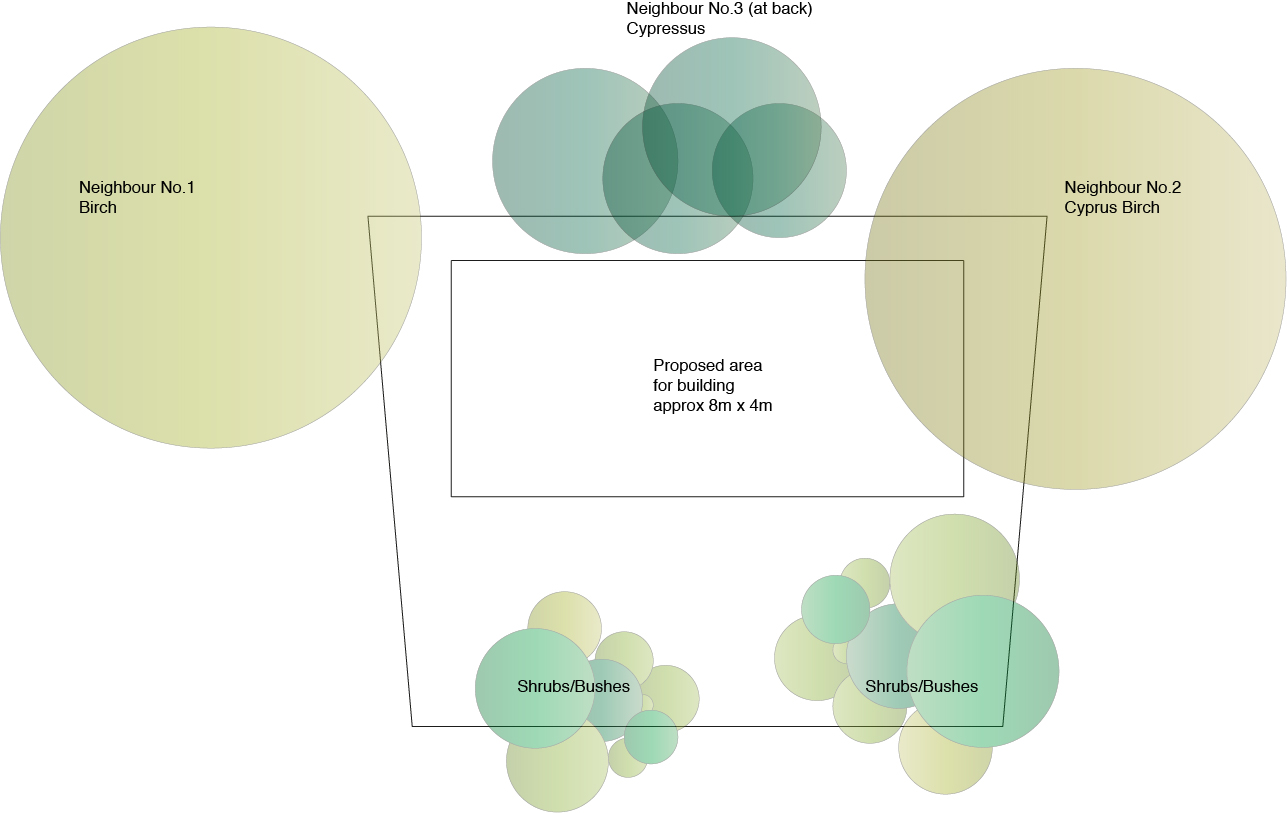

Invader75 Posted May 3, 2017 Author Share Posted May 3, 2017 Hi, thanks for the reply. It's going to be a granny annexe and separate from the house. This is a VERY quick rough look of the plot. I'd say the trees are the height of the house (1930's semi's) so fairly mature. Wondering if I need to contact a surveyor or a tree surgeon? Or, speak to neighbours first. Link to comment Share on other sites More sharing options...
Invader75 Posted May 3, 2017 Author Share Posted May 3, 2017 To add to this. We have a good relationship with neighbours either side. The one at the back is an old lady who seems to think the cypressus are lovely trees! They pretty much stop any light getting to the garden all year round. We're thinking obtain planning then deal with that problem as they're blocking out light. Link to comment Share on other sites More sharing options...
AliG Posted May 3, 2017 Share Posted May 3, 2017 The first people to contact are probably the planning department. There are lots of threads on here re planning, neighbours etc. The normal assumption is that people object to almost everything and talking to them isn't necessarily helpful. As long as you comply with local planning guidelines it shouldn't matter what neighbours say. If you live in a conservation area the trees will have more protection. The only real issue is going to be the neighbour 2's birch. The assumption is that roots normally extend as far as the canopy so you would possibly disturb the roots. You would either need a report on this or perhaps you could show that your build method doesn't disturb roots. As it's only one tree then you might get away with this. But it will be the planning department who decide. Link to comment Share on other sites More sharing options...

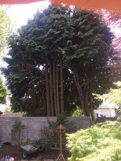

PeterW Posted May 3, 2017 Share Posted May 3, 2017 35 minutes ago, Invader75 said: No offence to that neighbour, but she's on her own and on her last legs to put it bluntly. We did ask for her gardener to cut them back a year or so a go but they trimmed a few branches and left it looking worse. They're pretty tall. Taller than a standard 30's semi. So they do sound like Leylandii - and as @JSHarris states you can ask for them to be removed or shortened. I've taken a lot out recently, to give you an idea I did some work based on a March 2015 tree survey that states 4-5m tall, and in August 2016 I took them out at 7-9m tall...... They will cause issues with normal foundations, the birch I wouldn't worry about as long as it is managed and hasn't got any serious joins or inclusions in the bottom 6m. Link to comment Share on other sites More sharing options...
Ferdinand Posted May 3, 2017 Share Posted May 3, 2017 2 hours ago, Invader75 said: No offence to that neighbour, but she's on her own and on her last legs to put it bluntly. We did ask for her gardener to cut them back a year or so a go but they trimmed a few branches and left it looking worse. They're pretty tall. Taller than a standard 30's semi. In that case I would suggest the key there is finding a way to get what you want which: a - Leaves your neighbour with what she wants. b - Doesn't involve her in work or organising. c - Doesn't cost her too much money. d - Leaves her garden looking acceptable or better. e - Probably doesn't put her gardener's nose out of joint. (Is he the best one to do the persuasion once you convince him?) You are best placed to decide how to achieve those conditions :-D ! (Added: Check carefully before taking the High Hedge Complaint route. Most Councils charge fees of hundreds just for making the application. It may be better to spend that cash on tree work or buttering up your neighbour.) F 1 Link to comment Share on other sites More sharing options...

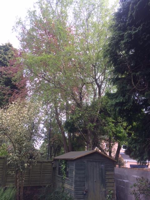

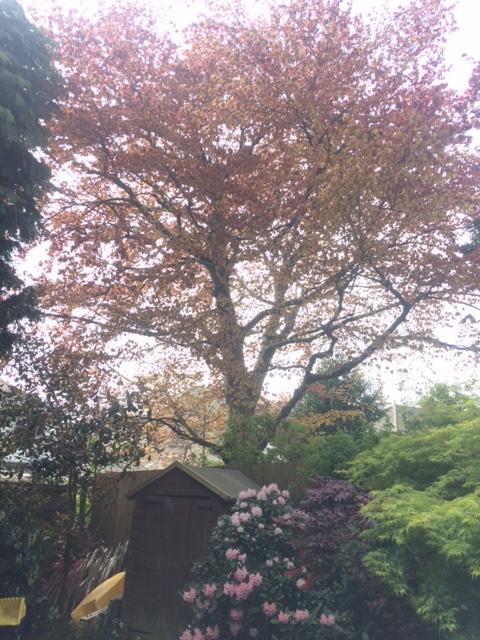

Invader75 Posted May 5, 2017 Author Share Posted May 5, 2017 Here's the offending tree/hedge. 0307 One's causing the issues. 0308 copper beach 0309 birch Link to comment Share on other sites More sharing options...
Jeremy Harris Posted May 5, 2017 Share Posted May 5, 2017 (edited) @PeterW will be better at identifying this than me, but that top one looks very much like Leylandii to me. It looks like some pretty dire trimming has taken place, too. Edited May 5, 2017 by JSHarris Link to comment Share on other sites More sharing options...
PeterW Posted May 5, 2017 Share Posted May 5, 2017 Right so that's a nice looking copper beech that needs a bit of a trim (lower two branches would lift the canopy nicely) , a youngish Silver Birch than has some growing to do .... ... and the tallest Leylandi hedge I've seen ..!! Whoever pruned those should be ashamed - you cannot prune them like that ..! They are a hedge though as the proximity of the trunks shows they were planted as such. What would worry me is the root mass - it will be a large intertwined mess that is probably only 12-18" deep but they have over balanced the trees. What is also concerning is they appear to have removed one side which will over balance the whole lot towards the other house - the group of 4 on the right is leaning and one is showing signs of failure now. Depending on your location, that is probably £7-900 of work to remove those but they need doing before they fall - they can't even be topped as there is noting left below 20ft.... 1 Link to comment Share on other sites More sharing options...
