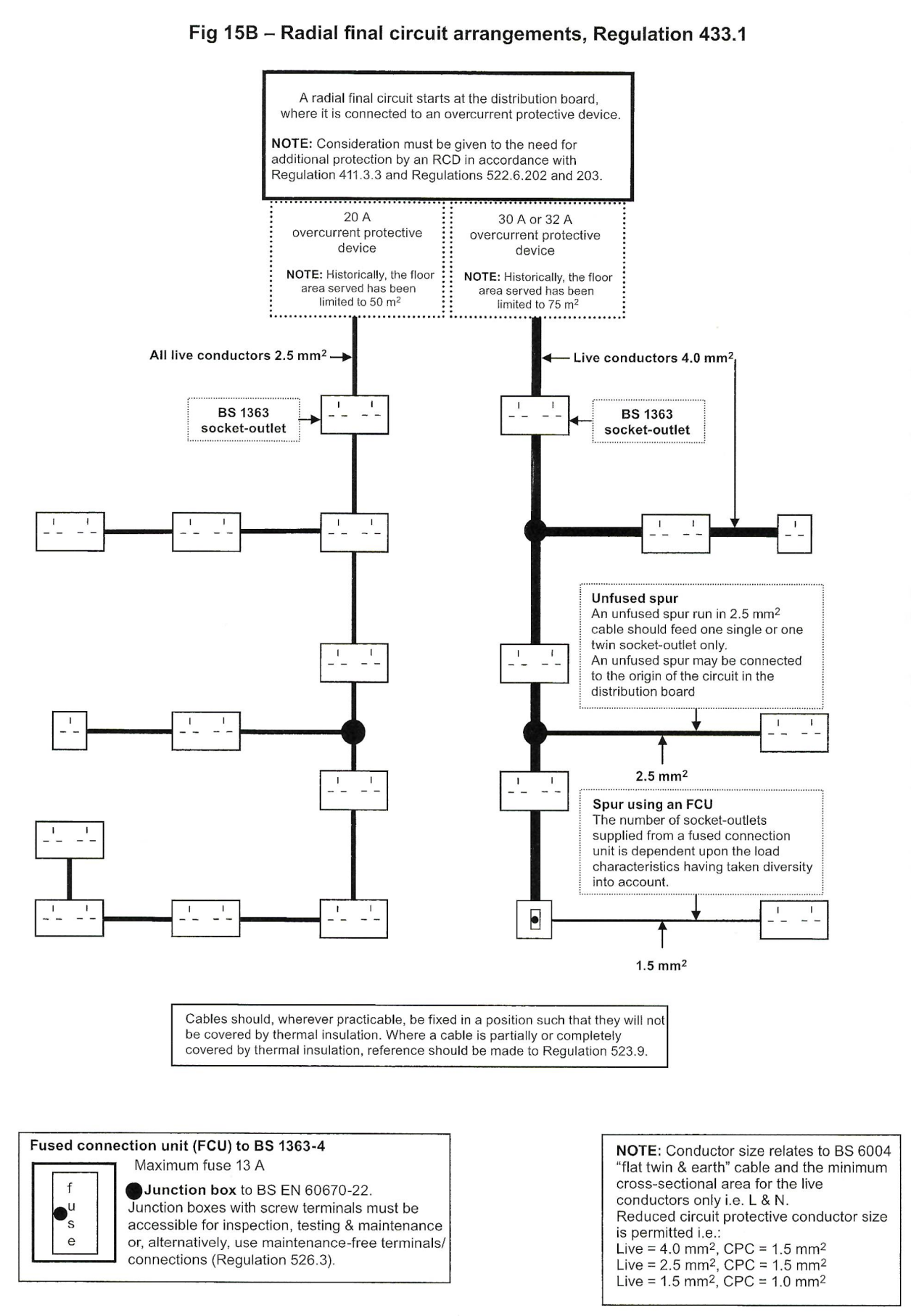

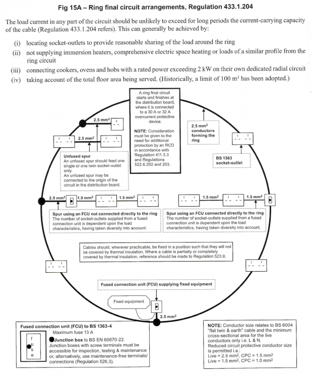

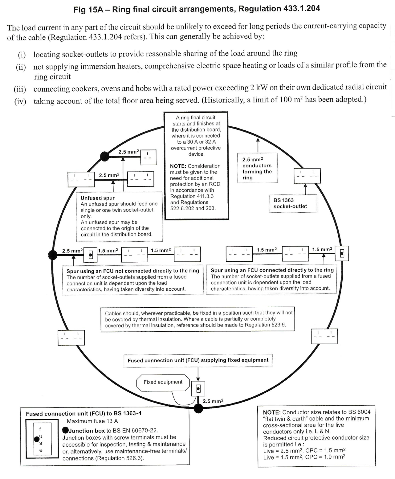

Rob99 Posted February 28, 2022 Share Posted February 28, 2022 These extracts from the wiring regs might help to explain.......... 1 Link to comment Share on other sites More sharing options...
Carrerahill Posted February 28, 2022 Share Posted February 28, 2022 (edited) 52 minutes ago, ash_scotland88 said: Can't quickly find the answer(s). I know you can't spur a spur, so to speak. But can a ring mains with a spur from a junction box be mixed with spurs from sockets? From memory it'll be no biggy to put into a socket now if it can't be, just there will be a junction box and join left in place as a negative. Adding more sockets to the study and will almost be a 1 spur per socket for ease for the sockets above desk height. I am struggling to work out what you are trying to do. When you say spur do you mean a spur leg of wiring or a fused spur? What you can do if you must create a spur with multiple sockets from a ring is fit a fused 13A spur then run a radial to as many sockets as you want, safe in the knowledge you cannot overload that cable. The reason you cannot spur off a spur is due to cable ratings, 32A ring main only works on 2.5mm cables because you have two of them, however if the circuit was a radial at 20A (which means the cable is then rated higher than the breaker) then you can actually create spurs from spurs because the whole thing is then only 20A. Edited February 28, 2022 by Carrerahill Link to comment Share on other sites More sharing options...
ash_scotland88 Posted February 28, 2022 Author Share Posted February 28, 2022 (edited) Excuse the links to websites, and appologies my terminology may not always be correct. So this is what is currently in place: https://flameport.com/electric/socket_outlet_circuits/ring_circuit_overview_spur_jb_T.png If I spur from socket with current set up then this would be the case: https://www.diydoctor.org.uk/project_images/spursocket/Spurs_from_ring_main.jpg?ezimgfmt=rs:298x143/rscb98/ng:webp/ngcb98 (but a few more spurs from sockets) What I was wondering if by having a spur from junction is there then limitations on the number of total spurs from sockets allowed? Or if by good practice the type (junction Vs socket) should be kept to only one type in a circuit? And there for best practice I should change the spur from junction to spur from socket Edited February 28, 2022 by ash_scotland88 Link to comment Share on other sites More sharing options...

TonyT Posted February 28, 2022 Share Posted February 28, 2022 If you change that double socket to a switched spur ,you can have unlimited socket outlets on it, as the switches spur will only allow you to pull 13 amp Link to comment Share on other sites More sharing options...
