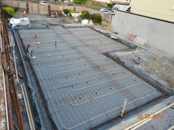

Buzz11 Posted February 27, 2022 Share Posted February 27, 2022 (edited) Thanks to the pioneers here that posted so much detail on their willis heater setup that I followed in their footsteps and so far so good! Especially @TerryE and @Jeremy Harris Like some previous posters & bloggers, I live in a low energy house (passive standard but not certified) which was built in late '14. For the first 6 years we've relied on a stove as our primary heat source backed up by 900w heater element in our MHV unit, however the arrival of 2 daughters has meant we require a slightly higher house temperature and the stove poses a risk to curious toddlers so best not to rely on that for routine heat. Luckily due the foresight of the builder, pex pipes were laid into the foundation so I went ahead and had a simple under floor heating 'arrangement' installed -- pretty much copying whats been posted here before. I've also attached photo of the pipe layout in the foundation and the drawing, I'm curious to see what people think. The system was installed last week and was set to 30° but this is actually working out at 23 to 25c (I presume the immersion thermostat isn't very accurate) After about 6hrs the heat was noticeable in the house and after 24hrs it was becoming a bit too much -- room temperature was climbing to 23c so I turn off the immersion during the day and now it just comes on at night (12 to 8am) I've read in various places online that UFH water temperature is typically 30 to 40c and I seem to be operating much lower that that, I presume due to the makup of the foundation (floor area is 125m²) At this early stage, I've a few questions that perhaps someone could give me their opinion on; 1. Do I need a manifold? The wavin gear looks pretty good in this video. I'd like to be able to monitor the flow & return temperatures so the gauges would be handy. 2. I now need a thermostat, just one will do the job since the ground floor is mainly open plan and the house has MHV so air movement is good. I'm considering the Google Nest, Which? gives it a good review. 3. When I've the thermostat operational, should it activate the pump and immersion together so they turn on/off at the same time or should the pump run a bit longer after the immersion turns off 4. So far, I've noticed the flow and return temperatures are very similar, I'd expected there to be differential of at least 5 or 10 degrees but I'm not seeing that. Thanks for reading. Edited February 28, 2022 by Buzz11 clarity Link to comment Share on other sites More sharing options...
MikeSharp01 Posted February 28, 2022 Share Posted February 28, 2022 Welcome to THE forum for people like us! What a deliciously simple setup you have installed and it sounds like the house overall works well. The amount of pipe in slab is quite low, some may say too low but the proof may be in some of the other things you tell us, but again that seems to be working if you can get the temperature up as you describe so all you need now is to get control of it. 1. It does not sound like you need a manifold but, see 4 below, you probably need to check the floor temperatures across the two zones to check they are even. 2. One stat will be fine, NEST is a good system but naturally it comes with the Big TECH downsides of privacy etc. You may need to control the water temperature at the Willis so you don't end up with the water temperature running away. This will control the air temperature - however you may also want / need to control the water temperature / slab temperature. 3. Cannot see a massive need for run on, what would that do or not do once the heat is off nothing will get any warmer. 4. Several things. A. The slab is at the water temperature (I think JS Harris had his at about 23) if that is even then all is well, sort of, you have the Willis water temp stat controlling the slab. B. The water is all flowing round the shortest loop and as it is so short it does not have the contact time to give up its heat to the slab - hence check the slab temps but you may improve things by playing with the pump speed. C. This may then lead to the need for a manifold to balance the two loops. All need you to find out how close the actual slab temperature is to the water temperature you are putting in and how the two zones are balanced (Some balancing might be achieved using the ball valves you have although this would be relatively crude. 2 Link to comment Share on other sites More sharing options...
JohnMo Posted February 28, 2022 Share Posted February 28, 2022 I would have thought the basics are 1. Simple manifold so you can flow balance, actuator of each loop, all wired to act as one, from single thermostat. A simple UFH wiring centre, that would manage the thermostat, actuators and pump, possibly a relay to manage the heater, using the wiring center CH signal. 2. Single simple thermostat, I'm using a Salus wq610rf, set to 0.25 hysteresis. £60. You can move it around the house to find the best location, before committing to holes in wall. 3. A mixing valve upstream of pump, to give you protection if the thermostat in the Willis heater fails. 4. Pre installed (spare) second heater, valved to be put online should the first unit fail. 2 Link to comment Share on other sites More sharing options...
Marvin Posted February 28, 2022 Share Posted February 28, 2022 (edited) Hi @Buzz11 You are doing so well, and the info @MikeSharp01 and @JohnMohas just supplied is so good, that I have little to add except about the builder adding Pex pipes during the slab construction, and that is you were really lucky! I would be very interested, once you control the temp a little better, to know how the slab temperarure feels from place to place as the pipes are alot further apart than a lot of designs. I wonder if the closeness of the pipes relates more to the speed of temperature rise rather than overall slab temperature. I wonder what floor coverings you have as well. Perhaps you will update further down the line. Marvin Edited February 28, 2022 by Marvin Add info 1 Link to comment Share on other sites More sharing options...

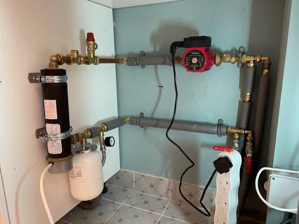

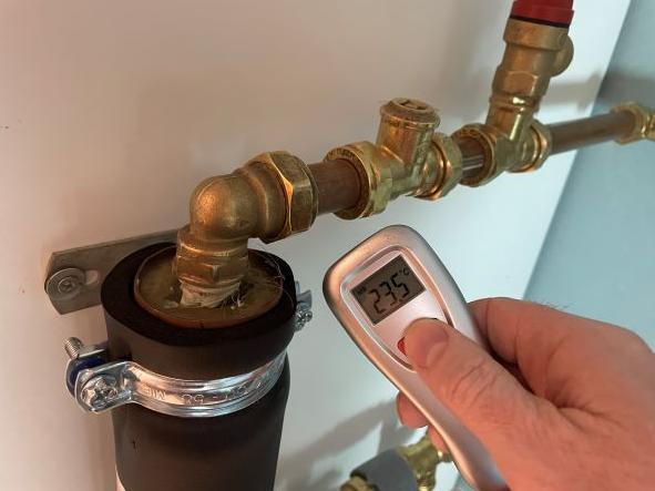

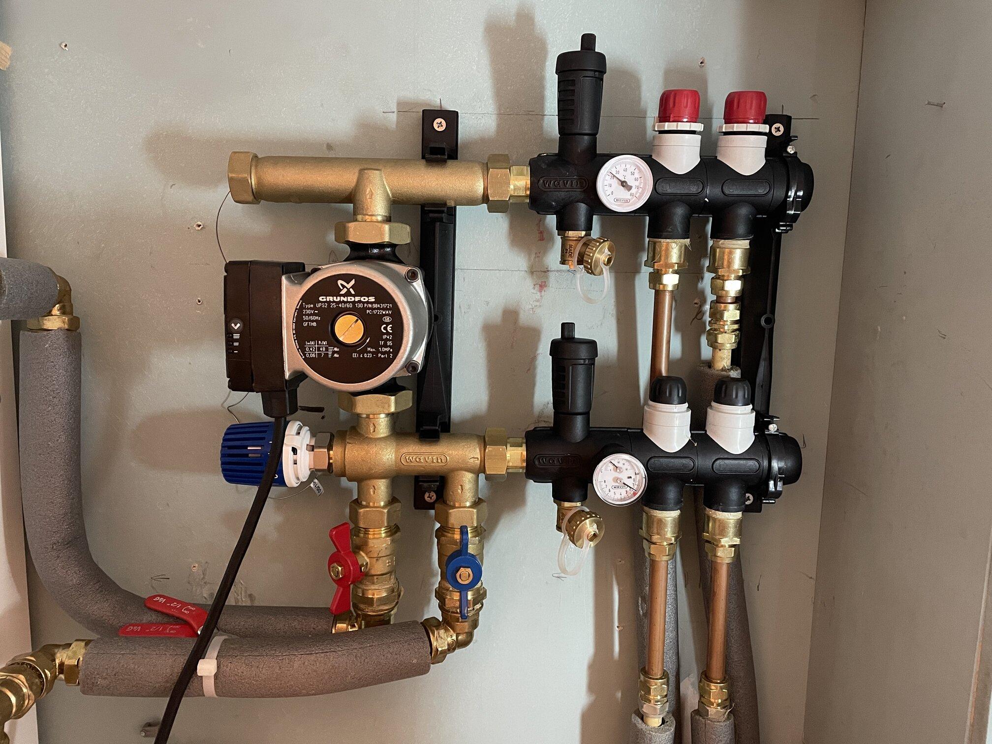

Buzz11 Posted September 2, 2022 Author Share Posted September 2, 2022 So my plumber has installed the manifold & pump and I've attached photo of the setup below. However I've immediately noticed that when the pump is running, its heating the water by its own operation -- theres no willis heater or any other water heater operating, just the pump alone. Its heating the circulation water by about 15C and its set to speed 1, is this normal? if so then I probably won't need any other water heater since its reaching the target temperature by itself. FTI; the volume of water in the underfloor pipes is very small, about 8L for each zone so total 16L. TIA Link to comment Share on other sites More sharing options...
