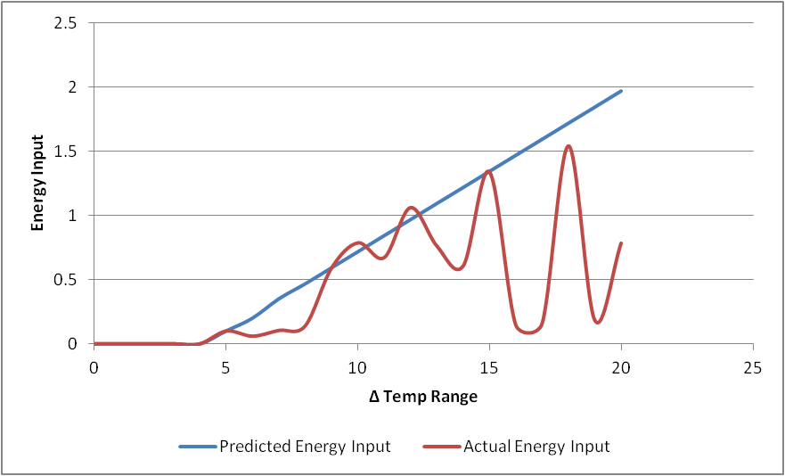

SteamyTea Posted February 20, 2022 Posted February 20, 2022 1 hour ago, TerryE said: So what you propose as the null hypothesis? A constant set-point? Was thinking more along the lines of deviation from binned prediction ranges. So something like this with made up numbers: Δ Temp Range Predicted Energy Input Actual Energy Input 0 0 0.0 1 0 0.0 2 0 0.0 3 0 0.0 4 0 0.0 5 0.1 0.1 6 0.2 0.1 7 0.4 0.1 8 0.5 0.1 9 0.6 0.6 10 0.7 0.8 11 0.8 0.7 12 1.0 1.1 13 1.1 0.8 14 1.2 0.6 15 1.3 1.3 16 1.5 0.1 17 1.6 0.2 18 1.7 1.5 19 1.8 0.2 20 2.0 0.8 Giving a chart like this Which give a Chi Square result of 0.985, when tested on values greater than 0. As it is greater then 0.05, then the null hypothesis is not rejected. Though that does not mean the hypothesis is correct of course.

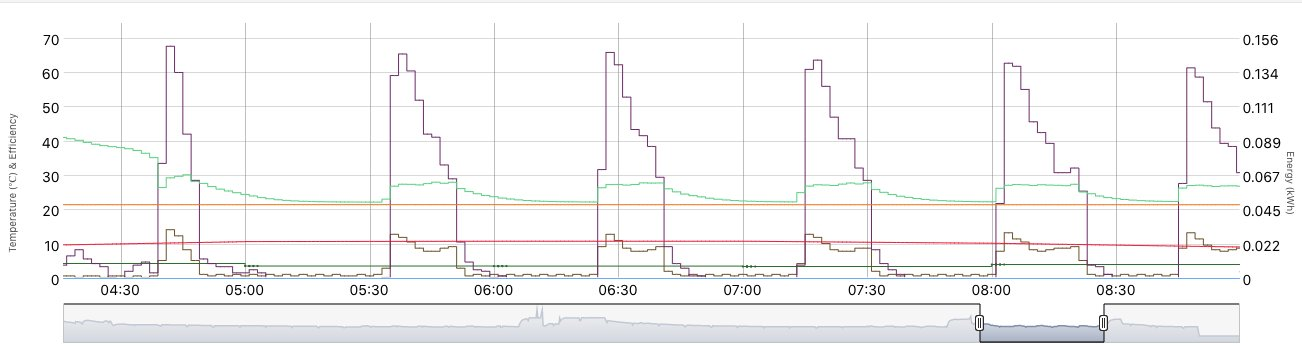

Dan F Posted February 20, 2022 Posted February 20, 2022 (edited) So i've been thinking about this too. I'm very interested in @TerryE's ideas, but am currenlty running things with the ASHP controller's weather compenastion to see how it behaves: This is what I've observed: - The Vaillant heat curve of 0.2 tells ASHP controller to use a flow temperature of 25C with the current external temperatur. - The power output by the UFH is a function of, not only the flow temperature, but also the pump speed though. Given the ASHP controller doesn't know anything about the pump speed, the heat curve required needs to be re-adjusted if the pump speed is changed. - Vaillant has various weather-compensation modes. The one I'm using considers internal temperature, but doesn't turn the heating off when a set-point is reached, but rather keeps running with a lower flow temperature. - In practice what happens is that the UFH pump runs continously with a mixer valve being adjusted by controller to maintain 25C UFH flow. The ASHP itself powers up every hour or so for 10-15mins and raises buffer temperature to around 28C, and then powers down. So whats the issues with this? Well, if you look at the supposed efficency of the ASHP for A7W35 it's 4.8. But, if I look at data from 6am to 6pm today, for example the actual COP is just 2.9. So it looks like leaving the system on all day and allow it to adjust temperature isn't particulalry efficient and, given UFH is in a passive slab, it would be more efficient to allow ASHP to run at a steady state for longer periods of time and then turn off the heating circuit. This requires either continuing to use weather compensation, but using the mode that turns off the heating when setpoint is reached, or moving to a differnt, probably externally controlled, heating strategy. EDIT: The energy figures on the right are kWh/2min. So ouput climbs to 4kW for 2-3min and then starts dropping off. Edited February 20, 2022 by Dan F 1
