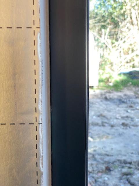

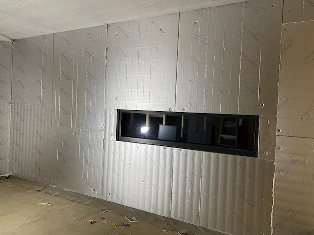

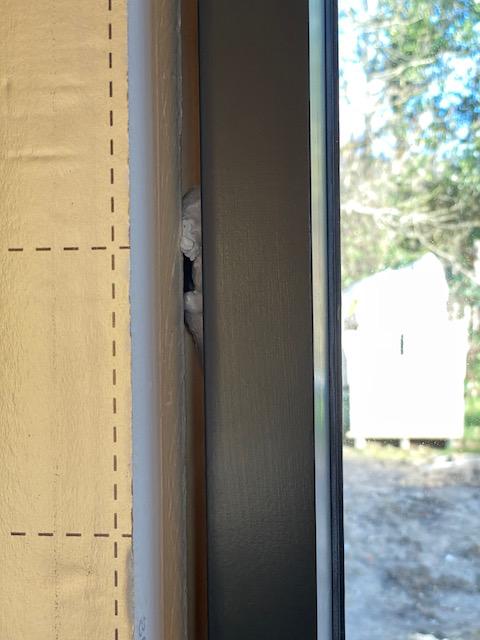

Thorfun Posted February 17, 2022 Posted February 17, 2022 Hi all, I'm not far off starting our internal PIR insulation and have a quick question as to what's the best way to install it against the windows, flush or a gap? e.g. Flush: a gap: obviously, flush reduces the cold bridge but after adding AVCL and tape and plasterboard and a skim would that take a stupid amount off the profile of the window? whereas by leaving a gap for the plasterboard to sit would allow more of the window frame profile to be visible. or is there a better way? or is it simply personal choice as to how much window frame you want showing? any advice is greatly appreciated.

Pocster Posted February 17, 2022 Posted February 17, 2022 28 minutes ago, Thorfun said: cheers. I thought it might come down to personal preference so I'll ask SWMBO. don't want to end up like @Adsibob and I presume it's ok to screw PB into the side of the PIR? it's not like it's going to split like screwing in to the end grain on wood? Your photo did confuse me . I couldn’t work out what the pb fixes too - couldn’t see any timber stud …

Mr Punter Posted February 17, 2022 Posted February 17, 2022 Do it flush. Foam the window first. The weak point is where the frame and wall meet and if you cover some of that with insulation it will help reduce the cold bridge. Protect the frame with tape and cut and remove it after plastering / painting. 1
Thorfun Posted February 17, 2022 Author Posted February 17, 2022 10 minutes ago, Chanmenie said: Yeah that’s what I was thinking can you actually just screw the plasterboard to the insulation ? yeah. sorry. on the front of the PIR will be AVCL and service cavity with battens. but I'm not sure about on the side? how does one attach plasterboard to the PIR there?
Pocster Posted February 17, 2022 Posted February 17, 2022 10 minutes ago, Chanmenie said: Yeah that’s what I was thinking can you actually just screw the plasterboard to the insulation ? You can glue pir to pb . But then is the pir glued to timber frame ???? Anything like this my pb is always screwed to timber ….
Pocster Posted February 17, 2022 Posted February 17, 2022 1 minute ago, Thorfun said: yeah. sorry. on the front of the PIR will be AVCL and service cavity with battens. but I'm not sure about on the side? how does one attach plasterboard to the PIR there? Really want a Batton on the window frame edge so pb can fix from there to corner batton .

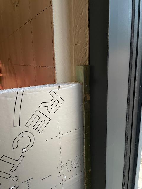

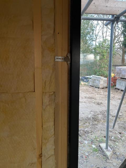

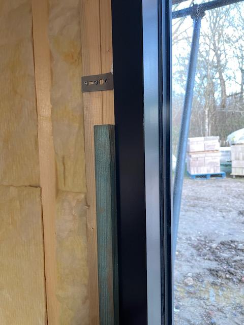

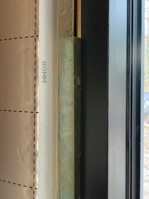

Thorfun Posted February 17, 2022 Author Posted February 17, 2022 14 minutes ago, pocster said: Really want a Batton on the window frame edge so pb can fix from there to corner batton . summin' like this? as is at the moment: with a 25mm x 50mm batten: with PIR: I could then add some 25mm PIR between that batten and the corner batten like this? 1
Thorfun Posted February 17, 2022 Author Posted February 17, 2022 still a bit of a cold bridge there though through the timber frame stud, into the batten and then in to the house. but I guess there'll be AVCL on top of that all anyway so I wonder how much of an impact that bridge will have

Thorfun Posted February 22, 2022 Author Posted February 22, 2022 ended up doing this room flush to the windows. tbh it wasn't a conscious decision I just realised that by the time I'd finished it I'd forgotten that I could've put battens! sorry @pocster. think I'll just do the same throughout now. save me a lot of time and faff adding extra battens especially as the majority of my windows are 2.1m high. 1
