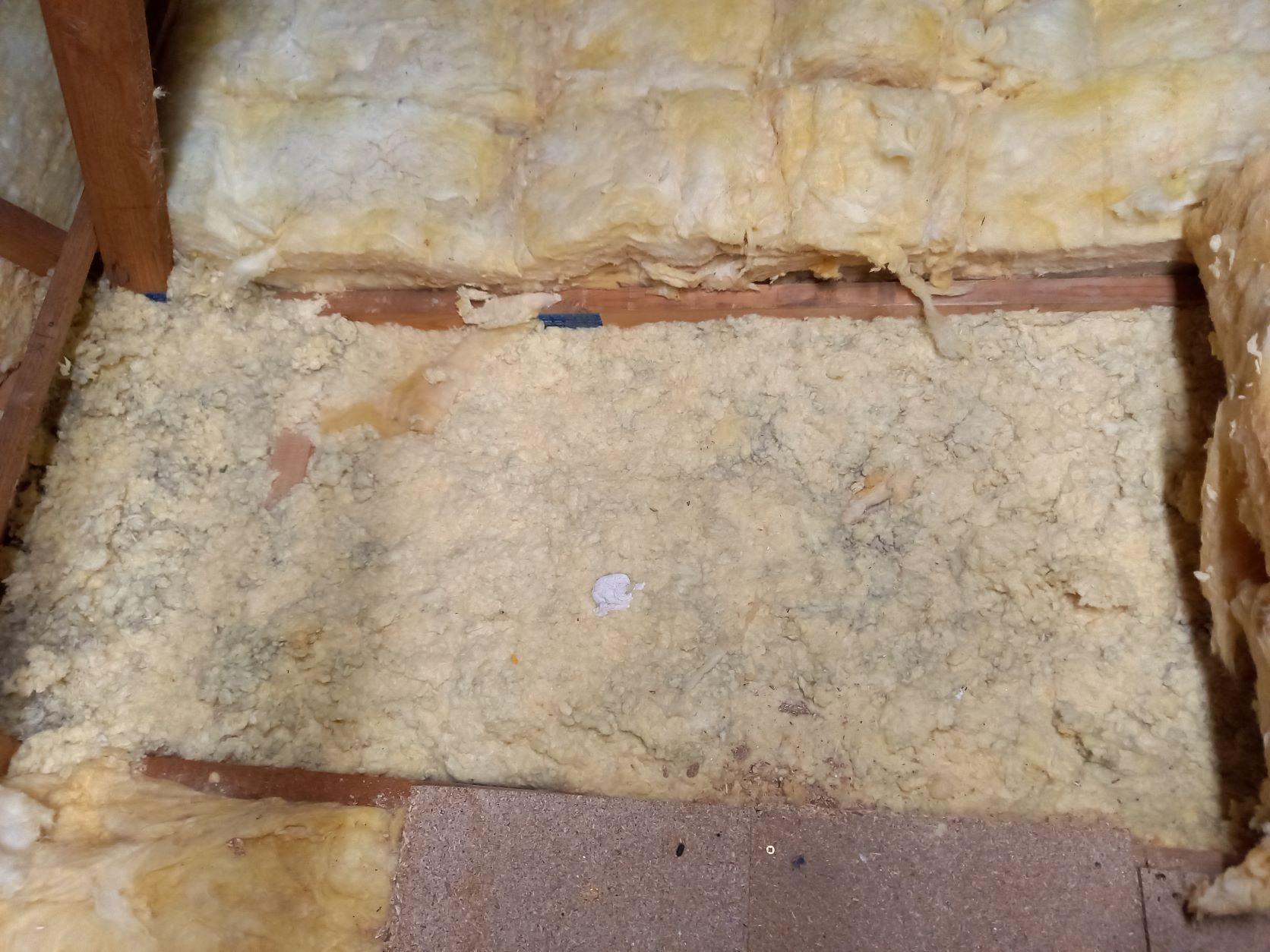

S2D2 Posted February 17, 2022 Posted February 17, 2022 Here's one that might cause a healthy debate, but I'm having trouble deciding so thought I'd offer it up to the experts. I'm about to board out our loft for light storage on XL Loft legs which leave a 300mm gap above the ceiling joists. The house was built in 1992, so the ceiling joists are only 70mm deep, giving a 370mm void for loft insulation. Currently we have two forms of loft insulation: the original loose fill fibreglass "filling" the 70mm joist depth and approx 170mm of newer (approx 8 years old) fibreglass insulation rolls installed before we moved in under one of the previous energy company schemes. The newer roll is generally in good condition, heavily compressed by the previous owner's loft boards in some places yet should be reusable. The debate I'm having is on whether to replace the loose fill fibreglass insulation which is now 30 years old with new fibreglass rolls. It is heavily compacted across the loft and probably has an average thickness now of ~30-40mm instead of the 70mm it should be filling which will obviously be impacting the R-value and allowing air currents between the two layers of insulation. My options as I see it are as follows: 1) Fluff it up as best as possible, get on with boarding the loft. Save a lot of faff and swearing in a low head height loft space. 2) Redistribute and fluff into half the area, fill the other half with new insulation. Old stuff presumably twice as dense after this, R-value reduced to..? 3) Get rid of all the loose fill and replace with new loft roll (100mm squashed slightly into 70mm, R-value reduced to..?). Sending it to landfill doesn't sit well with me but maybe freecycle could avoid that issue? After relaying the 170mm I'll add new 100mm roll which should give me 340mm insulation and a 30mm air gap below the chipboard, which I've heard some people recommend to avoid condensation issues under the chipboard. Our loft has had severe condensation issues in previous years but that appears to have been fixed by the addition of felt lap vents which have left it dry for a whole year now. To allay any concerns, I'm using a proper fitted/filtered mask, goggles and long clothing. Loose fill fibreglass is the devil when disturbed.

S2D2 Posted February 17, 2022 Author Posted February 17, 2022 (edited) Thanks all, leaning towards option 1 or 2 to avoid having to remove any. Here's a picture for reference showing the state of the old stuff, the visible side of the joist should of course be hidden by nice fluffy insulation. Not sure on the insulative properties of kitchen roll, have the previous owner to thank for that. New stuff laid in the same direction in the middle section for ease by the energy company's fitters, I'll correct this to make it perpendicular. I'm also curious on the waxed paper! Edited February 17, 2022 by S2D2

S2D2 Posted March 17, 2022 Author Posted March 17, 2022 (edited) As a follow up, I went with option 2, redistributing 50% of the flattened insulation into the other half of the loft and topping up the resultant gaps with new. Nothing to the tip or through the house which was a big win. Average insulation depth now 400mm and loads of storage up on the loft legs, which worked really well with P5 T&G chipboard sheets 2.4x0.6m. In case anyone else is doing something similar, I used a dustpan to scoop the old loose fill insulation and an old bread knife to cut the new rolled insulation, worked a treat. Fitted a couple of 1.5m batten LED lights before doing the job which made everything a lot easier, highly recommended. Edited March 17, 2022 by S2D2
