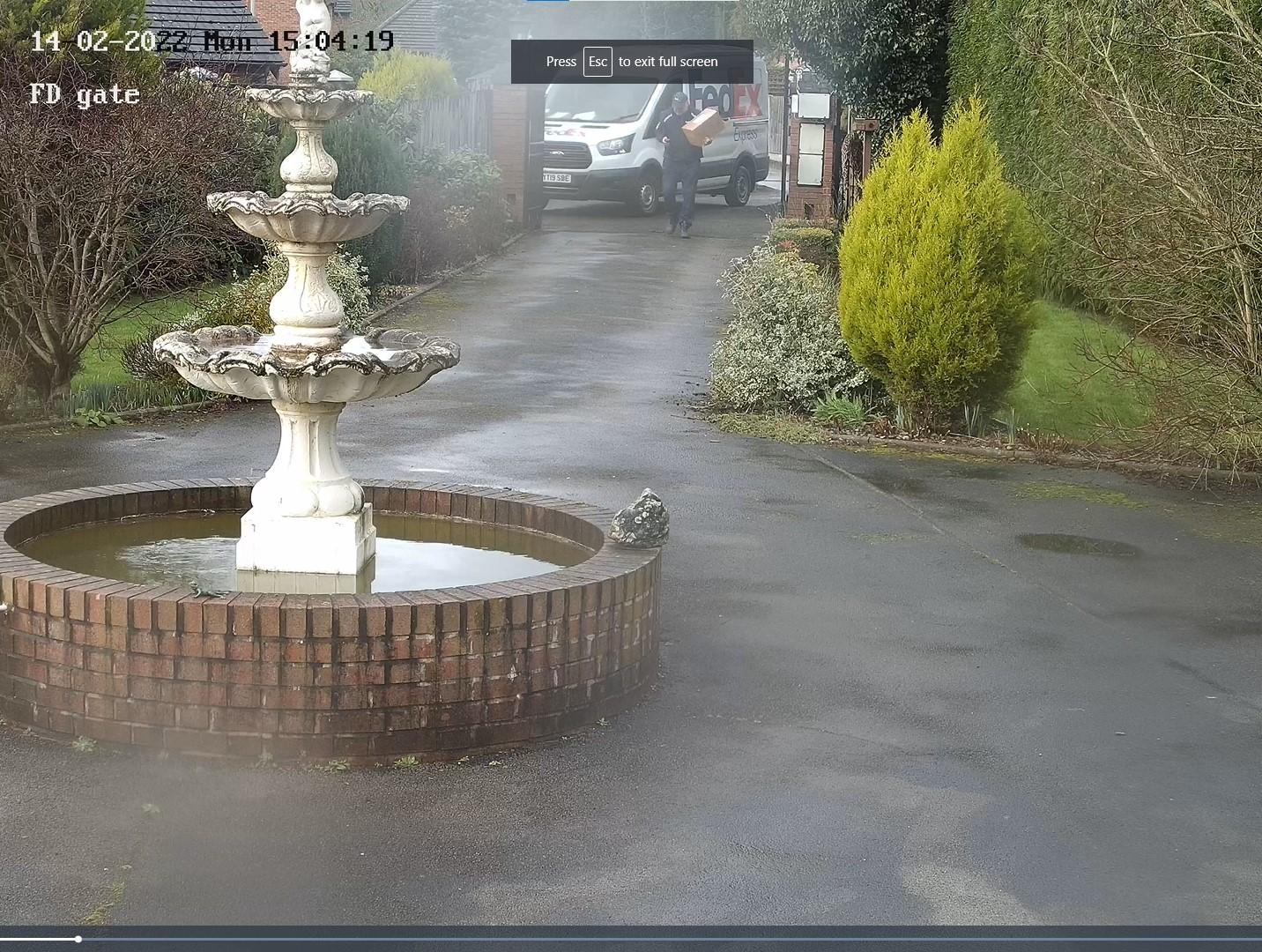

billt Posted February 14, 2022 Posted February 14, 2022 There's also a Hikvision DS-2CD2232-I5 looking back at the front door. 1
Pocster Posted February 14, 2022 Posted February 14, 2022 7 minutes ago, billt said: Front door camera You got a fountain in your front entrance?
billt Posted February 14, 2022 Posted February 14, 2022 Yes, it came with the house. It even works now! 1
Pocster Posted February 14, 2022 Posted February 14, 2022 Just now, billt said: Yes, it came with the house. It even works now! You are super posh 1

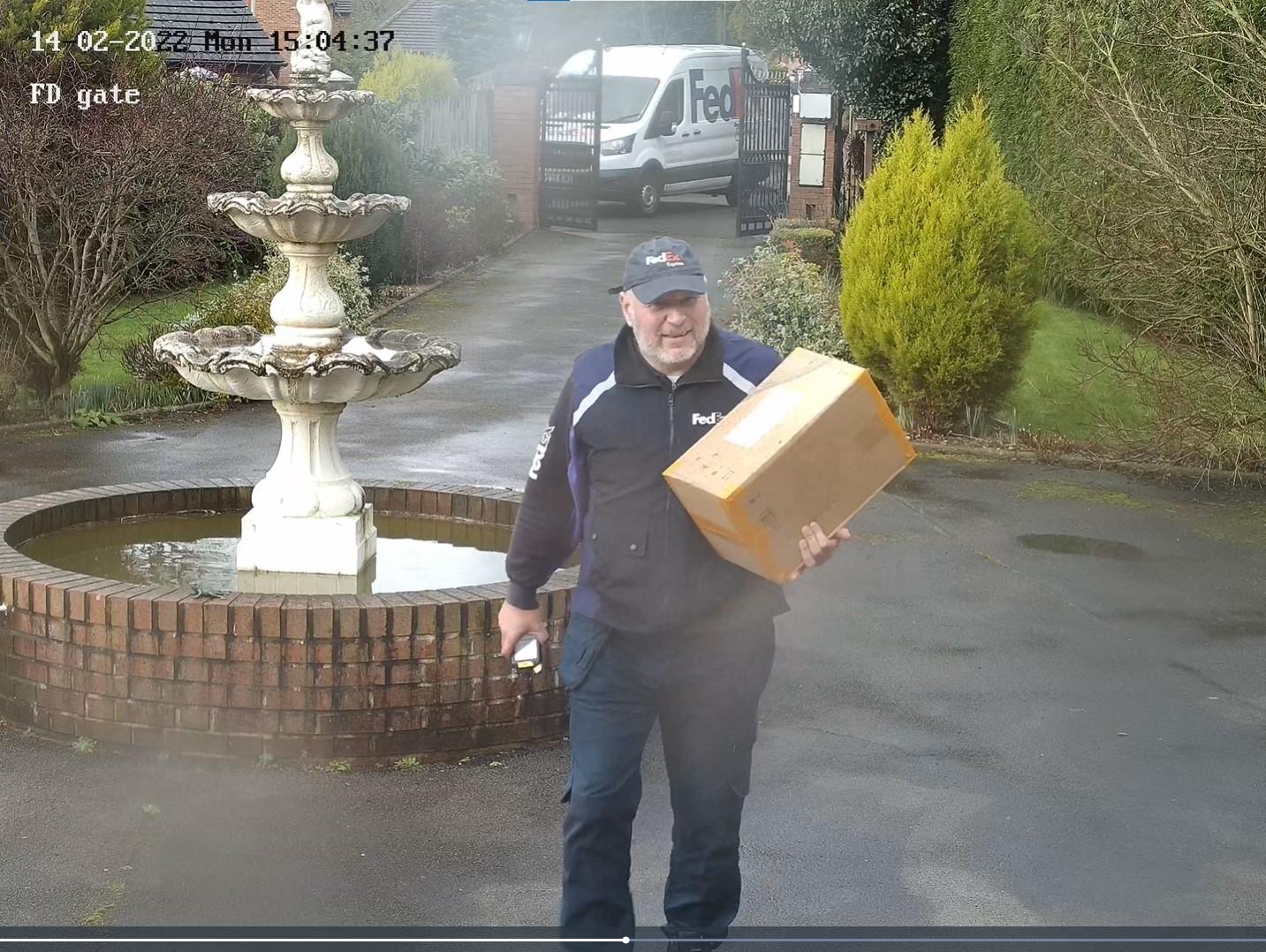

LnP Posted February 14, 2022 Posted February 14, 2022 I installed a Hikvision system as a lockdown project in my last house, 4 POE cameras with a network video recorder. I'm allergic to subscriptions which is why I chose a system with an NVR. The picture quality was fine, but I installed the cameras too high which meant I couldn't see people's faces well enough. I put the cameras about 3 m off the ground and they really need to be at face height, say no higher than 1.8 m. It didn't help that the ground floor was already about 800 mm above ground level and the camera I put over the front door looking down the driveway didn't get faces. They were easy to set up and I could view them over my phone, but remote viewing really only worked if I was connected to a good wifi. The cellular network was generally not good enough for the pictures to download. I'm not particularly techie though, so wouldn't be surprised if there are better systems out there.
