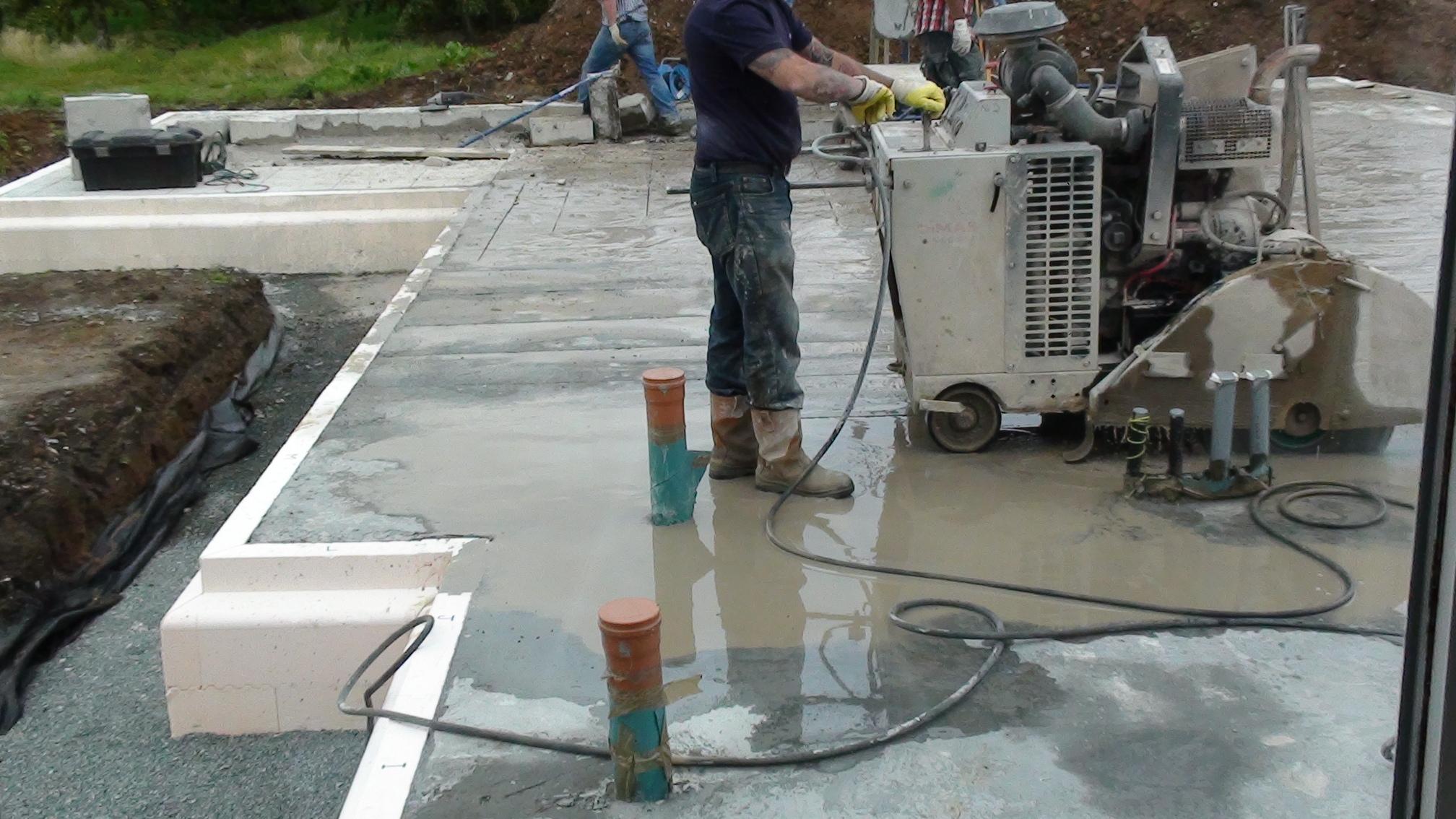

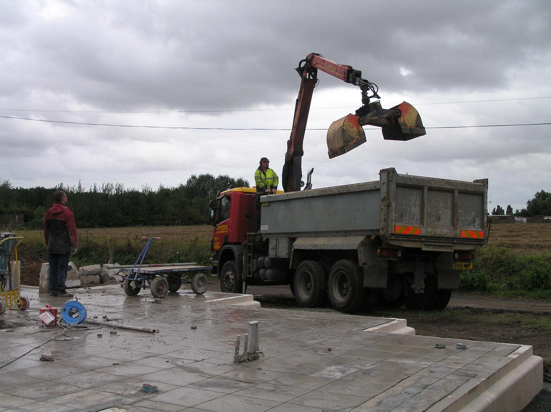

Gone West Posted February 12, 2022 Share Posted February 12, 2022 15 hours ago, markc said: Oh no! How come? We had the first Isoquick foundation installed in the UK back in 2010. It all went well until the concrete was poured. Unfortunately the concrete laying did not go so well. A combination of cost cutting, by not using a pump, and the concrete setting too quickly left large voids in the 200mm slab which were detected using ultrasonic testing. The results were confirmed by drilling core samples. Fortunately we videoed the whole procedure and had the evidence to show to the boss of the company. The result of the farce was that the whole system was cut up using a diamond road cutter and taken away. The second time around it all went smoothly fortunately. Link to comment Share on other sites More sharing options...
