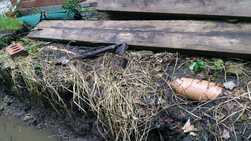

It looks like they were running out of depth. Obviously the "end" point of the drain run is fixed at what it is, and drains have to be laid to a minimum fall. So the furthest end is breaking out of the ground. Not in itself a problem if you still have the landscaping to do and will be covering it. Just raising the ground level up to the grid of the hopper should be enough.
Put a hose at the first drain where the white pipe is on the pic. Lift the cover of each drain and turn the hose on. Now the not nice bit. Put a spade down to restrict the flow at each manhole and any crap in the drain will stop at the spade. Fish it out and repeat until it runs clear.
The pipe that is barely under the topsoil would be a worry to me. Each run should have been laid in at least pea gravel so it doesn't sink and maintains its shape. Would raise the levels here first to stop the pipe getting damaged.

"The pipe that is barely under the topsoil"

I was expecting a minimal amount of ground work to back fill around the site after the building work was completed. There should be about 2 brick courses of cover there. And I don't know quite why it was taken to that corner. It could have gone the other way which would have made it easier to get the required fall and give it more cover.

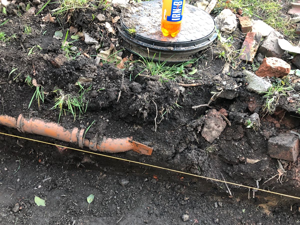

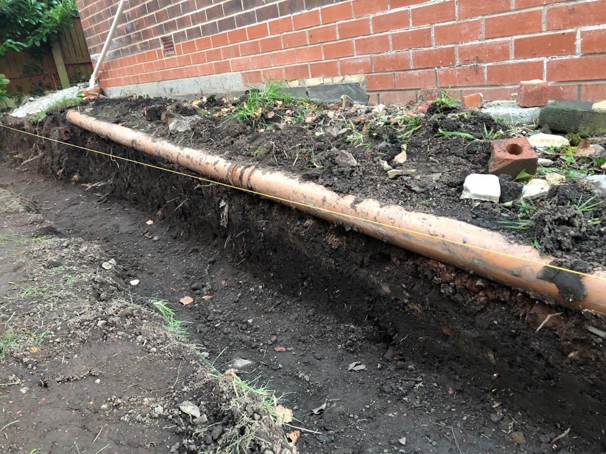

Anyways, digging up the garden has revealed its as bad as I expected. Plastic pipe just put in the ground and back filled 9_9

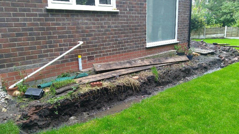

So this is the back of the extension. Furthest input into the drains is on the left, the kitchen sink and dishwasher outlet. The pipe is so close to the current surface with just backfill around it. Nothing screened or sand or gravel.
Intending to put a path above this along the rear of the extension. With steps down on the left hand side which means this pipe will be in the way. Could easily move the outlet to the right hand side so there isn't so much badly installed pipe so close to the surface.
On the right hand side of the picture, there is a black plastic inspection chamber under the planks to the right of the down pipe

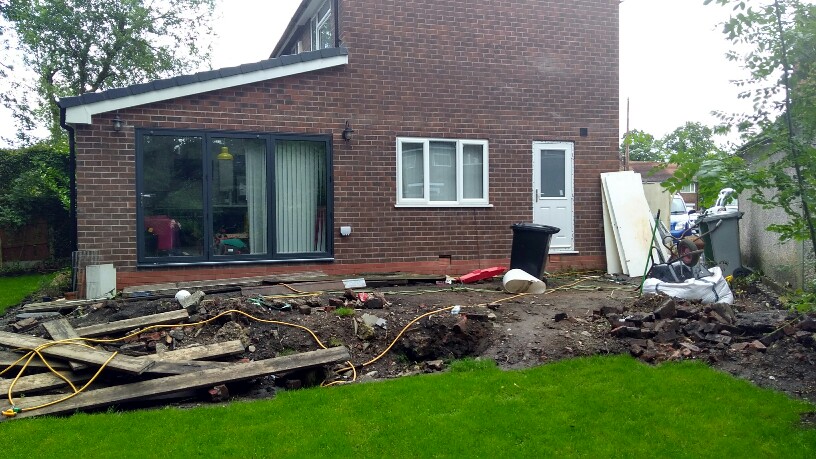

This is the side of the extension where the drain turns 90 degrees and heads toward the front of the house with another black plastic inspection chamber which is vaguely located near the base of those scrap doors leaning near the corner.
Over this area we intend to build a serious patio. I expect the pipe will again be just be covered by backfill, nothing graded. But will be a lot deeper than the first section. Wondering if this will need redoing before we build the patio.

So the question now is whether to take this last chance to dig it all up or check that it's not damaged now and cross fingers for a few decades.
