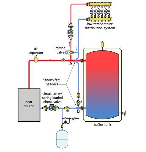

Mr Blobby Posted February 6, 2022 Share Posted February 6, 2022 (edited) Our M and E guys didn't seem to know much about a 2-pipe connection when I questioned their schematic (with a 4-pipe connection) last week. This is the 2-pipe connection...... From what I have read, a 2-pipe connection is more efficient than a traditional 4-pipe connection. Is that really the case and do members of this forum configure their system this way? Should I ask to change to a 2-pipe connection? Or does it really matter? For background we are aming for passive build with little heat demand. Buffer to sit between ASHP and UFH. Does the flow from ASHP to the buffer need a check valve and if so then are there any defrost cyle issues Edited February 6, 2022 by Mr Blobby Link to comment Share on other sites More sharing options...
Temp Posted February 7, 2022 Share Posted February 7, 2022 I think the advantage of a 2 port is more for ASHP than it is for oil/gas because when the UFH is calling for max power all the flow goes from the ASHP direct to the UFH with less mixing/blending. Not sure why there is a check valve shown in that diagram but suspect it should be removed where the source is ASHP or the defrost won't work? Link to comment Share on other sites More sharing options...

Nickfromwales Posted February 7, 2022 Share Posted February 7, 2022 With the 2 pipe buffer you can usually get away without the secondary circulation pump that would be required to get flow to the manifold pump. Less components and a more simplified install. I typically go 4 pipe with LLH’s and 2 pipe with buffer tanks. The arrangement you show offers both hydraulic separation and energy buffering, so I would run with exactly what you’ve drawn above. For the defrost, afaik, the check valve will not cause issue as I don’t believe the pump reverses flow for that (?) Anybody? Link to comment Share on other sites More sharing options...
SteamyTea Posted February 7, 2022 Share Posted February 7, 2022 With this set up, is there any flow advantage to having the Ts at A and B flowing strait threw and the buffer coming off the Ts? Whenever I see a bend or junction, I just see slower speeds. Hope that makes sense. Link to comment Share on other sites More sharing options...
dpmiller Posted February 7, 2022 Share Posted February 7, 2022 @SteamyTea I think the Tee is a benefit here as it'll promote flow into the buffer, the UFH is only supping from that. @Nickfromwales no, circulation doesn't reverse during defrost. 1 Link to comment Share on other sites More sharing options...

Nickfromwales Posted February 7, 2022 Share Posted February 7, 2022 The tee is "equal" so flow from the HP pump can go to either the buffer, the UFH or both at differing potentials without any issue at all. A typical CH system h as multiple tee's all the wat through the arrangement, and no problems there that a bit of balancing doesn't put to bed. Link to comment Share on other sites More sharing options...
Mr Blobby Posted February 7, 2022 Author Share Posted February 7, 2022 Thank you everyone for your very helpful answers. I will go back to my M&E guys and ask them to change to a 2-pipe connection. I'm not sure they get questioned on stuff like this very often! I like the idea of 1 less pump. I think panasonic ASHPs have a pump inside, if so then does that mean no additional pump to the buffer? 57 minutes ago, dpmiller said: @Nickfromwales no, circulation doesn't reverse during defrost. That's interesting. I thought the defrost cycle sucked warm water from the buffer back into the monoblock. Have I misunderstood how this works? I don't have a copy of the schematic but from memory it includes a second smaller buffer on the cooling circuit. Is there any reason why I can't use the same buffer to simplify things? I'll try and get a copy of the schematic to explain!! Link to comment Share on other sites More sharing options...
Nickfromwales Posted February 7, 2022 Share Posted February 7, 2022 1 minute ago, Mr Blobby said: That's interesting. I thought the defrost cycle sucked warm water from the buffer back into the monoblock. Have I misunderstood how this works? Defrost cycle simply fires up the HP pump. only, and the water from the buffer is used "in reverse" eg it is then the HP which is 'heated' by the warmed water in the buffer. Pump flow ( direction ) stays the same, as confirmed above. 1 Link to comment Share on other sites More sharing options...
Mr Blobby Posted February 7, 2022 Author Share Posted February 7, 2022 (edited) 7 minutes ago, Nickfromwales said: Defrost cycle simply fires up the HP pump. only, and the water from the buffer is used "in reverse" eg it is then the HP which is 'heated' by the warmed water in the buffer. Pump flow ( direction ) stays the same, as confirmed above. Ahhhh, now I get it. The flow remains the same but the pump brings warm water through in the same direction with the ASHP in cooling mode to heat up the frozen bits. In that case the check valve can remain. Edited February 7, 2022 by Mr Blobby Link to comment Share on other sites More sharing options...

dpmiller Posted February 7, 2022 Share Posted February 7, 2022 Generally the whole compressor changes it's gas flow direction- it's taking the energy from the warm water from the heating circuit yes, but amplifies that using the power of the heat pump. Normal flow temp in the 30c range will happily let the unit de-ice at 60 or 70c... Link to comment Share on other sites More sharing options...
