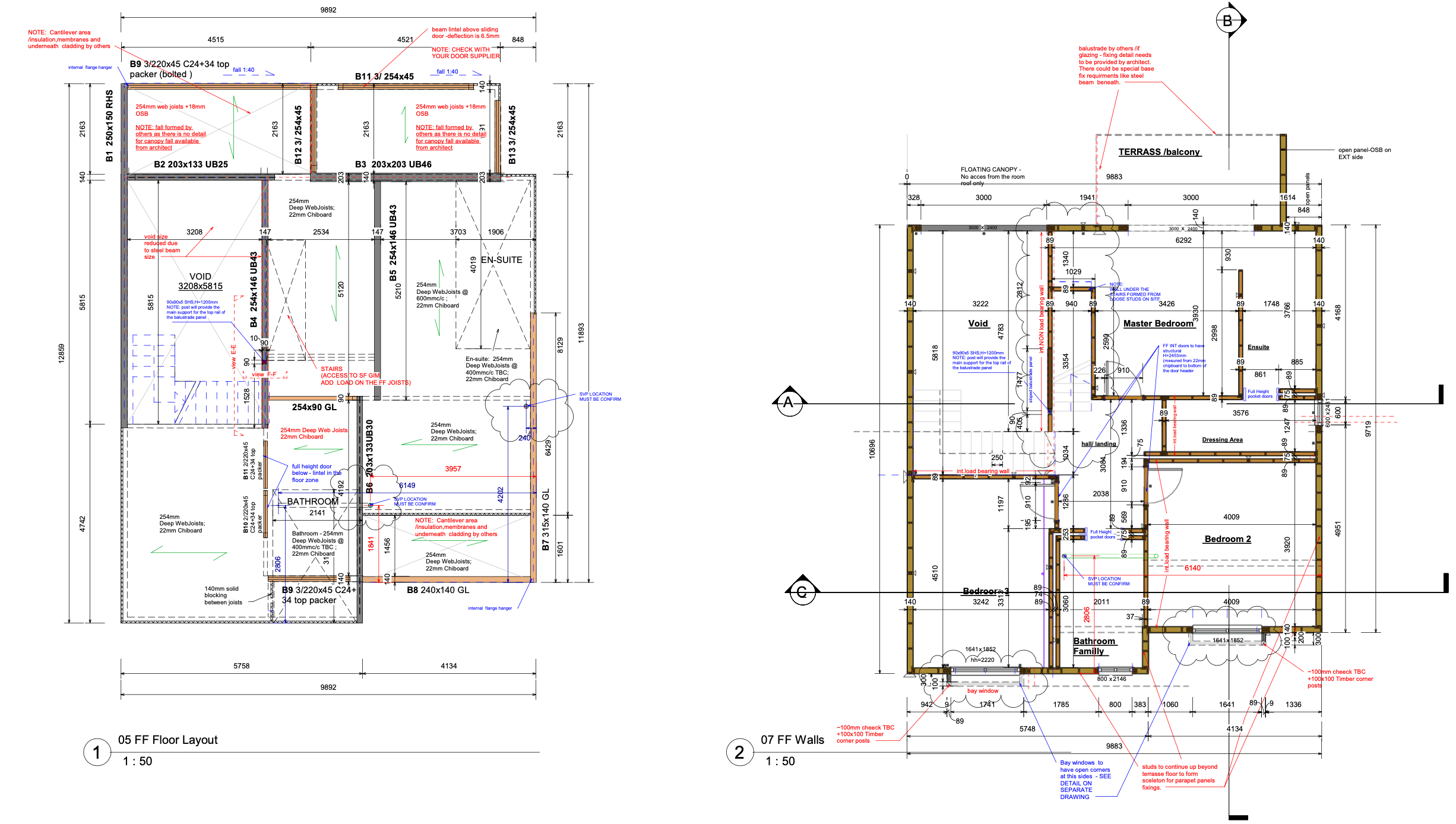

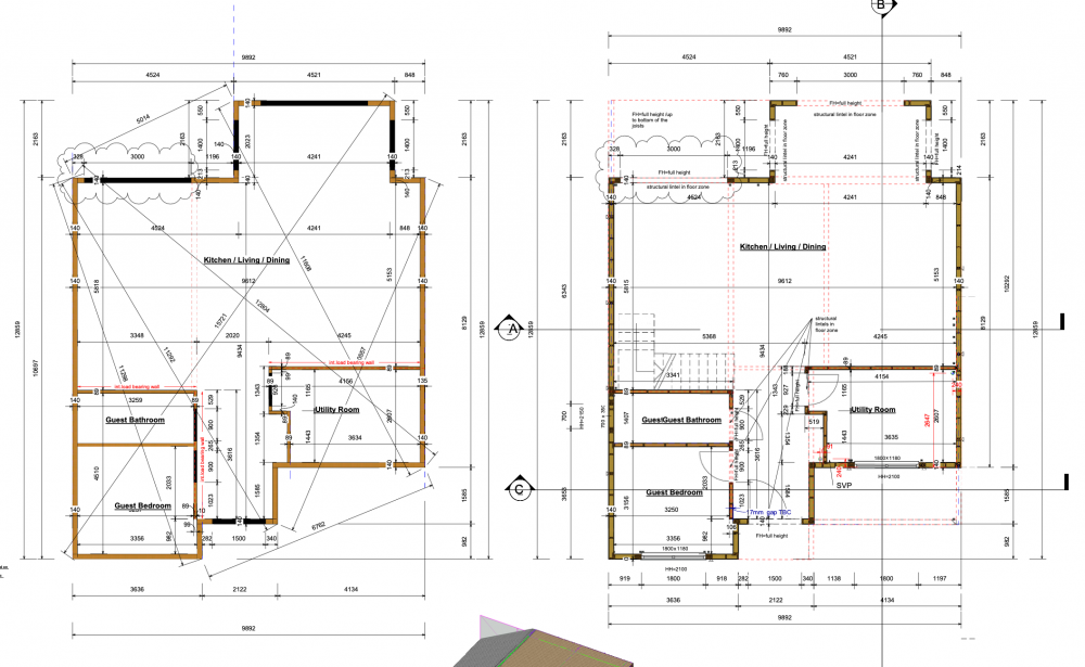

We are a few months away from starting the hard graft on site, but I am already trying to "guess" the possible ducting routes within the building.
My worry is that our timber frame structure has got a lot of steals and glulams in floor zones. One plan was to position the unit in the loft space. Alternatively, fit it inside the utility.
With steels cutting across both floors north to south and west to east, I can't see how, or where else I would have all pipes running between floors and rooms without adding quite unsightly boxings in numerous locations.
See the plans for more clarity.
Any hints please?
1324301704_Screenshot2022-02-06at18_09_30.thumb.png.cd8f0875d8d7917db42daa17e9771e16.png
1237565246_Screenshot2022-02-06at18_10_34.thumb.png.013a7c5d1eedade29072ae4167ad7417.png2095320800_Screenshot2022-02-06at18_09_07.thumb.png.f4e26e9c12b96eec51fb8d78582dad8e.png
What size is your house? If you're in the 300m² ballpark, you might want to consider two units, one for each side of the house to avoid crossing steels. That's what we had to do as we couldn't cross the steel mezzanine that splits the house I'm half.
Hi,
We are merely 180sq m (90 GF, 70 1st, 20 2nd floor). Sounds that I will end up with a lot of boxed out walls in the process, as the steels span the full height of the floor zones, so not like it is going to be possible to go flat ducting anywhere.

This is an example of folk not involving an M&E early on in the build process. All of my projects have the steels Pre-drilled for MVHR and FW/WW etc and permissions in place for drilling through glulams.
Can you ( have you thought to ) petition the SE to ask if you could have the steels penetrations done retrospectively?
In other projects I have reduced the 92mm ducts to 25mm x 225mm rectangular ducts to get up inside the service cavities of an MBC TF and that negated a lot of unsightly boxing in. Don’t know if that can help you out
with some of the runs, or maybe going from round to ‘oval’ ducts and mechanical 90o bends etc.

Yes. Get your M&E coordinator to design everything to fit into the fabric of the build, have the steels etc pre drilled...... :S
On my current clients MBC PH build, the in-house designers and I, plus the SE, did all this in advance. 300mm posi joists met 252mm steels, so no gap for 92mm ducts to go under ( above the ground floor ceilings ). I asked for the grade of the steel to be beefed up, and the profile reduced to 202mm. Job done. We now have 98mm under the steels which a) gives free run throughout the ground floor, and b) negated having any holes made ( bar 1x 117mm FW hole in 1x UB ).
Plumbing / electrics / mist system / MVHR / and FW+WW all in without a single boxing in.
Hopefully your TF company can work with you to do the same :)
