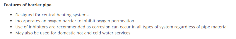

jack Posted February 4, 2022 Share Posted February 4, 2022 We have 28mm Hep2O connecting our ASHP to our plant room over a ~9 metre distance. All done without a single join, which in our case would have been a massive pain given a lot of it is in a channel cut through our underfloor EPS. Hep2O barrier pipe includes an oxygen barrier and is specifically designed for this sort of application, so I can't what the objection would be to its use - from https://blog.wavin.co.uk/all-you-need-to-know-about-hep2o-push-fit-plastic-plumbing-pipe/: Link to comment Share on other sites More sharing options...
