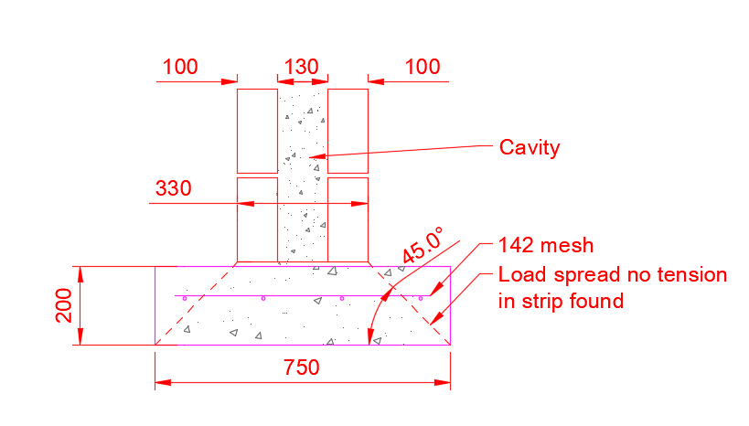

There are quite a few different types of foundations. For example some are designed to interact with say a concrete slab (like a raft) and we call these reinforced foundations like a reinforced concrete beam you may see when you look up at the ceiling of a multi storey car park.
Some are designed when you may be on variable ground or ground that may have a significant soft spot in it.. say over an old well or basement. The reinforced concrete spans over the soft bits. The foundations are designed to act like beams.
Under the ground the layers of soil often don't lie flat.. and are often tilted, but your building (hopefully) is level so the foundations need to span over the transition in the soil layers which settle by different amounts. Here you often look at reinforced foundations.. like a concrete beam. Reinforced concrete has a lot more steel in it and the codes specify a minimum amount of reinforcement which is a bit of a bug bear for folk that are doing ICF basements.. but hey ho.
One key to this is to recognise that concrete is not good at carrying tension forces but very good at carrying compression. You put steel in to carry the tension forces.
Now you can also have simple concrete strip foundations. These work in a different way. You often see a light weight steel mesh specified, say an A142 mesh. This mesh is not there to act as reinforcement like a beam in the carpark but only to mitigate cracking as the concrete cures and does what it does. It's easy to mix up the two different concepts.
Spread (strip) foundations are designed to act in compression only. The width of your strip foundations is generally governed by the overall thickness of the wall and the thickness of the foundations. The concept is that the load from the wall speads out at 45 deg through the depth of the found from the outer edge of the walls.. thus the concrete does not experience tension forces. Historically this was achieved by using corbelled brick founds or big flat stones.
The diagram below hopefully helps understanding.

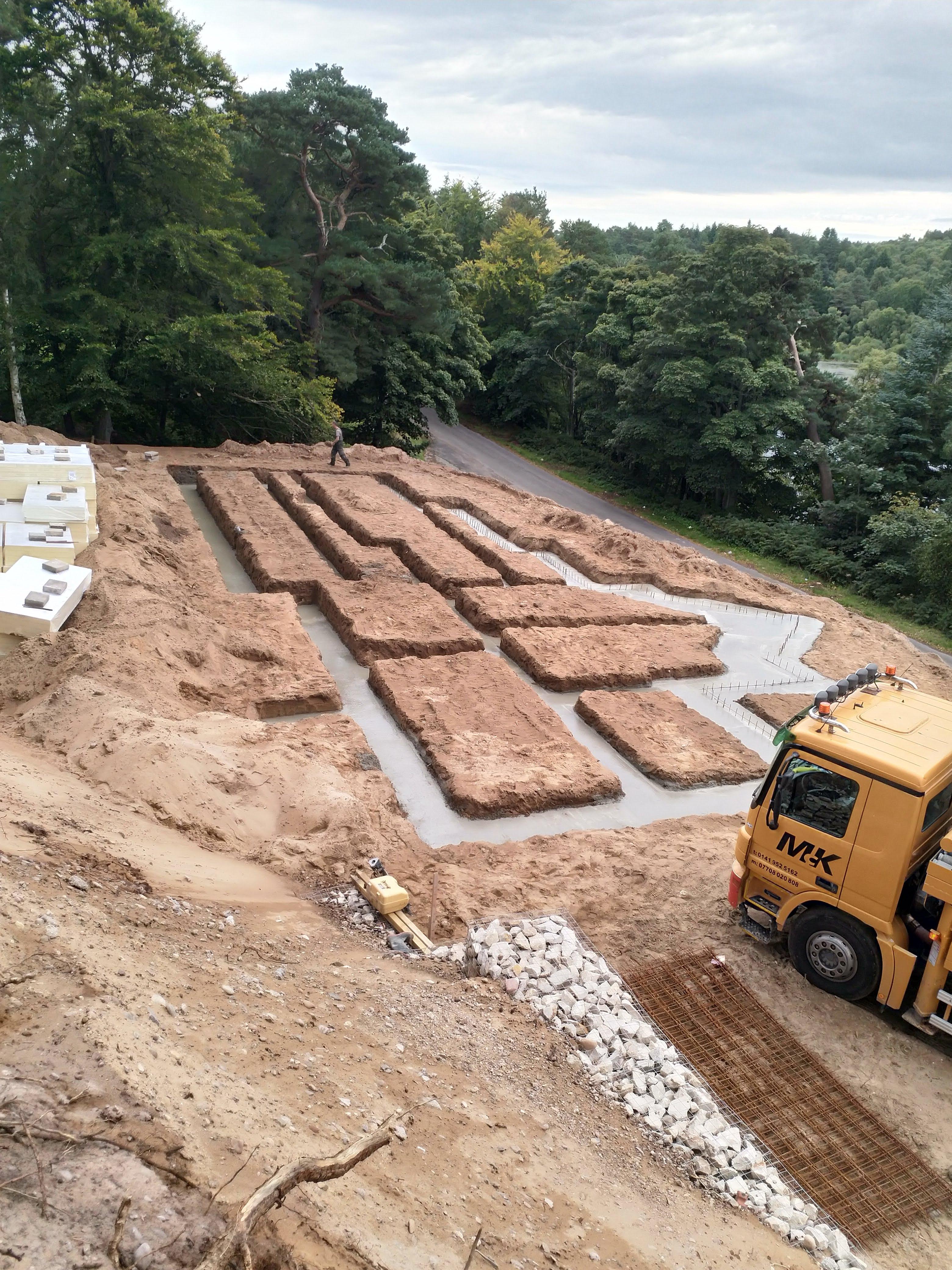

Your all lucky, our front foundation width was closer to 2m wide and reinforced.  All the fun you have an a sand hill.
That site looks sweet! Sets a bench mark. But to burst your bubble no protective mushrooms on the top of the exposed rebar. On the hole take that as a compliment.

It is simplistic to assume that forces go at 45 degrees, but it is a sensible assumption.
If the base shown here was 150 thick then it would also be narrower, so less strength both ways.
If it was built the same width as the wall then the forces would act on a smaller area of ground, and may settle.
There are many assumptions in building, and most are  based on common sense and the experience of centuries.
If the Engineer says 750 wide then by all means ask why, but then do it....there are many good reasons....loads, ground conditions, ground strength.
