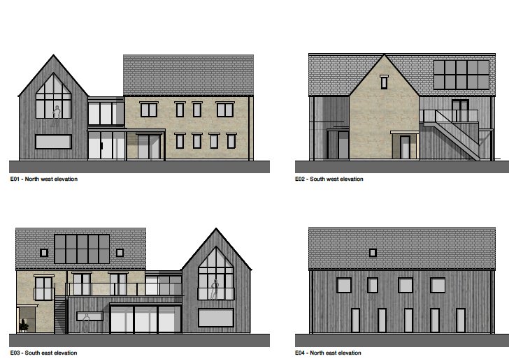

We await final planning to come through so we can demolish our bungalow and build a replacement 4 bed 2 storey house.
In the meanwhile we have a builder who we like and trust (he's just built a house for a friend) and we are discussing with him the best approach for Building Control -  Full Plans versus Building Notice (He built our friends' house on a Notice).
Of course our Architect (also a friend) is a fan of Full Plans - and the £13k he'll charge to do them.
We wonder what the Pros & Cons of each approach are and the likely poo traps also?
Thanks.
JAS
