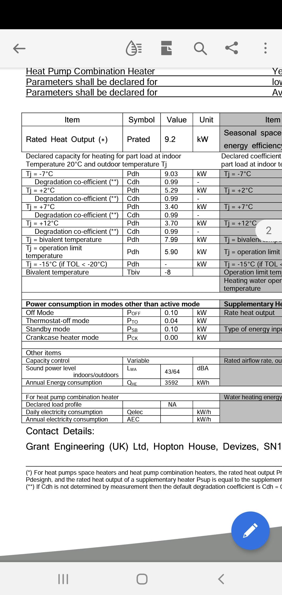

Mike_scotland Posted February 8, 2022 Author Share Posted February 8, 2022 Soooo im speaking to my builder and his mcs registered contact and there now suggesting a 10kw grant heat pump, i asked for the hear calcs and was told there going by a basic 45w per m2.... this is making me feel a tad uneasy Any advice? Link to comment Share on other sites More sharing options...
Kevm Posted February 8, 2022 Share Posted February 8, 2022 1 hour ago, Mike_scotland said: Soooo im speaking to my builder and his mcs registered contact and there now suggesting a 10kw grant heat pump, i asked for the hear calcs and was told there going by a basic 45w per m2.... this is making me feel a tad uneasy Any advice? I would be uneasy too. Any ASHP system designer/installer should do a proper heat loss calculation. It will be routine for them. And your house is a new build, right? My 1990 bungalow has a heat loss of about 56 w/m2; I would have thought yours would be much lower. You need the proper calculations. Link to comment Share on other sites More sharing options...
Mike_scotland Posted February 8, 2022 Author Share Posted February 8, 2022 49 minutes ago, Kevm said: I would be uneasy too. Any ASHP system designer/installer should do a proper heat loss calculation. It will be routine for them. And your house is a new build, right? My 1990 bungalow has a heat loss of about 56 w/m2; I would have thought yours would be much lower. You need the proper calculations. Yeah new build mate Link to comment Share on other sites More sharing options...
Mike_scotland Posted February 8, 2022 Author Share Posted February 8, 2022 Can anyone tell me what this means lol? Im assuming at -7 the heating output is 9lw? Link to comment Share on other sites More sharing options...

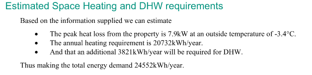

SteamyTea Posted February 9, 2022 Share Posted February 9, 2022 (edited) On 02/02/2022 at 15:25, Mike_scotland said: Thanks, So the HP has almost doubled in size. On 02/02/2022 at 16:35, SteamyTea said: Roughly 100 kWh/m².year. Or assuming 5 months heating, 25W.m² power needed. And almost doubles in size as well. Get someone in that knows what they are doing. Edited February 9, 2022 by SteamyTea Link to comment Share on other sites More sharing options...

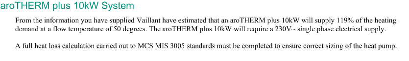

Mike_scotland Posted February 9, 2022 Author Share Posted February 9, 2022 1 minute ago, SteamyTea said: So the HP has almost doubled in size. And almost doubles in size as well. Get someone in that knows what they are doing. what do you mean? Vaillant said we needed a 10kw HP Link to comment Share on other sites More sharing options...
Bramco Posted February 9, 2022 Share Posted February 9, 2022 (edited) 22 minutes ago, SteamyTea said: Have you called a few MCS companies to come and give you a quote? It's hard to get a sensible answer from them - we've tried. Each of them is tied to a manufacturer in some way, so the answer always comes out as - you need a xxx (fill in the manufacturer name and model.). We've also had MCS companies that won't quote until they've charged us for a heat loss analysis, even though we have a full M+E tender document with that analysis. In fact, we commissioned a comparison between 2G and 3G windows to work out if 3G would be worth the extra investment, so have all the info needed. Quotes vary a lot and if you take out the material costs (it's easy to find prices on the web) then there is a massive markup for the 'MCS' bit against a plumber simply doing the install without the 'MCS' bit. Simon Edited February 9, 2022 by Bramco Link to comment Share on other sites More sharing options...
SteamyTea Posted February 9, 2022 Share Posted February 9, 2022 2 minutes ago, Mike_scotland said: what do you mean? Vaillant said we needed a 10kw HP Must have misread it, though it was a max heat load of 7.9 kW. Ah, add water. Link to comment Share on other sites More sharing options...
