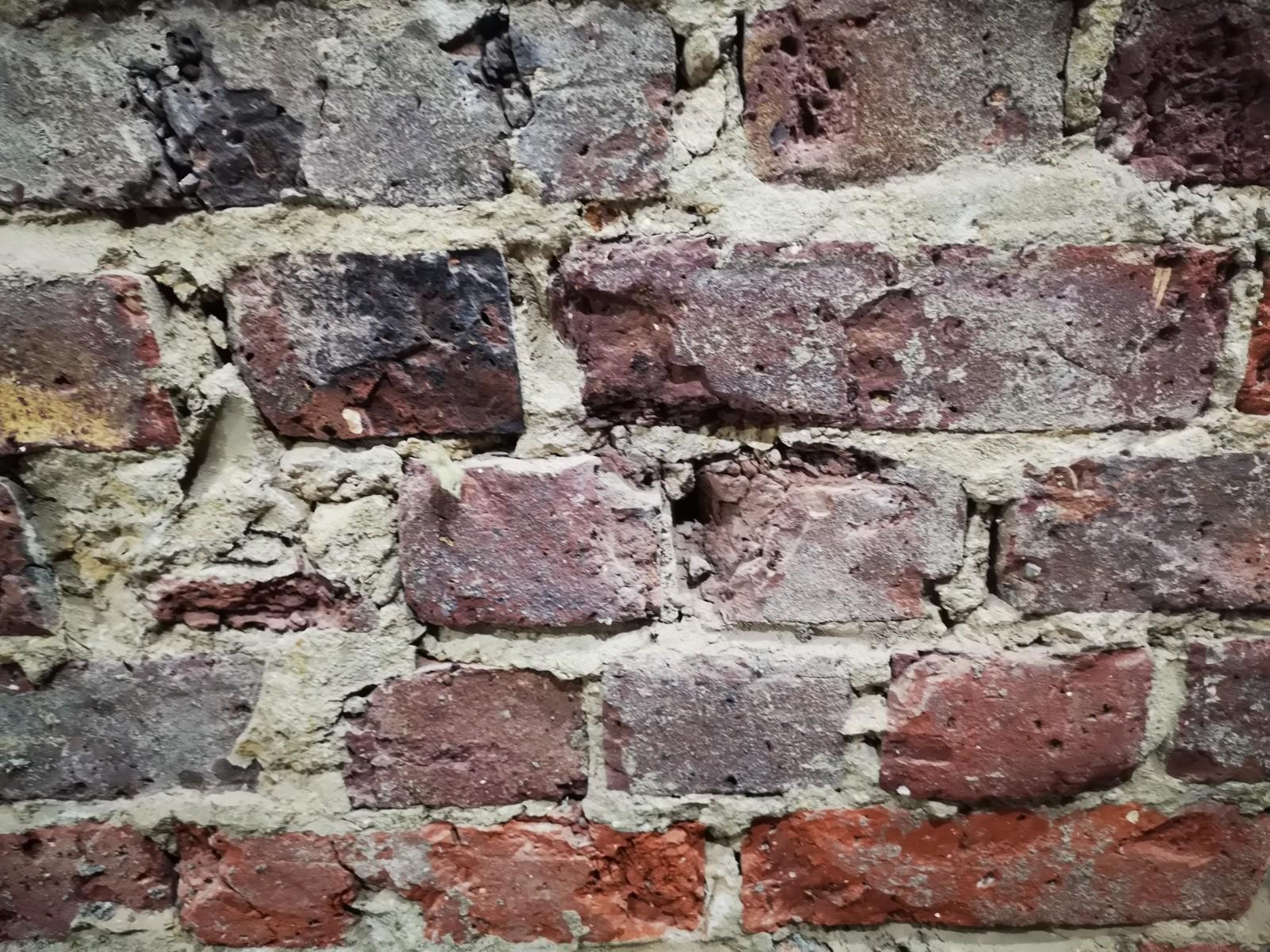

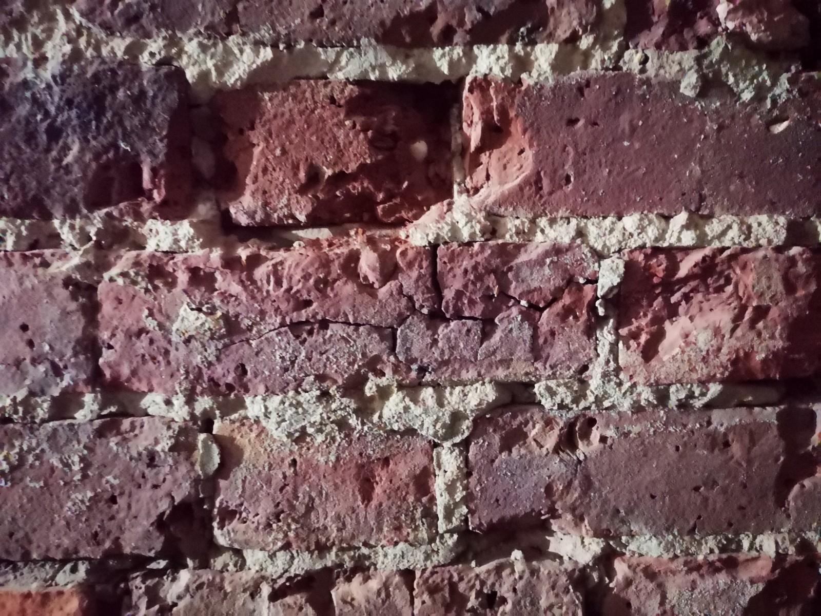

Porthole Posted February 2, 2022 Posted February 2, 2022 Hi there Your help would be much appreciated on this one. We have solid brick walls and the inner skin of bricks is cracked (see photos). How should the inner skin of bricks be repaired? The builder is using mortar to fill the gaps and then going to use Thistle Hardwall over the top then skim. Should hairline cracks be filled with epoxy resin? How big a gap can be filled with mortar? I've heard that mortar shrinks so is this a bad idea? Thank you very much once again!
Russell griffiths Posted February 2, 2022 Posted February 2, 2022 What cracks. Nothing there that isn’t present in most houses of a certain age. When you can shake hands with the neighbour through the crack is when to start worrying.
markc Posted February 2, 2022 Posted February 2, 2022 As above, a crack that goes through a number of bricks can be a cause for concern, can’t see anything wrong with the pic
Porthole Posted February 2, 2022 Author Posted February 2, 2022 The bricks crumble when you touch them and bits fall off so assumed they are broken in places. You can put your finger in quite far in some cases. Some hairline cracks too in the bricks. Thanks
Mr Punter Posted February 2, 2022 Posted February 2, 2022 It will be fine once it is plastered. Your plasterer can paint on some SBR if they think it will help.
Porthole Posted February 2, 2022 Author Posted February 2, 2022 OK that's reassuring - thanks all for your views. I'd heard that mortar shrinks and cracks and isn't so good but I am guessing that small amounts are OK where he is plugging gaps?
Carrerahill Posted February 2, 2022 Posted February 2, 2022 9 hours ago, Porthole said: Hi there Your help would be much appreciated on this one. We have solid brick walls and the inner skin of bricks is cracked (see photos). How should the inner skin of bricks be repaired? The builder is using mortar to fill the gaps and then going to use Thistle Hardwall over the top then skim. Should hairline cracks be filled with epoxy resin? How big a gap can be filled with mortar? I've heard that mortar shrinks so is this a bad idea? Thank you very much once again! I see nothing of worry, carry on. Just for information, if it was an issue, then "bonding" the cracks with mortar or epoxy would be futile. You need things like HeliFix to stitch cracks.
Ajn Posted February 2, 2022 Posted February 2, 2022 9 hours ago, Porthole said: We have solid brick walls and the inner skin of bricks is cracked (see photos). How should the inner skin of bricks be repaired? The builder is using mortar to fill the gaps and then going to use Thistle Hardwall over the top then skim. Assume the outer skin is outside in the weather? A solid wall and they look old bricks so is the existing motar lime? If so the wall breathes so the use of Thistle as it is a gypsum product will stop that.
Roger440 Posted February 2, 2022 Posted February 2, 2022 2 hours ago, Ajn said: Assume the outer skin is outside in the weather? A solid wall and they look old bricks so is the existing motar lime? If so the wall breathes so the use of Thistle as it is a gypsum product will stop that. Would echo this. Looks like lime mortar to me. If its got no DPC you are likely to create new problems with regular motar and plaster.
Roundtuit Posted February 3, 2022 Posted February 3, 2022 As above, the wall needs to breathe really. If you can afford to loose the space, I'd batten and dry-line, incorporating a membrane and some insulation if you can. It will make a big difference to the heat loss and risk of damp, and reduce the risk of hairline cracks in your new plaster.
Porthole Posted February 3, 2022 Author Posted February 3, 2022 10 hours ago, Roger440 said: Would echo this. Looks like lime mortar to me. If its got no DPC you are likely to create new problems with regular motar and plaster. Thanks for your reply - do you mean Damp Proof Course on the ground (apologies if this sounds a silly question - we're new to this)? The builders have put a membrane on the ground as new screed etc has been laid. There would just be original slate (I think) damp proof course in the old bricks themselves. Does that help? Thanks
Ajn Posted February 3, 2022 Posted February 3, 2022 1 hour ago, Porthole said: There would just be original slate (I think) damp proof course in the old bricks themselves. Does that help? Thanks You need to check, slate is fine but don't be persuaded by any thoughts of damp proof injection if it hasn't. It's likely (the wall) been there a long time without problem just consider the implications of covering it.
Porthole Posted February 3, 2022 Author Posted February 3, 2022 4 minutes ago, Ajn said: You need to check, slate is fine but don't be persuaded by any thoughts of damp proof injection if it hasn't. It's likely (the wall) been there a long time without problem just consider the implications of covering it. ok thanks
