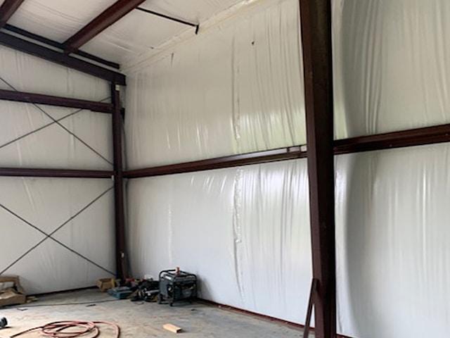

Roger440 Posted October 12, 2022 Author Posted October 12, 2022 5 minutes ago, S2D2 said: Good to get clarification that insulating the building is the way forward, sorry if I missed that in an earlier post. I don't think I'm being clear about leaving the eaves ventilation open, I'm talking about something like the left hand side of this picture: So the room is closed to the eaves but the roof is not. How you would achieve that with the kind of spans involved in that roof I have no idea but removing all ventilation from roof level will inevitably lead to condensation on the roof as it has nowhere else to go. Breathable roofing felt would be a suggestion to stop fibres dropping, but again how you make that practical is an open question. Might be worth getting a quote for spray foam and a quote to install a flat ceiling with new steels that you could pile rockwool on top of but again the scale is your enemy for keeping prices down. You're probably looking at north of £2k in rockwool just for 200mm then fixtures, felt etc. on top. Hey, at least the walls are easy! I'm unclear why we need any airflow? On my last garage, I used composite steel cladding on walls and roof. 100% airtight. Zero condensation. Condensation only happens when warm air meets cold roof. If we insulate the roof itself, then problem fixed. Otherwise known as a warm roof I believe. In housing terms. Even if this is an industrial building. 2k of rockwool is fine. But how to keep it up there, and prevent falling fibres Spray foam is 10-15k. Not really diy-able, and even if I did, the bulk of the cost is the foam . I guess this is my fall back option and I'll just have to pay. But a rockwool based solution will be much cheaper as the material is cheap, but labour intensive to fit. But my labour is free.
SteamyTea Posted October 12, 2022 Posted October 12, 2022 10 minutes ago, Roger440 said: Condensation only happens when warm air meets cold roof. Well almost, it is when it meets something below the dewpoint temperature, or the pressure changes. That is how clouds/mist/fog form, and they are pretty damp, and no roof involved. 12 minutes ago, Roger440 said: 2k of rockwool is fine. But how to keep it up there, and prevent falling fibres You can bag it into breathable bags, something like weed control membrane is cheaper than proper wall wrapping material like Tyvek. https://www.screwfix.com/p/apollo-heavy-duty-weed-control-fabric-14-x-1m/93943

S2D2 Posted October 12, 2022 Posted October 12, 2022 1 hour ago, Roger440 said: I'm unclear why we need any airflow? On my last garage, I used composite steel cladding on walls and roof. 100% airtight. Zero condensation. Condensation only happens when warm air meets cold roof. If we insulate the roof itself, then problem fixed. Otherwise known as a warm roof I believe. In housing terms. Even if this is an industrial building. 2k of rockwool is fine. But how to keep it up there, and prevent falling fibres Spray foam is 10-15k. Not really diy-able, and even if I did, the bulk of the cost is the foam . I guess this is my fall back option and I'll just have to pay. But a rockwool based solution will be much cheaper as the material is cheap, but labour intensive to fit. But my labour is free. If you can provide a 100% airtight seal to stop any internal air meeting the underside of the tin then yes, you will not require ventilation. This is likely to be very time consuming and expensive to achieve, airflow is usually a much easier win to counter condensation, but it's entirely your decision. I am biased because I've had severe condensation issues in the past (resolved by ventilation) as outside humidity is usually >80% around here.

Roger440 Posted October 13, 2022 Author Posted October 13, 2022 9 hours ago, S2D2 said: If you can provide a 100% airtight seal to stop any internal air meeting the underside of the tin then yes, you will not require ventilation. This is likely to be very time consuming and expensive to achieve, airflow is usually a much easier win to counter condensation, but it's entirely your decision. I am biased because I've had severe condensation issues in the past (resolved by ventilation) as outside humidity is usually >80% around here. It is an easy way to counter condensation, but in doing so humidity will be whatever it is outside. That's not conducive to the stuff inside sadly. Or retaining any heat.

S2D2 Posted October 13, 2022 Posted October 13, 2022 11 hours ago, Roger440 said: It is an easy way to counter condensation, but in doing so humidity will be whatever it is outside. That's not conducive to the stuff inside sadly. Or retaining any heat. No, the ventilation is underneath the tin roof, above the insulation and so the heated envelope below is practically unaffected by it, other than a small increase in heat loss from the upper surface of the insulation. The diagram I linked should hopefully demonstrate this. You then condition the air inside the heated envelope as appropriate as it no longer flows freely to outside, the relative humidity of which will be reduced as you have heated it.
Onoff Posted October 14, 2022 Posted October 14, 2022 16 hours ago, S2D2 said: No, the ventilation is underneath the tin roof, above the insulation and so the heated envelope below is practically unaffected by it, other than a small increase in heat loss from the upper surface of the insulation. The diagram I linked should hopefully demonstrate this. You then condition the air inside the heated envelope as appropriate as it no longer flows freely to outside, the relative humidity of which will be reduced as you have heated it. @zoothorn should read this comment. 2 1
