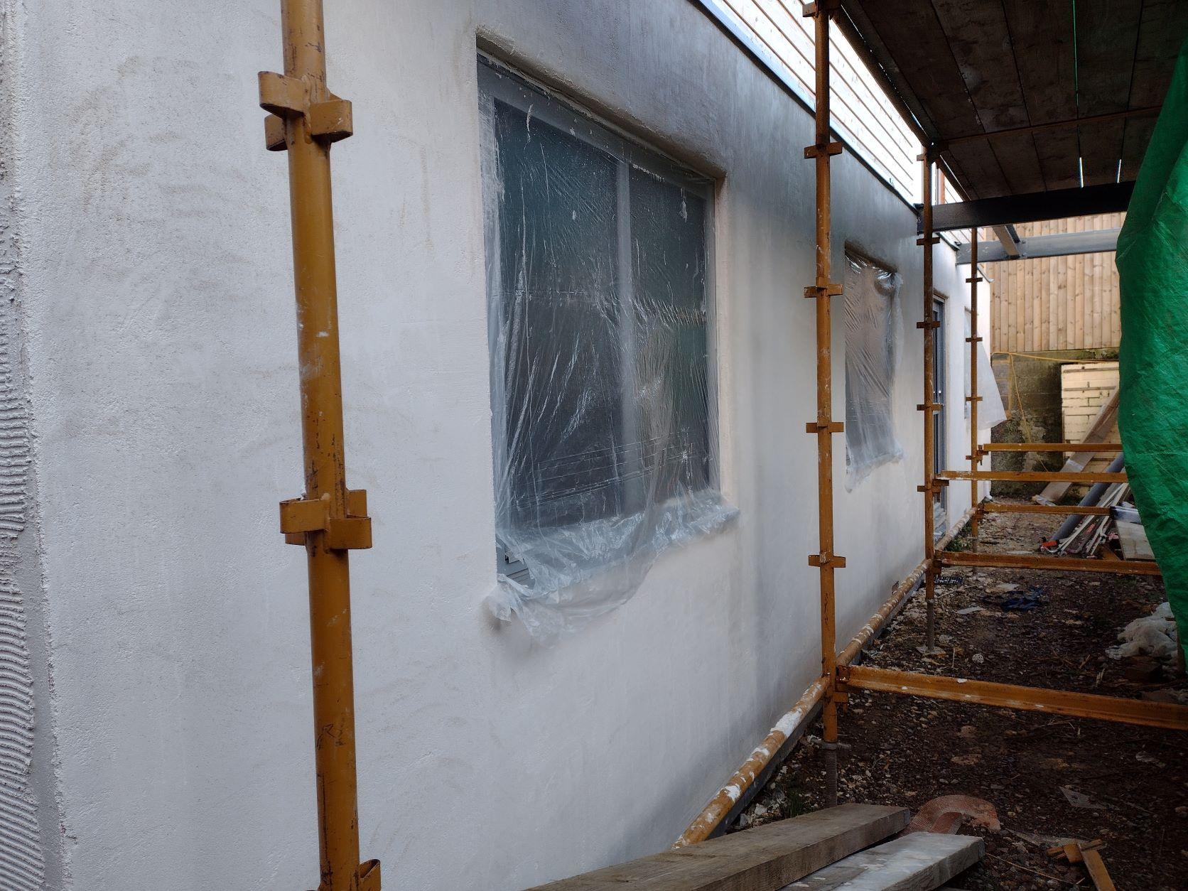

SimonD Posted February 5, 2022 Share Posted February 5, 2022 5 hours ago, Ben Weston said: I want to go back and suggest that the whole house (old and new) are covered in the same external insulation system to ensure continuity. FWIW that's exactly what I did with my infill extension. Photo attached after basecoat applied with no difference between the parts of the house. The ideal thing about this is that you can then design the house details such as window reveals etc. to fit the design 'theme' of the house. In my photo you'll see that my windows have been moved out from the walls on the house and sit in the ewi to reduce thermal bridging around the frames. The negative side of this is that the depth of the reveals meant I had to make myself a bespoke reveal detail because the normal window/corner beads/ and reveal boards would not fit within such shallow reveals. As you'll see from the image I also curved my reveals as I didn't want the square sharp corners typically found on new ewi. This is where you ideally need someone with experience working with ewi as they'll be able to guide you with the detailing, something you don't want to find out about when it's too late and the renderers are on site. 5 hours ago, Ben Weston said: That said, the suggestion seems all wrong to me. Your architect is merely suggesting what is a more mainstream approach and using the typical system sold by Weber which will be installed on a lot of houses across the UK. He/she may also be reflecting what you already mentioned as a lack of understanding of ewi systems. Like you, it's not the direction I would choose to take although if installed and detailed properly it will probably last the lifetime of the building providing it's maintained correctly too. There's nothing wrong with asking your architect to reconsider and include the works for removing the pebbledash and alternative buildup, but what I would personally strongly recommend is that based on your personal preference of materials you find and then use a complete ewi system and avoid selecting individual layers yourself that aren't part of the system. As mentioned before, get the manufacturer's technical department to complete a condensation risk analysis to demonstrate suitability of the buildup. You can also play with online tools like ubakus.com to get a feel for what you want. As a side note, please do remember to remove the pebbledash before you remove the roof and gut the house - old walls can become terribly unstable when you take the load off them and you don't want to be hammering the existing render off then! ? You're clearly doing your research so I'm sure you'll settle of the right solution for you. Good luck with it. 1 Link to comment Share on other sites More sharing options...

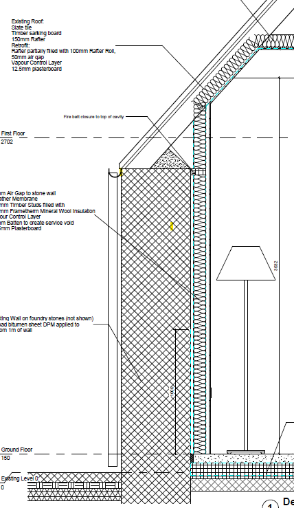

saveasteading Posted February 6, 2022 Share Posted February 6, 2022 5 hours ago, Roger440 said: Where on earth did you read that? The wall is 600mm thick granite, so any form of dpc is out of the question. I will look at your references with interest. Link to comment Share on other sites More sharing options...
saveasteading Posted February 6, 2022 Share Posted February 6, 2022 5 hours ago, Roger440 said: you would do well to aquaint yourself with these: OK done that. It is a bit of a rant unfortunately, and calling surveyors idiots isn't measured or encouraging. However, I am perfectly happy to hear advice that shows we do not need to spend money and time on the low level tanking currently intended. btw we got this idea / solution from a blog elsewhere, for a similar farm steading. I considered the bottom metre being tanked as reasonable (an extension of the dpm) and the wall can still breathe outwards and will be unsealed for the remainder of the wall height. However the drawing I copied doesn't show tanking either, so perhaps this is not proven. Our walls are currently wetter inside than out, as the air and wind evaporate water on the outer faces. When the gutters are repaired the wetness will reduce and only driving rain will wet the walls, and obviously will run down an make the bottoms wetter. Rising damp is impossible as our footings are on porous sand. Advice also welcome on ventilating the wall. The cross section I coped here shows ventilation through the wall, to pass up the new void between stone and new inner lining. That will suck a lot of heat out of the building so seems unwise. But I know from another Buildhub member that there are cases of Officers insisting on this. Link to comment Share on other sites More sharing options...

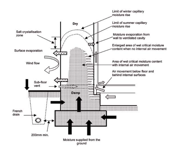

Roger440 Posted February 6, 2022 Share Posted February 6, 2022 (edited) 9 hours ago, saveasteading said: The wall is 600mm thick granite, so any form of dpc is out of the question. I will look at your references with interest. Yes, sadly it does come across a bit "ranty". However, pretty much everything is actually correct. He just could have said it differently! Going back to the beginning, the actual question is, why is the wall wet? Not "how can i cover it up?" Yes, thats what often happens. But long term this cant end well. Regardless of the surface finish on the wall, its almost certainly built with some sort of lime/earth type mortar. If permanently wet it will decay. The stones be granite will be fine in this case. What your picture shows is what happens when the water is trapped in the wall. Indeed, it exactly what was happening to mine. Mines is a very permeable lightweight brick with traditional lime mortar and no DPC. When i bought it, it was plaster with gypsum on the side, the floor was concrete over a plastic sheet. In some places the ground level outside was higher than inside. There were 3 hearths one on top of the other, and the chimney uncapped. The oustside is rendered. Mostly in lime but patched in cement, but painbted with a modern masonary paint. The walls were wet, and had been for a long time. There were 3 hearths one on top of the other, and the chimney uncapped. The socket back boxes , circa 500mm up from level had rotted away entirely as a result. Of you drilled a hole in the wall, all that came out was a wet slurry. Humidity in that room was normally over 90%. Oh, and it had had a chemical DPC added at some point. Percieved wisdom was tank it internally. Problem with that, is you are trating the symptom, not the problem. A good analogy, is, if you washed your clothes and put them in a plastic bag and hung them on a washing line, what do you think will happen? Thats what you are doing by tanking it. The moisture will simply go ever futher up the wall. So i set about sorting all the problems in mentioned, speeded up by the fact we had a flood, so we had to strip out carpets etc. Prior to the flood i had already sorted out the ground levels outside, in particular the gable end wall. The chimney was capped with a vented cap, so in no longer rained in the fire place. I had to repoint the brick work below the render, all done in lime, and the cement pointing removed. After the flood, plaster came off first which allowed me to easily see what was wet and how far up. Wasnt a metre but over 500mm in places. The drying out started straight away. Within a month, 90% showed no visible damp apart from the 1st visible course above the floor. Then we pulled up the concrete floor. The ground was wet under the DPC, as you would expect. I then left it for about 8 months. During that time its completey dried out. Evertyhing, walls, the dirt floor, even the limestone foundation stones. Some of the mortar fell out as it had disintegrated through being wet. Humidity, with NO floor, sits around 70-75% Its now dry. No damp in the walls. Simply becuase it can now function the way it did before it was built. Ie, moisture can arrive and evaporate. Yes, accepted it does require a degree of ventilation, and yes, that will ulitmately limit the level of thermal efficency you can apply. But a dry house feels warm, a wet house cold. 2 weeks ago we finally got the floor laid. Foamed glass as the insulating & foundation layer, lime screed over the top. The principle here is to insulate, but allow moisture to pass through if it needs too. Water were it exist under there cannot "wick up" the foamed glass. I will admit, when i started this, i was sceptical that this was going to resolve the issues. Frankly, its staggering the difference and speed at which that occurred., though the nature of the bricks involved probably helped the speed. From an engineering perspective it makes perfect sense however. Sadly, most builders are not engineers. As many on this forum will testify, most still dont grasp the basics of how to install insulation, dew points etc. Its no surprise inappropiate solutions are applied frequently. Because im sad, im always looking at old houses, and shaking my head in disbelief at the things that people doo. Back to mine. To finish off, limestone tiles on a lime based adhesive. Lime plaster with a suitable natural paint over. And this is they key. Every layer needs to be breathable. Everyone clains there products are breathable. They are not, at least not to a level that is remotely useful in these applications. Ask for the breathability data. What is the actual number? Take that for a lime render for example. Then compare to masonary paint, cement, gypsum etc. Tells you everything you need to know. My rather short post originally should really read, fix the problem, not the solution. There's a reason, probably several, why your wall is wet. Your picture is not it. Its just a reflection on the state of your wall. Indeed, a reflection of mine. Critically it shows everything pushing the moisture TOWARDS the wall. That IS the actual problem i had. Caused by inappropiate materials and methods. Edited February 6, 2022 by Roger440 Link to comment Share on other sites More sharing options...

saveasteading Posted February 7, 2022 Share Posted February 7, 2022 On 05/02/2022 at 19:34, Roger440 said: you would do well to acquaint yourself with these: Returning to this supposedly expert study... When we took on this project I assumed that there would be any number of how to do it/ advice /even stated methods in the regulations. Far from it, and it seems that different councils and inspectors even have their own (differing) expectations Currently I propose to avoid any drilling of holes through the 600mm of wall, to maintain the physical and thermal barrier, then apply 1m of bitumen sheet to the bottom metre inside, and leave the remaining 2-2.5m exposed. then a 50mm air gap. Inside this a timber frame filled with insulation, and sealed on the outer side by a breathable membrane, and the inside (before boarding) with an air-tight membrane. AS far as I am aware this is not exactly specified anywhere else, but nothing else is either. The air gap will be continuous to the roof sarking where it can breathe. Where does moisture come from? Not a lot up from the ground as it is granite and dampness doesn't rise far (as discussed earlier). Roof and gutters will carry away 99% of rain that currently dribbles down the walls. the ground is pure sand so it won't be wet around. pointing will be repaired or tided. So the wet is only from driving rain (which will run down the wall) and general moisture. Before any of that gets through 600mm it should be dried by the air and wind. Any and all advice and speculation welcome. Link to comment Share on other sites More sharing options...
saveasteading Posted February 7, 2022 Share Posted February 7, 2022 Does silence mean 1. Nobody knows. 2 Boring question. 3. I've told you already, are you not listening? 4. Give it your best shot and report back ? btw, in the doc referred to by Roger440, they show a canal wall as proof that rising damp does not exist. This wall will be built in very high quality engineering bricks with waterproof mortar, so it isn't the best argument. If they were normal bricks they would be wet for a few courses above the water, and probably green with algae. Roger440, any further thoughts on my pragmatic addition of the internal liner to 1m? that is a downpipe btw, not external cladding. Link to comment Share on other sites More sharing options...
Simplysimon Posted February 7, 2022 Share Posted February 7, 2022 yes this will allow ventilation up the internal face, but what is it going to do for the thermal properties? the majority of people on here with dot and dap complain about the tent effect. On 06/02/2022 at 10:13, Roger440 said: Thats what you are doing by tanking it. The moisture will simply go ever futher up the wall. no it won't, capillarity will only take the moisture up to approx 1.2m Link to comment Share on other sites More sharing options...
Cpd Posted February 7, 2022 Share Posted February 7, 2022 On 06/02/2022 at 01:10, saveasteading said: I considered the bottom metre being tanked as reasonable (an extension of the dpm) and the wall can still breathe outwards and will be unsealed for the remainder of the wall height. I have been mulling this over for some time as I also have an old stone building that I am renovating, no DPM in the wall but DPM coming up from the floor I laid, 5 years ago I had intended to extend the floor DPM one meter up the wall on the inside to prevent any water ingress but am concerned this will attract condensation…. The project stalled 5 years ago so nothing has happened and last I looked it was actually now very dry……. I thought about swapping out the black plastic for something like building wrap / roof membrane but am now just thinking that if it’s dry I should not over think it and just ignore it ….. build the stud work, insulate between and over the studs, vcl and then board it out…… my own house has a vented void between the inside stone wall and stud work with internal insulation over the top, the stone walls are damp behind the studwork but it’s vented and is still standing over 100 years later so I just left it alone and moved onto the next job….. i think you need to eliminate and water ingress from above, clear anything around the outside of the building that may be stopping air flow and scrape away damp earth and vegetation to clean subsoil / sand and see what happens, i did all this to my site as well as power washing both the outside and inside of the walls to leave very clean stone and no loose mortar, i then repointed and left it for 5 years…..(not intended) but it’s all now very dry. my walls are the typical outside stone, rubble core and inside stone - walls about 6-700mm gables 1000mm Link to comment Share on other sites More sharing options...
Roger440 Posted February 7, 2022 Share Posted February 7, 2022 1 hour ago, Simplysimon said: yes this will allow ventilation up the internal face, but what is it going to do for the thermal properties? the majority of people on here with dot and dap complain about the tent effect. no it won't, capillarity will only take the moisture up to approx 1.2m Well, yes. But the wall will be wet forever. Link to comment Share on other sites More sharing options...
Simplysimon Posted February 7, 2022 Share Posted February 7, 2022 43 minutes ago, Roger440 said: Well, yes. But the wall will be wet forever. not arguing that point, ok, i will, only if the cause can't be rectified, just some of the statements ? and pointing out issues with a 'remedy' Link to comment Share on other sites More sharing options...
