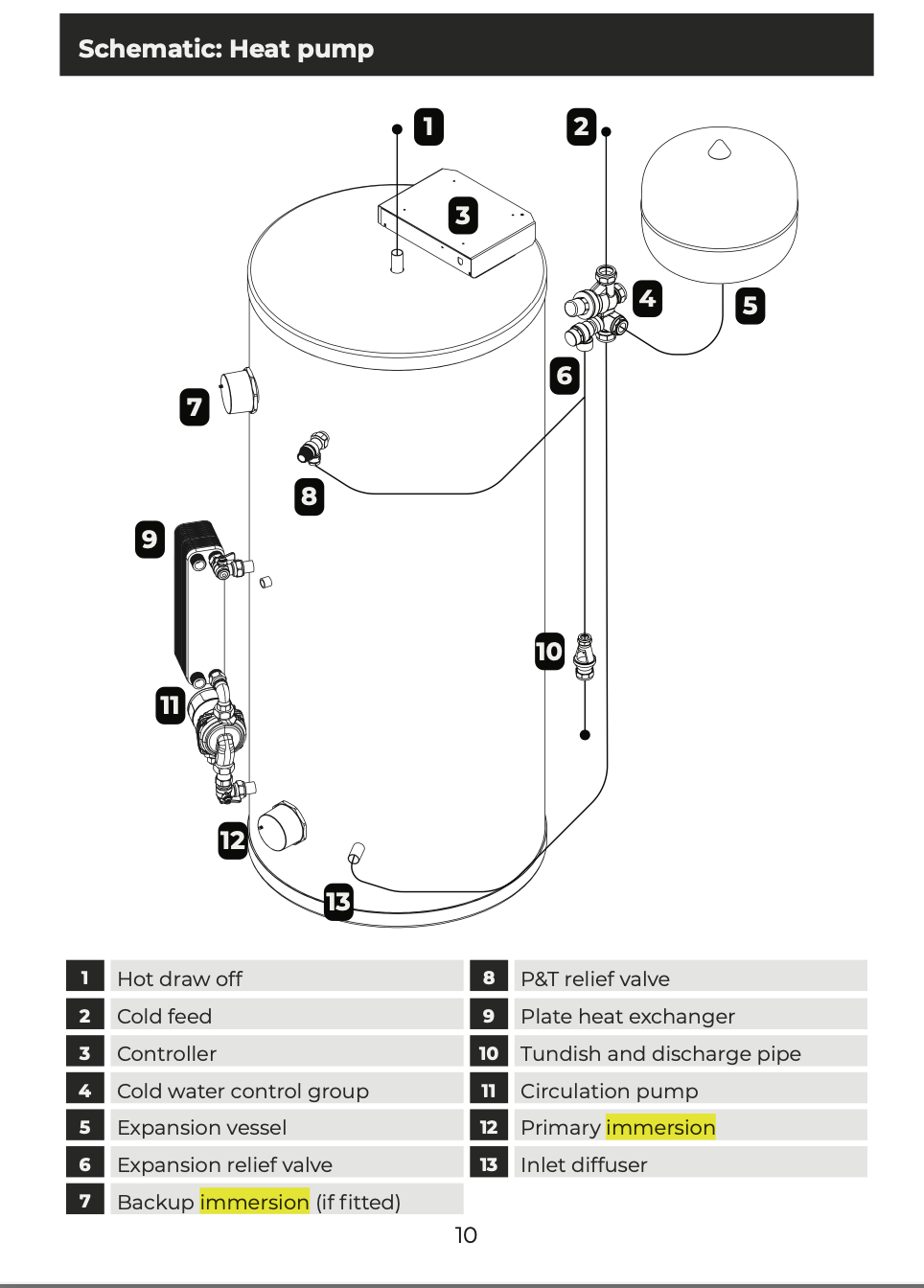

BartW Posted January 22, 2022 Author Share Posted January 22, 2022 48 minutes ago, Dan F said: Mixergy doesn't have a built-in bottom coil as they recommended a different approach for using ASHP with an external PHE See: https://www.mixergy.co.uk/mixergy-heat-pumps-faqs/ This however, is not the approach I'm using, as aroTherm means the limitations mentioned here do not apply. This two-pager does a good job at summarizing the different approachs: https://www.dropbox.com/s/9091d4a0ut7i5am/Heat pump leaflet V1_compressed.pdf?dl=0 Ok, I thought the heat exchanger was fitted as standard, as per the below: 49 minutes ago, Dan F said: Yes, but you need to look at the operating range too. The ones I looked at could only supply 60C between 0-25C which I felt was a bit too tight given the approach I was planning to take. Unless I am happy to keep it running at a lower temp, right? That's what the Mixergy say on their website. Hmm... 50 minutes ago, Dan F said: ROI from a pure energy usage perspective doesn't add up, unless you have very loong showers. But if you consider it's "greener" to recover rather than waste heat and it means you can get by with a smaller UVC, it did start to make sense from our perspective. (we didn't care about SAP, as house should score very high anyway). That's true. By the way, how have you got your Zyphos connected? Are they direct to the mixer, or teeing into the primary heat circuit? Link to comment Share on other sites More sharing options...

Dan F Posted January 22, 2022 Share Posted January 22, 2022 51 minutes ago, BartW said: Ok, I thought the heat exchanger was fitted as standard, as per the below: Standard on their heat-pump variant. All tanks now have these ports though, so it can be added later if needed. 51 minutes ago, BartW said: Unless I am happy to keep it running at a lower temp, right? That's what the Mixergy say on their website. Hmm... Maybe, but they have a pretty strong recommendation regarding the need for 60C primary flow for use of the top coil. You might get away with 55C if you don't plan to heat tank to more than 48/50C, but Mixergy won't recommend that. 51 minutes ago, BartW said: That's true. By the way, how have you got your Zyphos connected? Are they direct to the mixer, or teeing into the primary heat circuit? Do you mean the WWHRS? Directly into the mixer. It's not the most efficient setup, but it's by far the easiest as showers don't need to be near the UVC. Link to comment Share on other sites More sharing options...
BartW Posted January 22, 2022 Author Share Posted January 22, 2022 47 minutes ago, Dan F said: Standard on their heat-pump variant. All tanks now have these ports though, so it can be added later if needed. Sorry I meant to say Immersion when I pointed at element no 11 on their diagram. 47 minutes ago, Dan F said: Maybe, but they have a pretty strong recommendation regarding the need for 60C primary flow for use of the top coil. You might get away with 55C if you don't plan to heat tank to more than 48/50C, but Mixergy won't recommend that. I see what you mean. It may defeat the object in the first place. 48 minutes ago, Dan F said: Do you mean the WWHRS? Directly into the mixer. It's not the most efficient setup, but it's by far the easiest as showers don't need to be near the UVC. Yes, sorry, Zypho is just one of the brands. I guess the trouble with running back to the UVC is extra lengths of pipes, and possibly transfer heat losses? Link to comment Share on other sites More sharing options...
