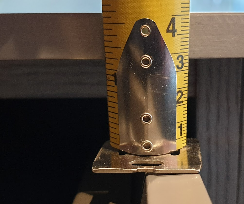

So we went for a really thin worktop, it's only 12mm. Now we have come to the point of fitting an induction hob we have hit a bit of a snag.
Typically, induction hobs seem to need 50mm plus from surface of worktop. We can add some blocks for the fitting clips
However, there is a pan drawer underneath with a hidden cutlerly drawer at the top. I do have 40mm clearance from the top of the worktop to the edge of the drawer.  I might be able to drop that cutlery drawer down, closer to the top of the pan drawer but I don't think I'll get the 10mm plus I need.
Other option is to remove the cutlery drawer altogether or get a shallower induction hob (if they exist) anyone have any thoughts or experience of this?

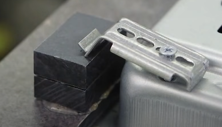

Whilst our quarts are 25 mil
I was.concerned about cracking when I tightened the clips So I used a thin line of silicone to sit the hob on
and it’s been fine
and it’s been fine
I’ve heard a few people say their hobs cause thin quartz to vibrate so this sounds like an ideal fix.
mine isn’t clipped either but didn’t silicon as tops are oak

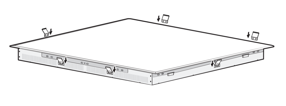

The, relatively cheap, AEG hobs that we installed recently claim that they can be installed in a 12mm work surface. The gubbins project 44mm below the top though and they still ask for 60mm clearance above a drawer. They don't have that sort of clamp, they use spring clips that push against the edge of the work surface so it's an interference fit.

Thanks for the offer but unfortunately yes, it's the back of drawer hitting the hob. I guess we could lower the back of the drawer.

We just got our in the other night. The clips on our Samsung hob are spring clips so they just push out. We glued battens to the underside of the worktop on three sides but could not get one in at the back. There is slight movement back and forth but I think a thin bead of silicone will sort that.
Moving the cutlery drawer worked a treat as well. One things I will say about cutting those Zenith worktops, the dust is hellish, really fine and you would not want to breath it in, smells like burnt sugar as well.
Cut dom of the back of the draw off.
Does your hob need ventilation under it. Mine does.
Yeah we opened up the cabinet carcass at the back for a 35mm x 550mm vent gap. There are units backing on to it as it's on an island but there's enough of a gap. The bottom is probably closer to the top of the drawer than I would like but I think it should be fine. The manual does say not to put anything light in the drawer like paper.
