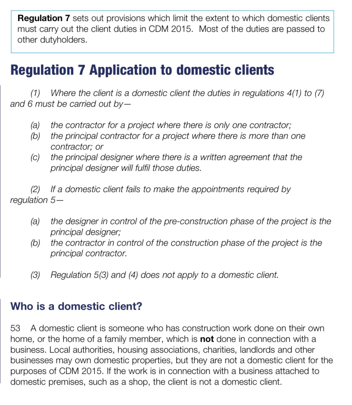

PeterW Posted January 18, 2022 Posted January 18, 2022 4 hours ago, George said: As a self-builder you will take on the role as Principal Contractor when you are employing contractors. If there is no Principal Designer, you will also need to fulfil their obligations as well as Client duties. The regulations are well explained in L153 (https://www.hse.gov.uk/pubns/priced/l153.pdf) but not all are entirely relevant to a self-builder. sorry but this is wrong. And you need to read and understand the domestic client element of CDM2015 - in fact if you don’t appoint as per regulation 5 then the architect becomes principal designer by default, and each stage contractor becomes principal contractor. It is clearly noted in regulation 7. Appendix 6 also refers It is also worth noting since it’s inception in 2015, there have been no instances of the HSE prosecuting relating to CDM2015 and self builders failing to notify or act according to the regulations. 1

George Posted January 18, 2022 Posted January 18, 2022 (edited) Without knowing the scale of the job, it's hard to say for sure what is appropriate. It's not exactly hard to comply with CDM2015 requirements on small jobs. @PeterW - quite right. Big projects still influence my understanding and I was thinking Reg 5(3). (However there's not enough information here and a self-builder could be the designer primarily in charge in the pre-construction phase.) @LA3222 - 'self building' is fine. It's DIY. Employing trades is being a Principal Contractor and the regulations apply in full. It's all fun and games until someone gets hurt. Quote I am assuming this would be in the form of a consultation. How best to engage this? Just search locally? Do I still need this I ended up going with Principal Designer (depending on the quote)? What is the likely cost of the HS adviser? What is the output I would find useful from this engagement? Thanks. It really depends on the scale of your job, Basically it'd be to check your fulfilling statutory duties and get another set of eyes to carry out a site audit. Quote I have asked for a quote for someone to act as principal designer but they told me for a selfbuild residential ik the absence this role would fall on the architect unless they explicitly refuse this role. My understanding is that if I get someone for this role then it would be easier to manage the responsibilities of the principle contractor (as long as trades are kept separate). Yes if you had an architect they'd be the PD. But unless you pay them to do it, you're unlikely to see anything from them. As self-builders can be heavily involved in the pre-construction design work, it can make sense for them to be the PD. In a small scale job, the PD could just hand over the pre-construction information (ground info etc), the design itself and a list of non-obvious hazards and pretty much leave it there. Another major duty of a PC is to sort out the construction phase plan. This is a good template for a small job https://www.hse.gov.uk/pubns/cis80.pdf Edited January 18, 2022 by George
