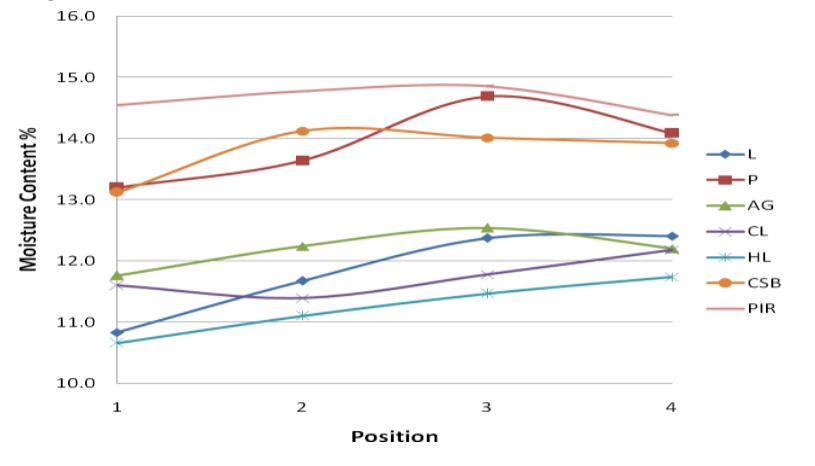

It's about striking a balance between low wall U-Value and making the sandstone wall outboard of the insulation too cold and suffering from frost and damp. The wall will have a reasonable contribution to insulative value as long as it's dry.  60mm Wood fiber would be fine IMO. Maybe someone else will correct me.
Steico Therm Woodfibre Internal Insulation Board - 1350 x 600 x 20mm |  Insulation Superstore®
You must use breathable render and paint however. Look at study below of the effect on wall humidity by not using breathable materials. PIR and emulsion paint perform the worst. Cork lime and hemp lime render the best. Wood fiber would be similar.
http://www.tara.tcd.ie/bitstream/handle/2262/79420/CERI draft RW SP final.pdf?sequence=1&isAllowed=y
