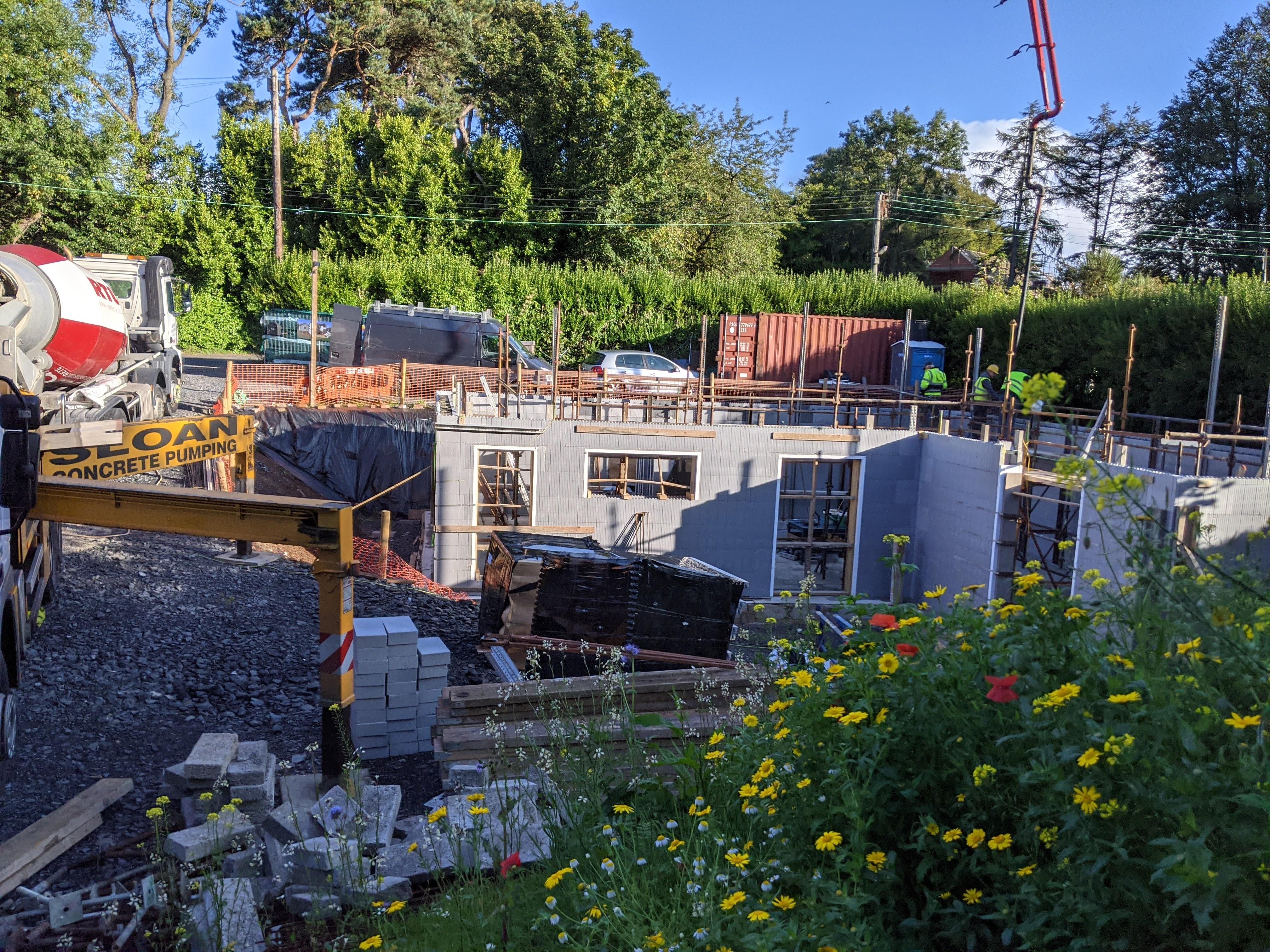

Conor Posted January 16, 2022 Share Posted January 16, 2022 Depends on the specific modulus of the soil. Ours has a modulus of two and were able to batten slopes to more than 60°. This will give you a good idea of slip angles. http://www.geotechdata.info/parameter/angle-of-friction NB, enough rain can wash away and collapse any type of soil bank at any angle.. We planted a load of wild grass and flower seeds on our spoil heaps, really helps keep the surface together and reduce wash off. We have a silt fence at the bottom of the site to prevent wash off to the river (planning condition) Link to comment Share on other sites More sharing options...

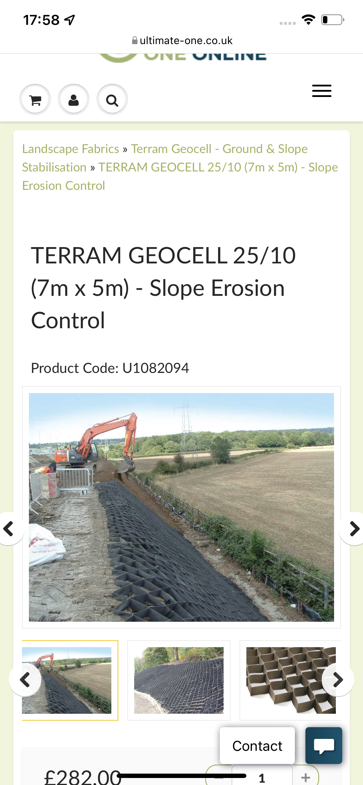

James94 Posted January 16, 2022 Share Posted January 16, 2022 Could you not use something like this or something similar. Regards. James Link to comment Share on other sites More sharing options...

Conor Posted January 17, 2022 Share Posted January 17, 2022 (edited) 16 hours ago, eandg said: Thanks - that's reassuring. Engineer says 45 degrees should be fine. Plan will be to pin it, spread as much topsoil on as we can stretch to and seed with wildflowers asap. Keep the topsoil in a separate heap. It'll soon be covered on grasses and nettles. The subsoil would benefit from the wild seed mixes as they prefer poor soil anyway. Ours did really well even though we didn't sow until June. Field marigolds, wild mustard and cornflowers did particularly well. Edited January 17, 2022 by Conor Link to comment Share on other sites More sharing options...
eandg Posted January 17, 2022 Author Share Posted January 17, 2022 11 minutes ago, Conor said: Keep the topsoil in a separate heap. It'll soon be covered on grasses and nettles. The subsoil would benefit from the wild seed mixes as they prefer poor soil anyway. Ours did really well even though we didn't sow until June. Field marigolds, wild mustard and cornflowers did particularly well. Thanks, and looks great - done some reading since and read that Autumn is best for seeding but we'll be putting it down in Spring. 2 hours ago, ToughButterCup said: Thats quite hard to achieve. Topsoil is often too 'rich' Keep back some poor soil and small crushed stone as a topping. We've had poor results so far, so I'm hoarding clean stone and remnants of sharp sand in an effort to duplicate the poor soil in which many wild flowers grow. Anyway, best of luck! Before and after photos would be good ? Thanks, and will do. Link to comment Share on other sites More sharing options...
