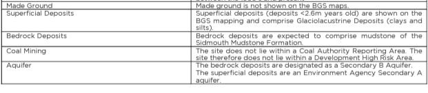

Zak S Posted January 24, 2022 Author Share Posted January 24, 2022 Hi @Gus Potter I had written to my GI survey company as to the possibility of softer ground below hard ground asking what safeguards were in place to reduce the risk of aforementioned issue. They came back with the following. what are the view in respect of accepting their comments/going for desktop study/reinviting them for few other boreholes after demolition. Quote from GI as follows: The risk of softer ground below the borehole termination depth is considered to be extremely low, with the cementation of the sands indicating the beginning of the Sidmouth Mudstone Formation, part of the Mercia Mudstone parent bedrock group from c.7.5m, with the bedrock formation for this area, based on British Geological data for the site, being indicated to be in excess of 150m thickness. As to safeguards of no softer ground below the final borehole depths, with any investigation there is a cut-off point where further progress cannot be practicably achieved with the equipment on site without risk to the drilling rig/samplers, etc. Given an SPT value of 45 is generally sufficient to undertake the pile design, a 'refusal' N value of 50 was adopted in the quote, as strata with values above this level when using conventional bottom driven piles are generally sufficient to prevent pile penetrate much beyond this point/level. The direct standard penetration tests confirm increasingly competent ground from c.7.5m depth with very dense/strong strata at termination levels. The probe test in BH3 also confirms the continual increases in strength of the apparent weathered sandstone with depth. Final blow counts of 73 and 111 were recorded indicating very competent ground with a bearing capacity of >750Kn/m2, this value incorporating a minimum factor of safety of 2.5, or, the ground at refusal depth in the boreholes can take a load in excess of 15T/m2, with anticipate loads from piles being considerably lower than 500kN/m2. If the above still does not give you the confidence regarding the ground and you want/need to prove the competent strata continues even deeper than the termination depth of the existing boreholes this will need to be done either; after demolition is undertaken to allow access to the rear garden area or; using the drilling rig we are in the process of purchasing and which was only delivered to the UK last week and which we will be collecting this week, the rig being specifically designed for limited access site having an access width requirement of 800mm, as well as the ability to dynamically drill and rotary core/open hole into bedrock which has until now not been possible as all available rotary hire rigs need >1.5m width access. Link to comment Share on other sites More sharing options...
