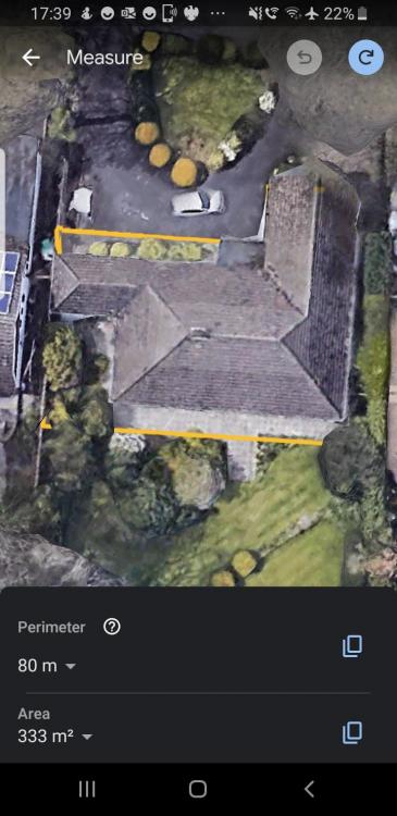

Zak S Posted January 12, 2022 Posted January 12, 2022 (edited) I am thinking foundation for about c330sqm foot print. I have received the GI report which is not encouraging and points to the need for piled foundation. there are multiple options e.g. piles with voided raft, piled with ring and beam, screw piled foundation. What do you think would be the cheapest options? Please is the GI report and property expected foot print (yellow border). Also if any one has experience of screw piling existing foundation (are they cheaper than new foundation?) Also the GI report mention that given the high water table the storm soakways is not recommended. What other option I am left with to divert rainwater away from main drainage system? Thanks all in advance. GI Investigation Report.pdf Edited January 12, 2022 by Zak S
Mr Punter Posted January 12, 2022 Posted January 12, 2022 If this is for demolish and rebuild, it looks like you will need to install piles to 10-12m. From the report the existing foundation is not suitable for additional loading. Unless there is obvious subsidence I would either leave the foundations and building loadings as they are or demolish and start again with augered concrete piles and ground beams.
