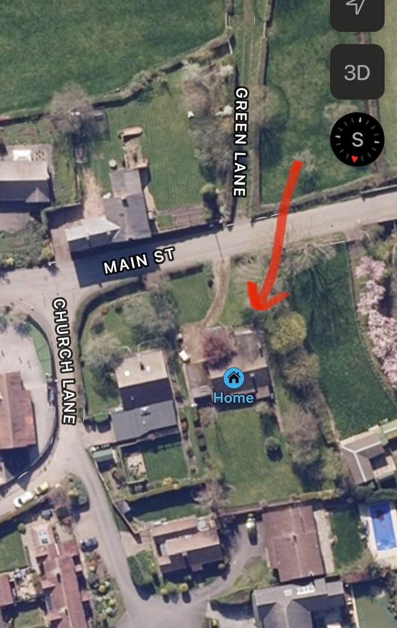

richo106 Posted January 12, 2022 Share Posted January 12, 2022 Hi All We are planning our renovation project for this year, our village doesn't have mains gas We think we have decided to go for ASHP (16.5kw Daikin Altherma) to supply our heating/DHW..so solely electric rather than LPG or Oil The way our house faces, with very small section south facing and blocked by tree so I don't think it will be very suitable for solar panels (see picture) Would people still look into solar panel and maybe have a company come round before ruling it out? Is there any other options to help reduce energy costs? I'm guessing only battery storage is useful when having some solar panels (or another form of generation) All advice and information appreciated Many Thanks Link to comment Share on other sites More sharing options...
JohnMo Posted January 12, 2022 Share Posted January 12, 2022 What about a ground array at the end of the garden? With optimisers on each panel to limit the effects of shading. PV with an immersion diverter, to use excess generated electric to make hot water. Battery storage expensive. Before any of the above look at insulation, draft and air leakage. That's the best money spent. Before you go to a heat pump, you need a house that can operate on low temperature heating, otherwise running costs will be high. 3 Link to comment Share on other sites More sharing options...
ProDave Posted January 12, 2022 Share Posted January 12, 2022 That picture looks to be rotated, i.e. south up, unless you are in the southern hemisphere. How about a ground mounted PV system at the southern end of your garden? Then make it into a shed: Link to comment Share on other sites More sharing options...
richo106 Posted January 12, 2022 Author Share Posted January 12, 2022 36 minutes ago, JohnMo said: What about a ground array at the end of the garden? With optimisers on each panel to limit the effects of shading. PV with an immersion diverter, to use excess generated electric to make hot water. Battery storage expensive. Before any of the above look at insulation, draft and air leakage. That's the best money spent. Before you go to a heat pump, you need a house that can operate on low temperature heating, otherwise running costs will be high. Thanks for the reply Regarding insulation, there will be 150mm under the UFH in our new ground floor slab, the existing building has 70-80mm cavity with insulation in and I will be insulating internally using either 50mm PIR or rock wool depending on what system we install (recommendations welcome!) also in the bedrooms with vaulted ceilings will be 100mm PIR between the joists. windows are residence 7 You mentioned air tightness, what are the best ways to achieve this? we want a couple of log burners in kitchen/diner and lounge…are these Ok for air tightness? Many Thanks Link to comment Share on other sites More sharing options...

Nickfromwales Posted January 12, 2022 Share Posted January 12, 2022 After 9m2, iirc, you need planning permission for a ground mounted array. A great option if feasible, and we’ve done a few with great results. If the trees can’t go, your options are significantly reduced there. Also remember that PV will never offset or aid heating in winter unless you’ve a monster of an array ( impossible to get on single phase ). Can you get another 50mm of EPS insulation under the 150mm of PIR? Will be a better result and you can lay your DPM atop the EPS to keep it free from punctures. The 100mm between rafters is good, but also consider installing 25-40mm of full sheet PIR over the rafters to give you greater results by arresting the cold bridging from where the plasterboard meets the rafters. Pre-insulated plasterboard is a perfectly good option there, but I prefer to separate the two and stagger the joints. The same pre-insulted boards can be used to form your IWI also, ‘stuck’ with dot and dab but with a continuous bead of dab or expanding foam to stop thermal tenting. Link to comment Share on other sites More sharing options...
richo106 Posted January 12, 2022 Author Share Posted January 12, 2022 19 minutes ago, Nickfromwales said: After 9m2, iirc, you need planning permission for a ground mounted array. A great option if feasible, and we’ve done a few with great results. If the trees can’t go, your options are significantly reduced there. Also remember that PV will never offset or aid heating in winter unless you’ve a monster of an array ( impossible to get on single phase ). Can you get another 50mm of EPS insulation under the 150mm of PIR? Will be a better result and you can lay your DPM atop the EPS to keep it free from punctures. The 100mm between rafters is good, but also consider installing 25-40mm of full sheet PIR over the rafters to give you greater results by arresting the cold bridging from where the plasterboard meets the rafters. Pre-insulated plasterboard is a perfectly good option there, but I prefer to separate the two and stagger the joints. The same pre-insulted boards can be used to form your IWI also, ‘stuck’ with dot and dab but with a continuous bead of dab or expanding foam to stop thermal tenting. I can definitely mention the 200mm PIR instead of the 150mm originally the building said 100mm but I upped him to 150. good idea regarding the additional PIR in the vaulted ceiling bedrooms I will be definitely be doing that. Regarding the insulated backed plasterboard, do you think this will give better performance than say a stud wall infront of the walls with an 10mm air gap and 50mm rock wool insulation? thanks again Link to comment Share on other sites More sharing options...
