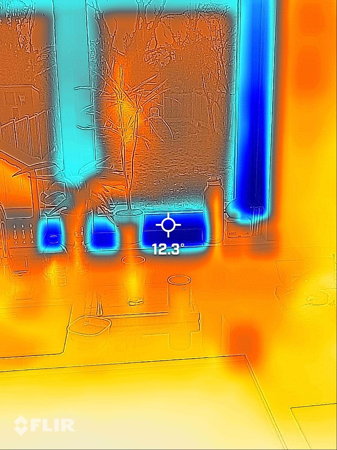

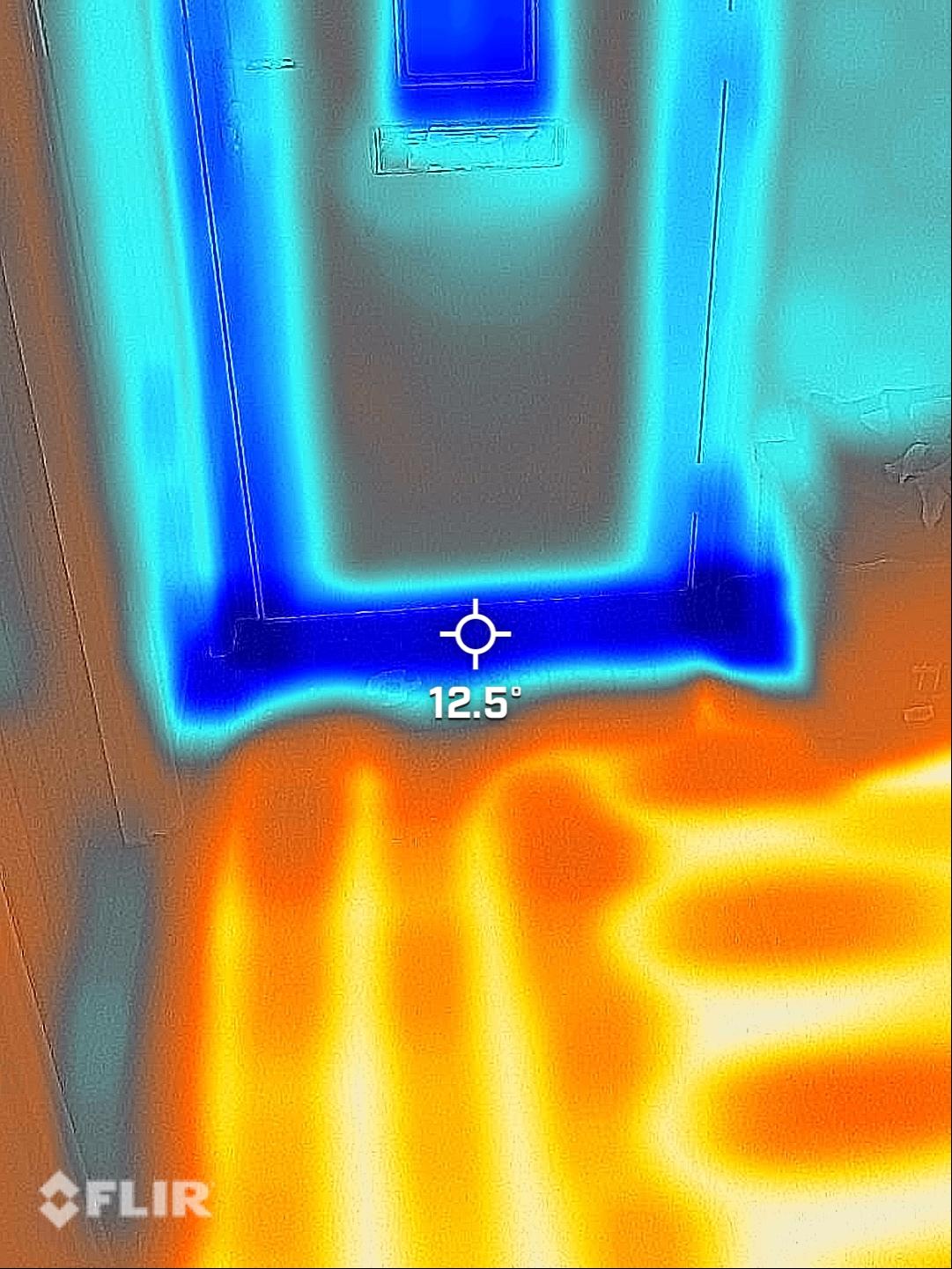

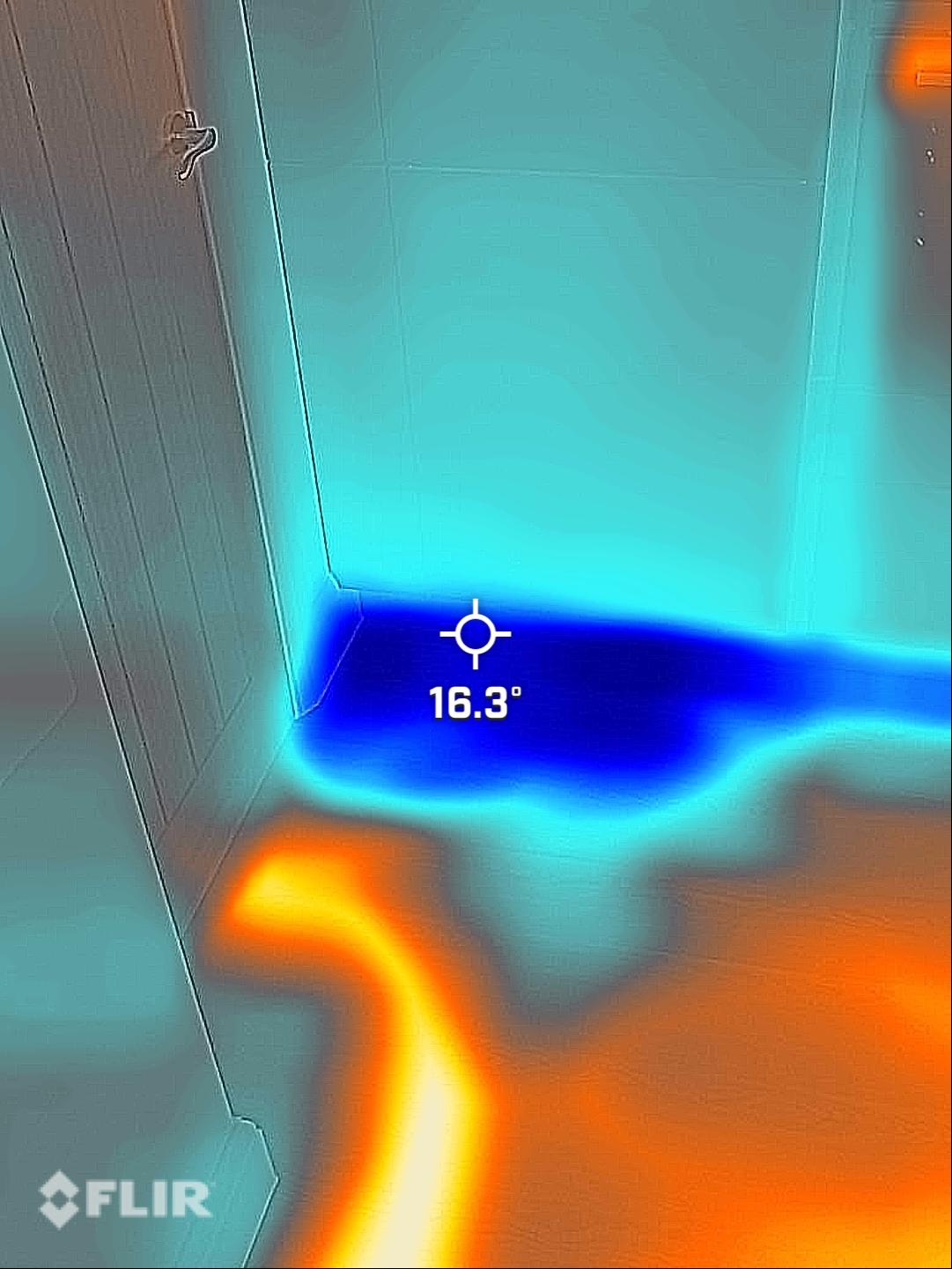

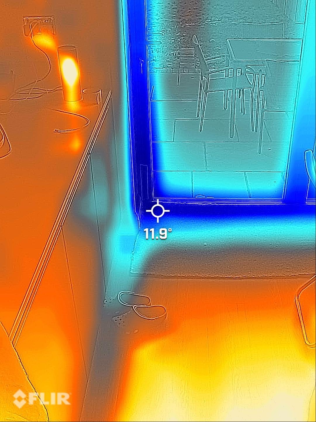

rhymecheat Posted January 13, 2022 Author Share Posted January 13, 2022 (edited) So, downstairs is currently 17.5C with 0C outside. UFH manifold is receiving 42C and returning about 30C. I’ve used the thermal camera once more and I think I see some clearer issues here. I’ve attached some pics these are under new bifold doors. I don’t really know why only the bottom is this cold Same camera is telling me the rest of the floor space is at about 22C for reference Edited January 13, 2022 by rhymecheat Link to comment Share on other sites More sharing options...

ProDave Posted January 13, 2022 Share Posted January 13, 2022 2 minutes ago, rhymecheat said: Meanwhile, do you think those low temps under the bifolds are normal? The doors don't look good. Bifolds have a reputation for being leaky and hard to make reliably air tight. But the whole frame looks cold. What make are they? Link to comment Share on other sites More sharing options...
rhymecheat Posted January 13, 2022 Author Share Posted January 13, 2022 12 minutes ago, ProDave said: The doors don't look good. Bifolds have a reputation for being leaky and hard to make reliably air tight. But the whole frame looks cold. What make are they? I’m not sure unfortunately. They’re from a local company. Owner lives a few doors down the road Link to comment Share on other sites More sharing options...
